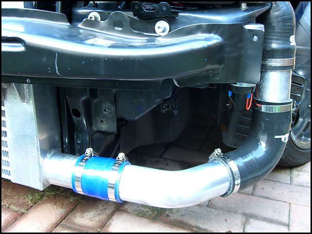

Im goin to hybrid it with bigger FMIC and pipe work and see how it goes as my Inlet & charge pipe were that hot i could'nt put my hand on it...

Part of me is thinking is it the FMIC System...As it can't Flow/Expense Air quick enought If im full spooled up at 4.1krpm and others 3.7rpm 400rpm off...Sure that is a flow problem...

Part of me is thinking is it the FMIC System...As it can't Flow/Expense Air quick enought If im full spooled up at 4.1krpm and others 3.7rpm 400rpm off...Sure that isnt a flow problem...
MBC and EBC are the same, effectively an solenoid at the end of the day, prove me wrong, but the turbo is close to max capacity as it is.....
I dont see an EBC making that much of a difference
