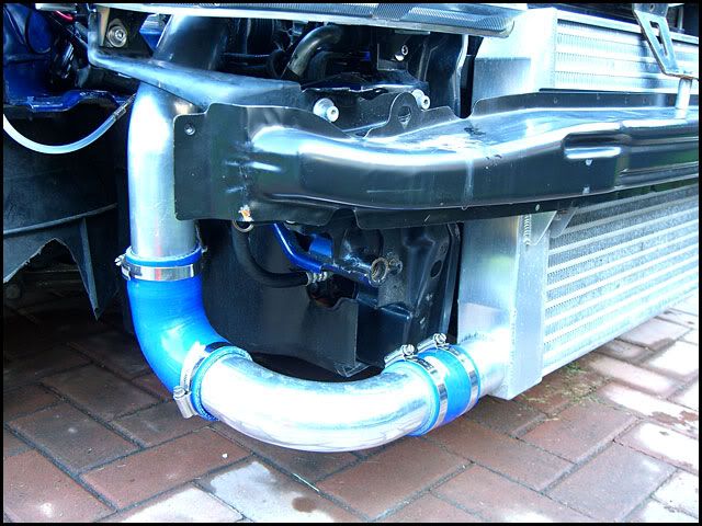

No idea m8, but I know it pulls over 180g/s though, scaled due to LC sensor in LCR housing it's around 210g/s. LCR charge pipe might be worth it, all I did was get some 2.5" pipes off ebay and create my own pipe run with silicone hoses and pipes. At the turbo end the LCR pipe is a funny size, around 67-70mm due to the daft silencer thingy.

Do you have any size ect that you sent them to make it up?as i could just get some made up...
Is that pipe work 3 pieces joined with silicone hoses..
also what inside diameter is that pipe work 63mm or 68mm?
as my mate wants to now so he can make me them up..
