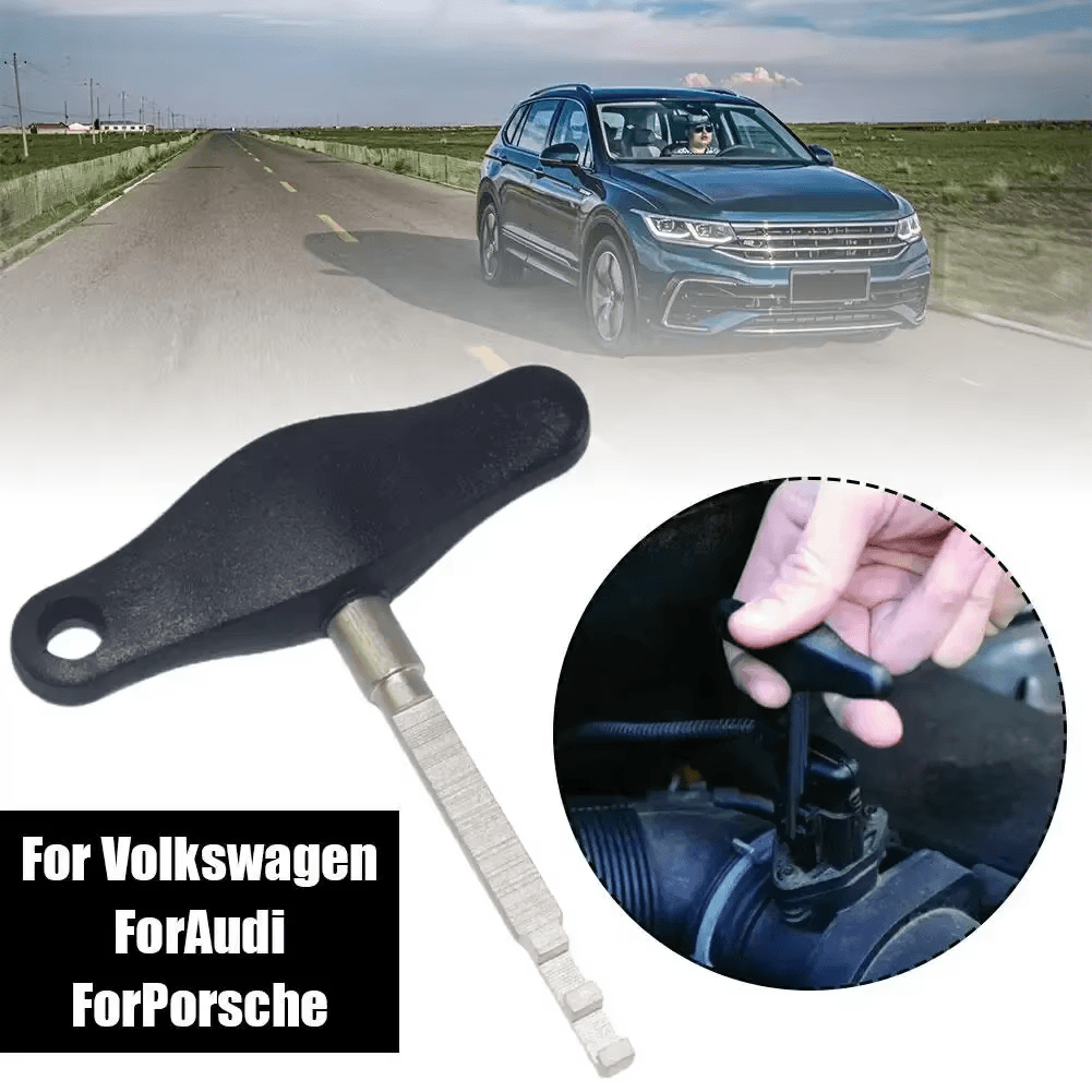

just got this tool as part as a bundle deal on alliexpress and how handy this is for some of them stiff plugs, ive tried it on one that is .. really handy to have, for £1.30
