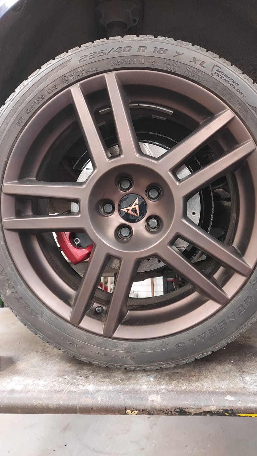

Got round to fitting rear brakes, no disc and pads, looks well lots of more little ish jobs but cars in garage so they will have to wait. Thanks @Thai-wronghorse for the information needed and for supplying the rear disc.

i notice your running 235 tyres is there a reason for this? what do people normal run i have 225 40s
No reason bud, my tyres needed replacing and my bro had these about, they fit great obviously a little extra grip due to the width had them on for a good few yrs now, but 225 is normal size but no harm at all with 235 either

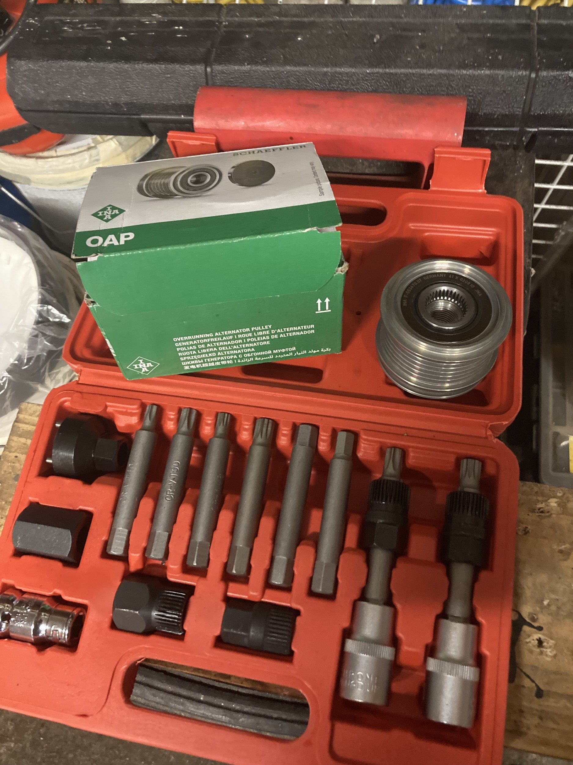

Operation pulley
Ina pulley £24.50 same as the one removing, silly price at stealers it’s still a INA but in a vw box,
Altinantor kit £15.50 (same size spines as the door lock bolts) handy kit can be used for other jobs.

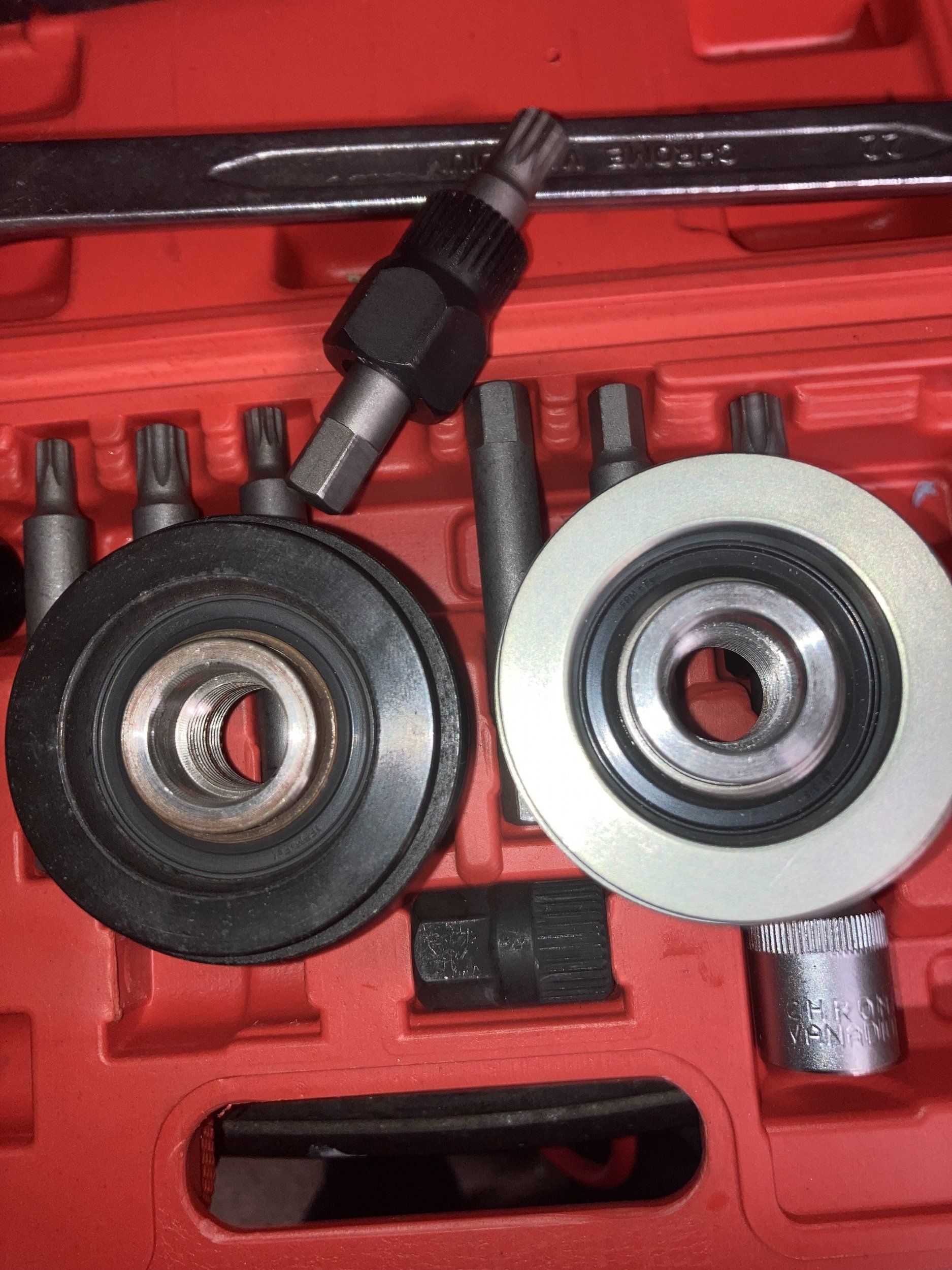

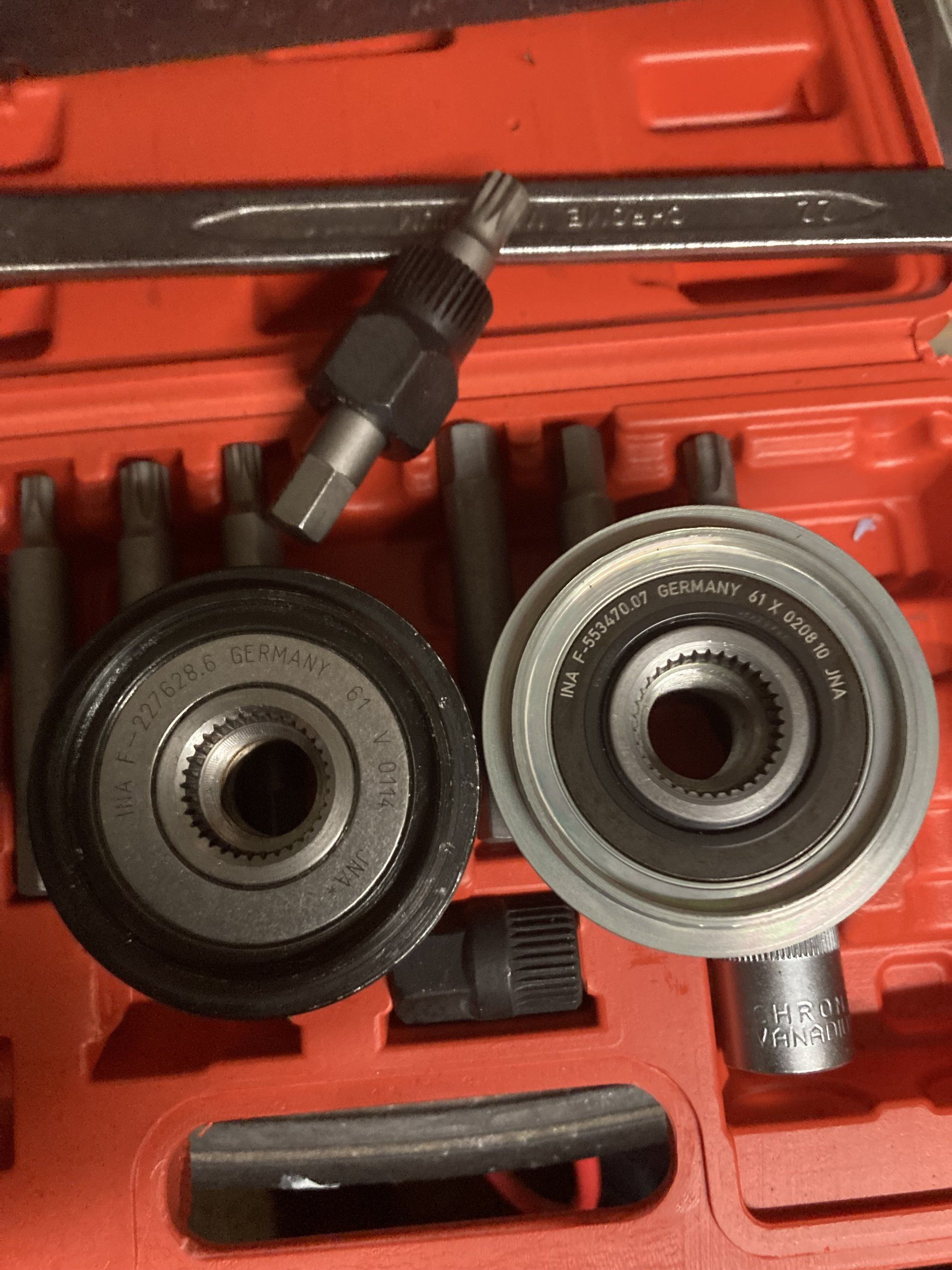

lancashire.
Left one is the old pulley, defiantly been updated somewhere down the line
