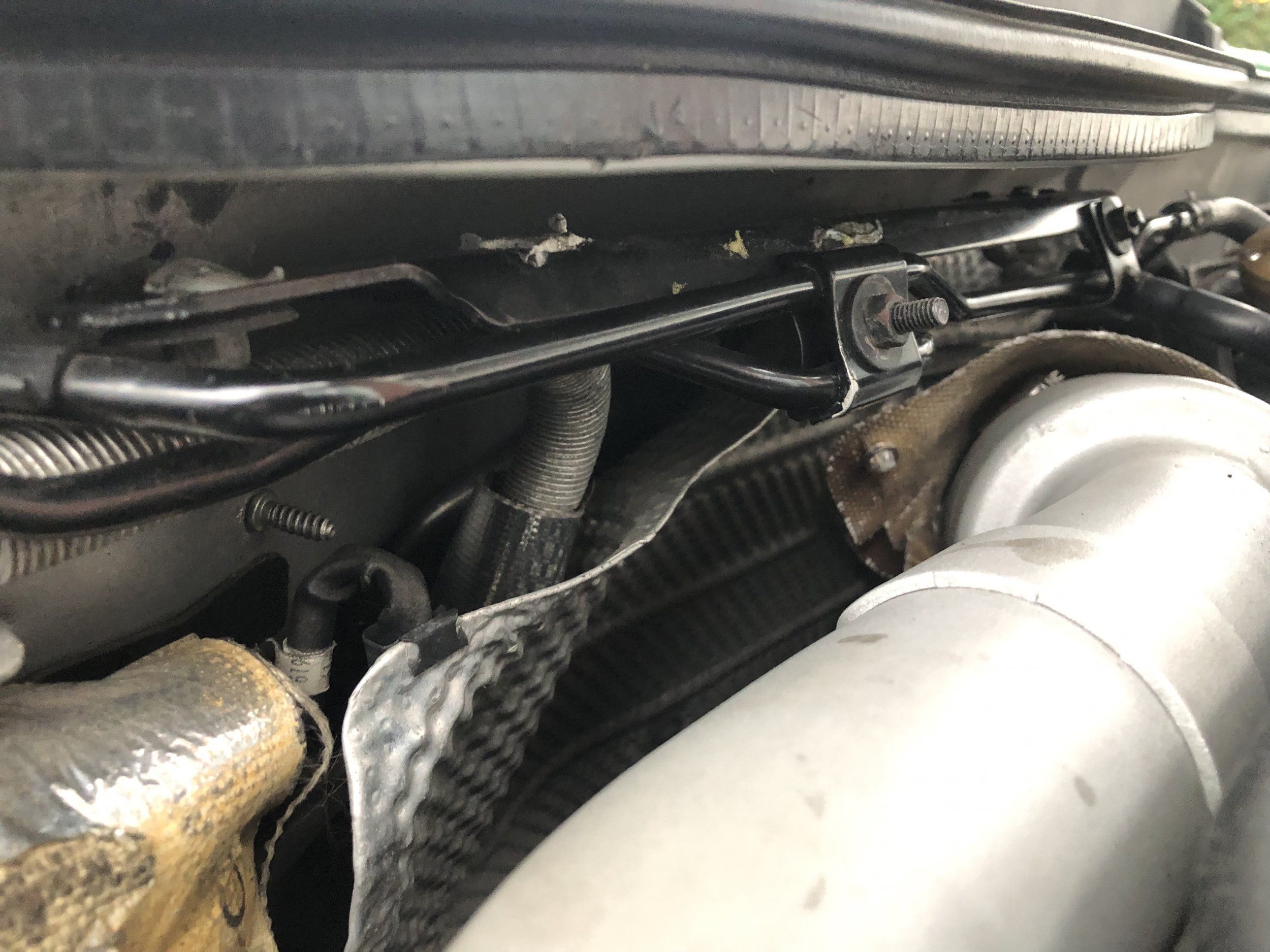

This metal bar with pipes attached has started rattling against the cowling above. Is it meant to be fixed to it because it's all loose?
