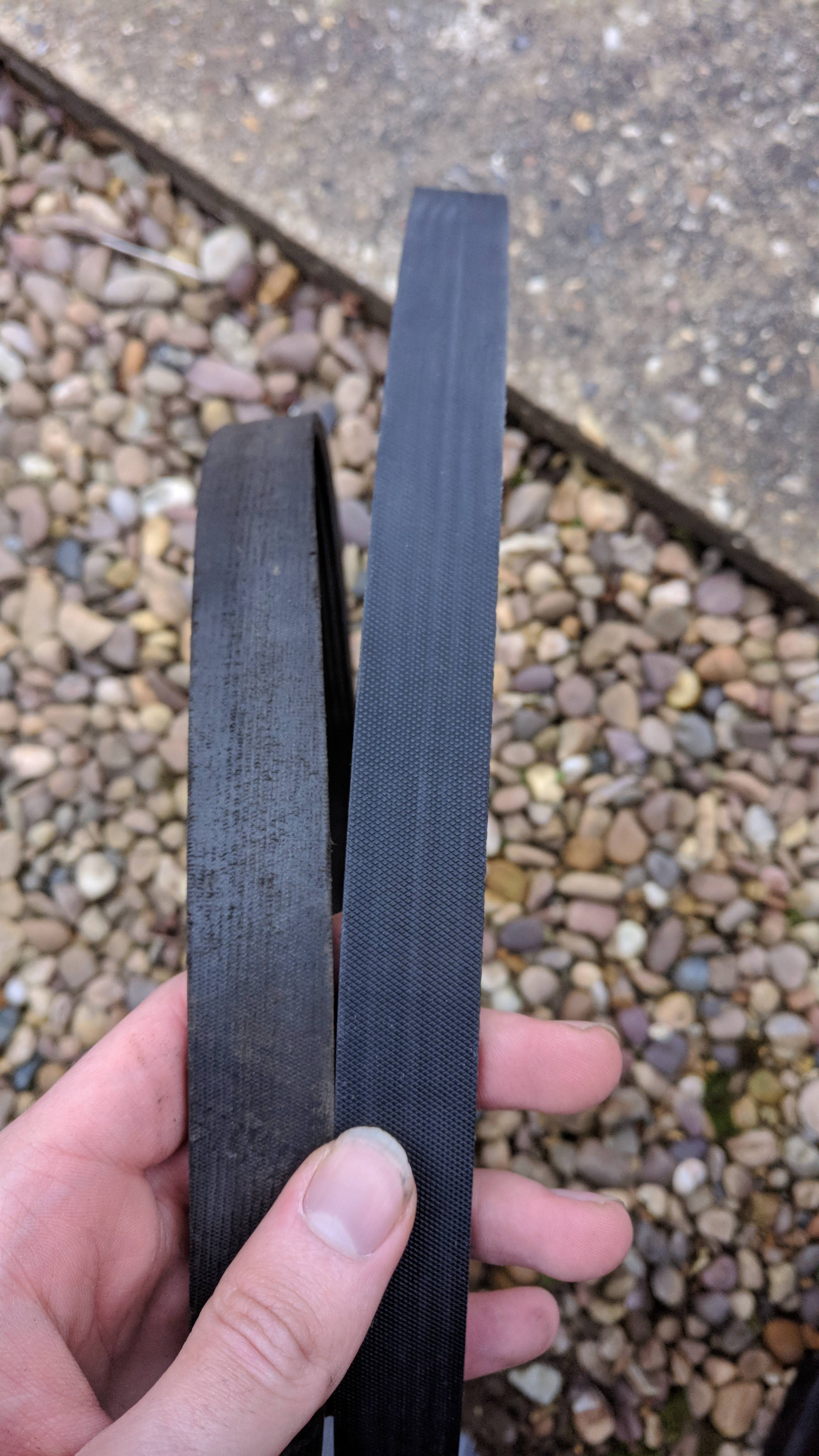

Changed my serpentine belt as there was some squealing going on and has done 80k miles.

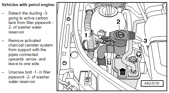

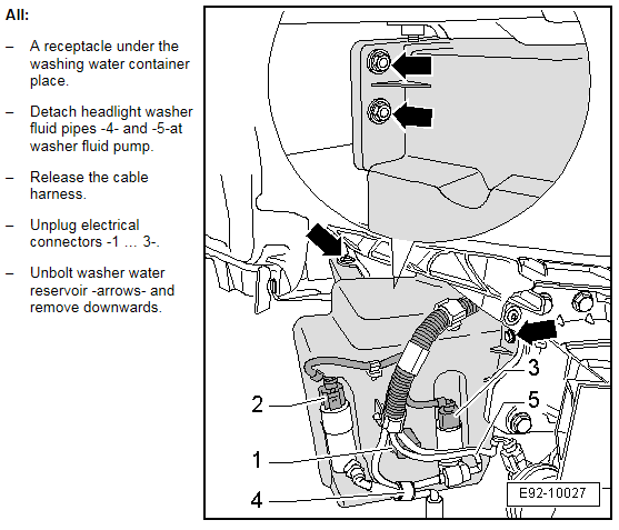

Started to check which bit is causing the problem as the washer jets front and rear have stopped working :censored:
Looking like its the pump i guess, trying to check online how easy to change myself but not finding much to go on. I know the bottle is behind the drivers fog so will take it out to have a look.
This is how to remove reservoir but you get the idea.
Remove front right mudguard
Remove front right headlight
