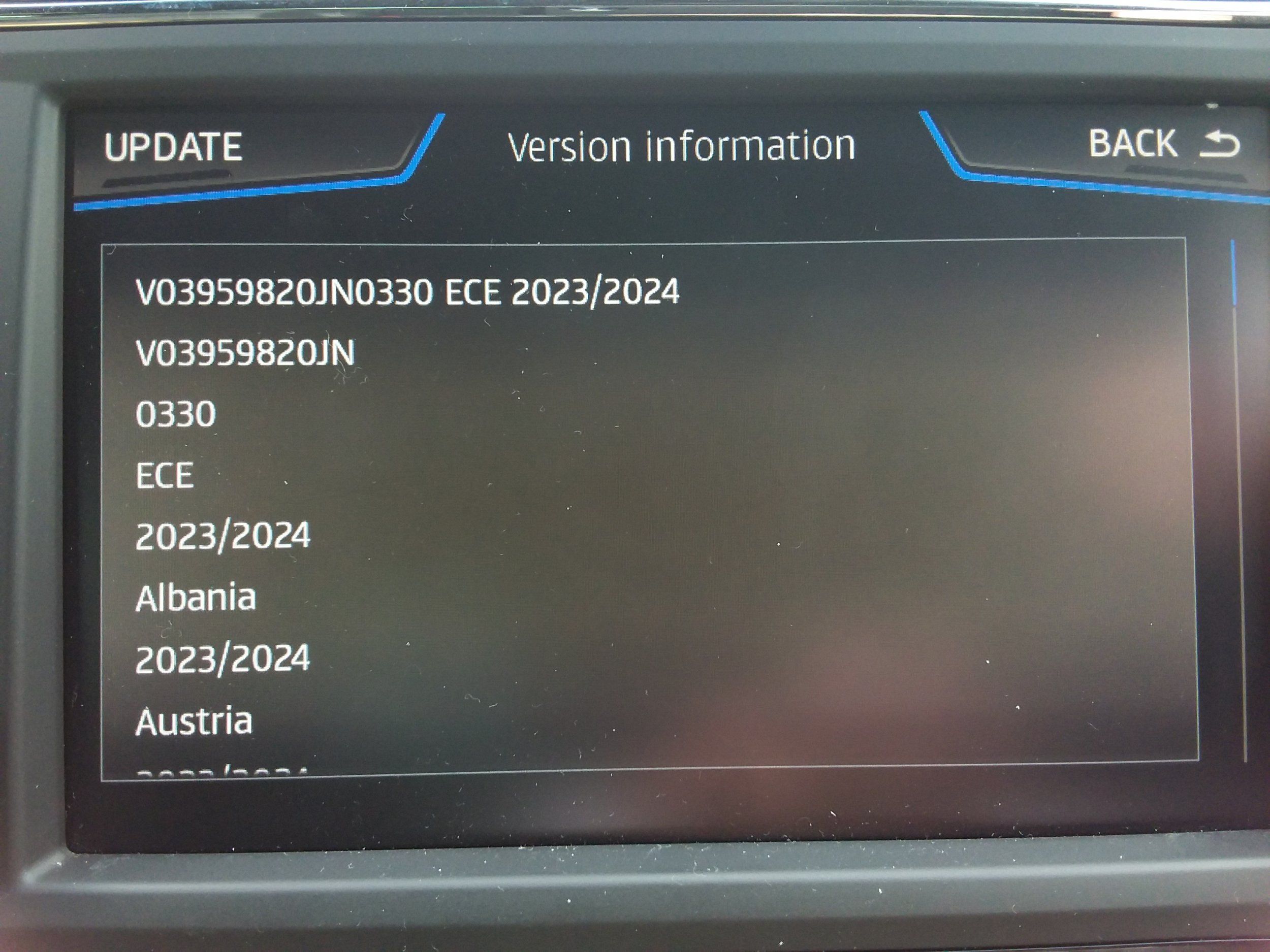

It's that time of year again. The mib2 high maps for 2023-2024 are now available aka June 2023. Thanks to the world of map file sniffers. These have appeared on the Briskoda site thanks to MartiniB. The new release code is 330 replaces 310.
You do need the navigation FeCs for it. See the resource for information on that:
Mac instructions apply, if you got one, Keka and CleanMyDrive. PC use 7 zip. Well they still fit on a 32gb Sandsk Exteme card. Tried that. Other 32GB SD card may not. If not invest in a 64gb or use a USB of a bigger capacity. ExFat should be used on bigger cards, Fat on 32gb cards, NTFS on USB (the latter I recall, havent tested, use SD myself). People mistakenly format their 32gb SD card to NTFS and definitely wont fit if you do that. NTFS is also slower than ExFat on SD cards. Did some timing. For standard navigation cards never format them, just delete what's on them 💡.
The links:

Loaded fine:

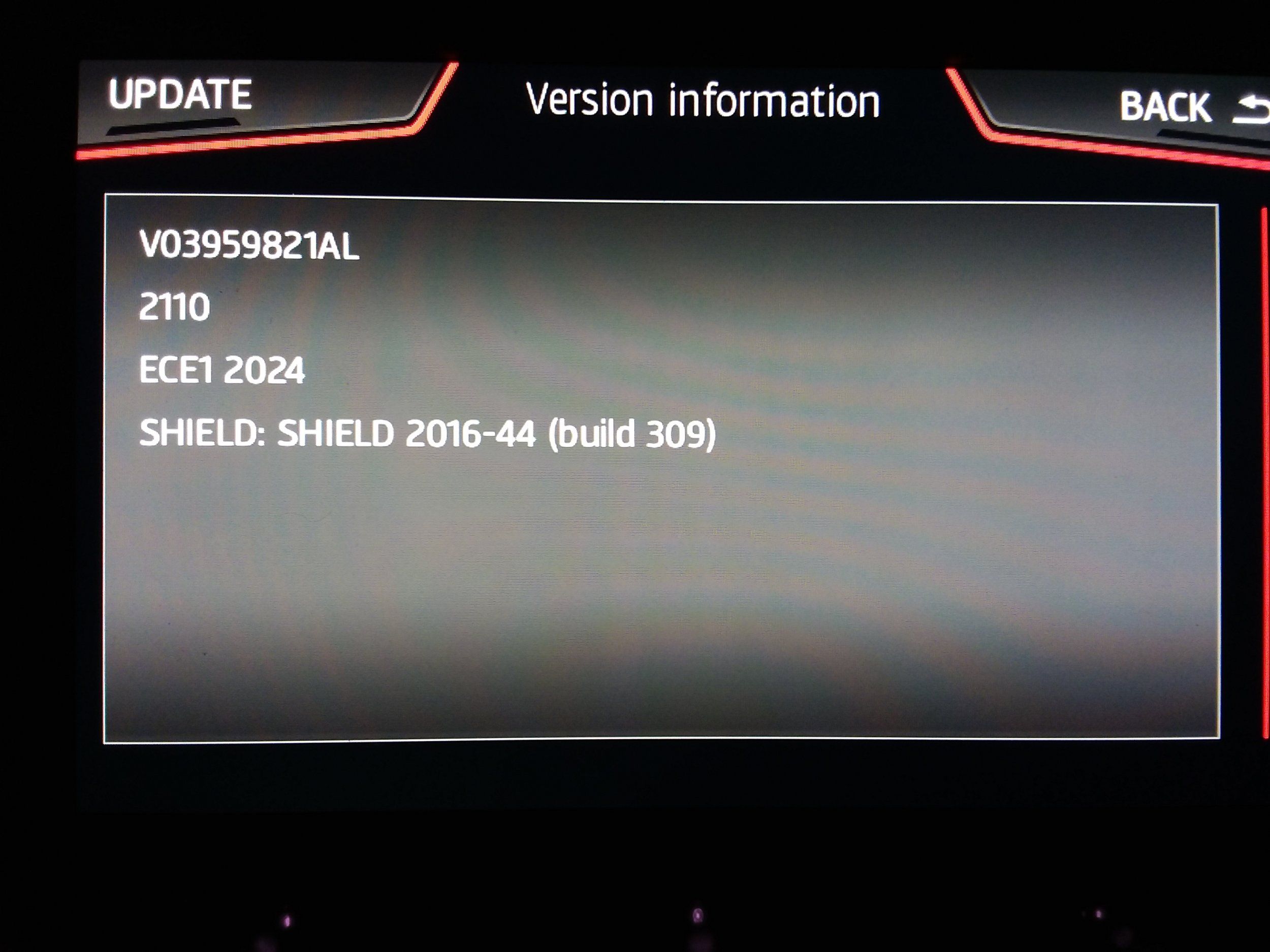

June 2023 has come early for Mib2 standard, thanks to MartiniB again - straight cut and paste from Briskoda. Don't forget the overall.nds trick. Normal workaround. You need it for Seats. nb. Mr Fix doesn't mention that 😉.
Link in the resource section below. Normal drill for those that know. Advised not to format the SD original SD card that has been known to cause issues, just the card. Just delete what is on it, don't treat it like a floppy disk or hard drive. The abridged version follow steps 1-12 from here:
How you know whether it's a mib2 standard or high is in the link (map on SD and 6P in the text it's a standarc).
Latest release 2110 is the June 2023 release files, see codes to the zones in the next post:

Normal success photo:
