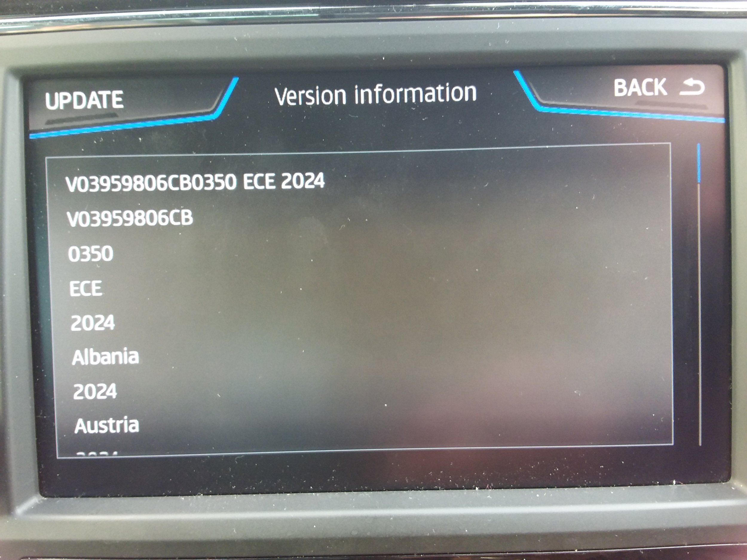

Ok mib2 high Europe and the Rest of the World (RoW) map are out. ECE 2024 November 2023. See note at the bottom and link for people that want to to use the June 2024 ECE 2024-2025 file that appeared February 2024. Early release but probably the final.
Europe
The November 2023 release is out now via an early release which is most probably the final release given the files are saved as April 2023 which is the normal lag in production, testing etc. It's believed they are from Audi servers republished on enthusiast mib2 boards. You need the life long FeC as always for mib2 high.
Given the release is SLA1 signed it hasn't been fiddled. You check the signature bank so if no code is below it, it's 100% original.
Release 350.

Mib2 high only early release if that takes your fancy (14gb rather than 32gb of the combined mib1/mib2 high release). Might be best to use Chrome and poke it if the download needs restarting.
Mega.nz(copy from Audi portal)
https://mega.nz/file/D7gRnTQS#bs1ghZILdz3-DOJ2Vafc9aePn_l9SDbRTJ8jyPslBO4
Any of these files can be used. Although there appear to be teething issues with Skoda so best to use the gold standard VW link.
All the normal warning about using Macs and the need to use CleanMyDrive apply if you do. Its that crafty signature seals the integrity of the download. Macs put extraneous character in which cause the verification to fail.

Currently, as of 26th November, the Mib2 high link file for Europe works and is fine. The Skoda link for the RoW unzips OK and probably is fine - haven't tested it - need to be out there. On Seats you need the life long FeC to use these - see resource. Audi is the same. Skoda and VW come with the life long FeCs pre installed. The Skoda Mib1/mib2 high file now unzips - haven't tested that one.
