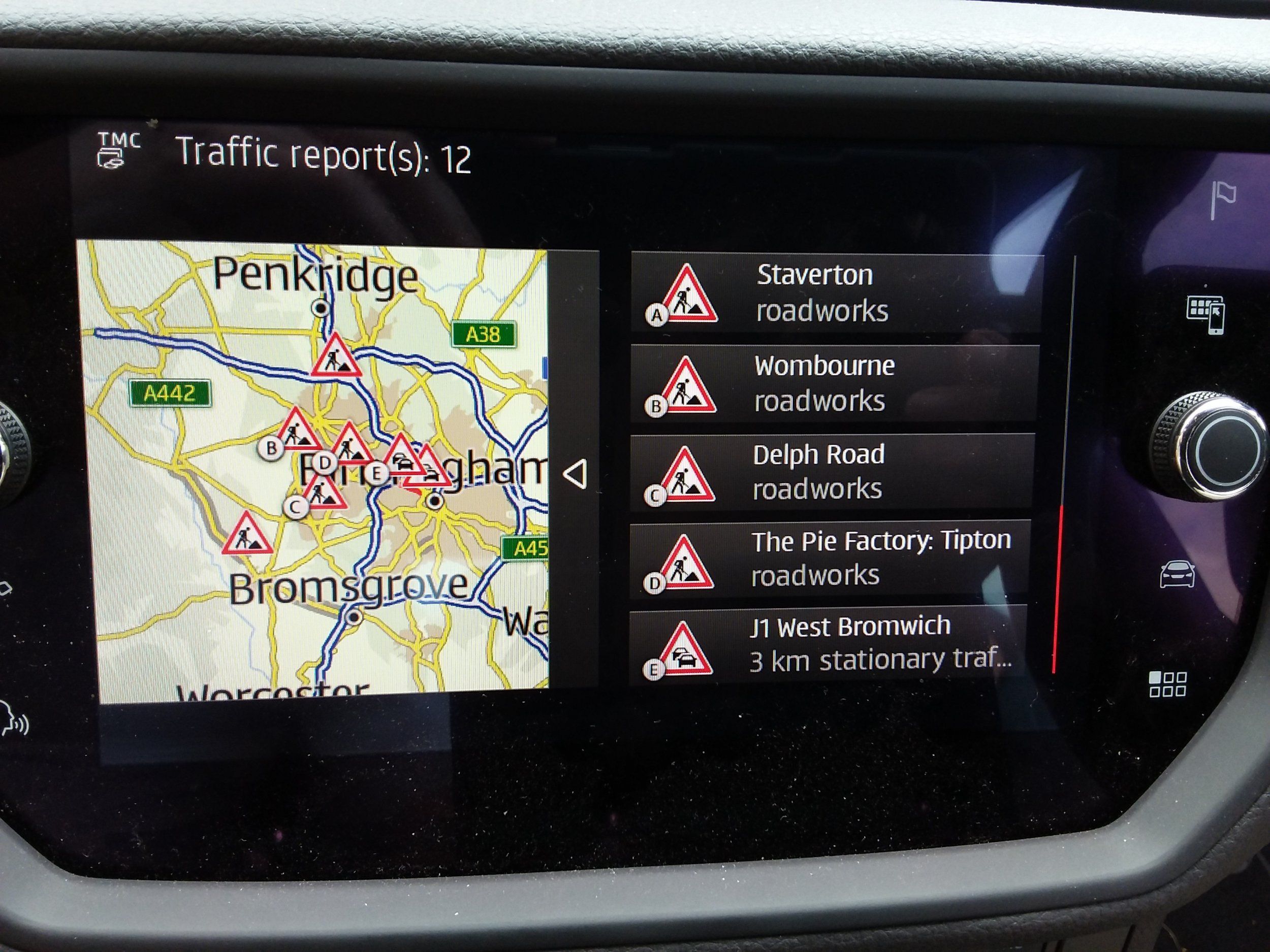

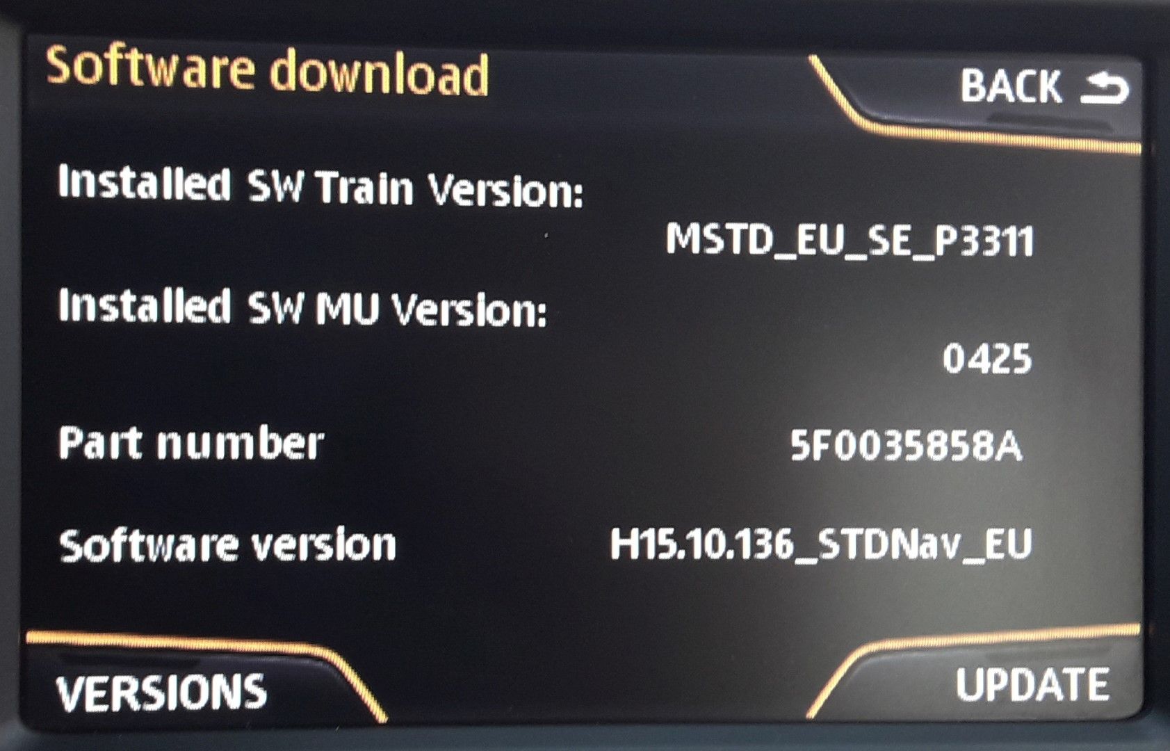

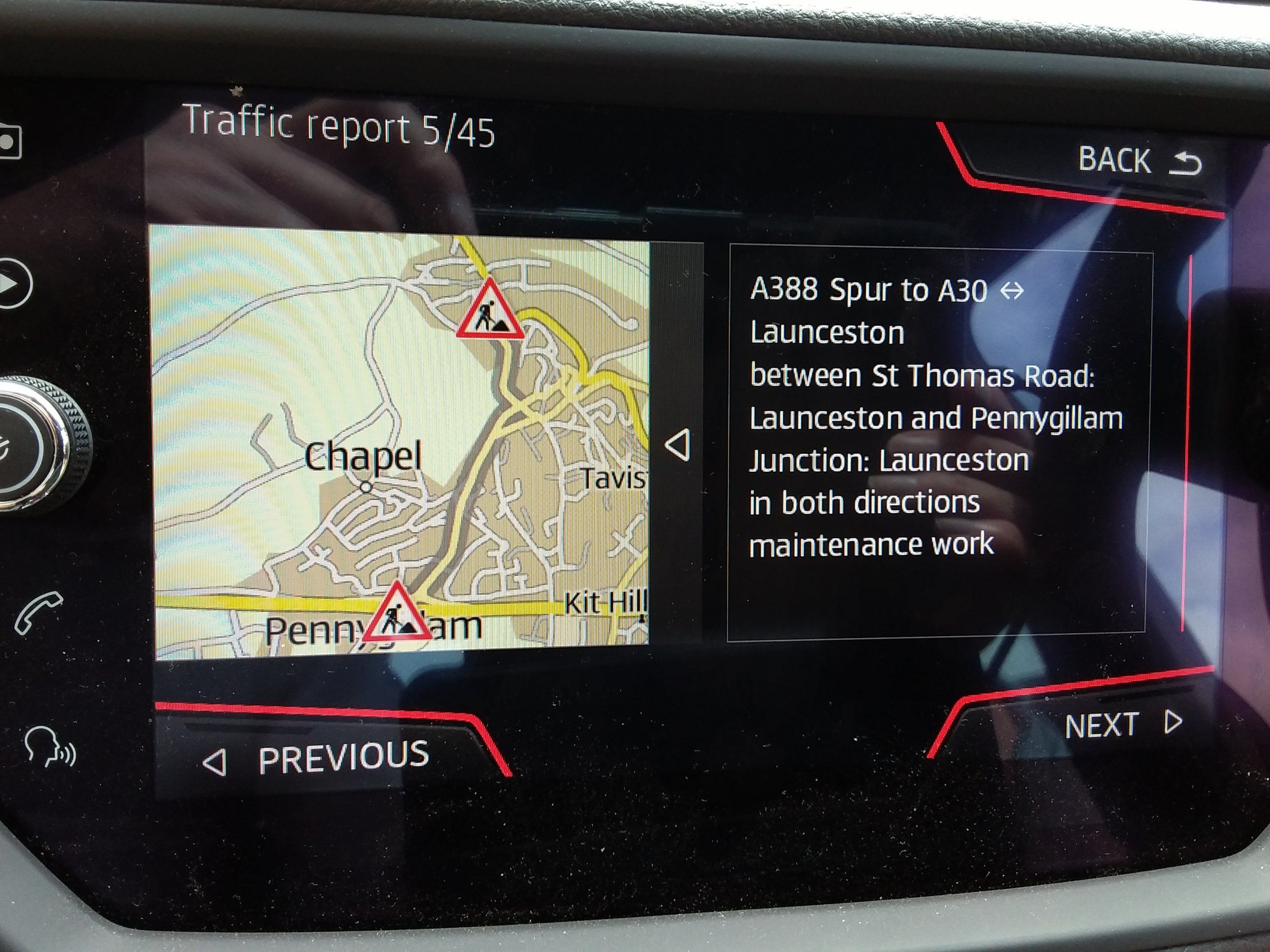

UK TMC Trafficmaster RDS Service Ceased in April 2023 - MIB2 Standard Only Fix (MIB2STD 2020 Maps with TMC Update for Amundsen/Discover Media/Technisat)
For mib2 standard there is a fix worked out by two posters on the Briskoda board (Bigade1 and PCBBC) based on what Australian's did to get their TMC working with VAG cars. This works across Mib2 standard units excluding Delphi. Delphi units were only fitted to VW and Audi, not Seat or Skoda.
To determine whether it's a Technisat (the one it works with) if it starts with MST2 and ends with T, MST2_EU_??_XX_XXXXT its a Technisat and the solution works. When TomTom took over the cartography above V12, the support for Inrix TMC which is the one to use after Trafficmaster was removed.
The solution for the Mib2 standard breaks into two.
a. If you have VCDS / Obdeleven Pro coding device and want TMC to work across as many European providers as possible plus the UK Inrix service then change the TMC fee based code to 1023 via coding and use the module in the zip files: DiscoverMedia2_EU_AS_1430_V12_TMC_Update.7z
b. If you don't have VCDS / Obdeleven Pro coding device and want TMC to work in the UK with Inrix service but aren't so bothered about all Europe TMC providers use the module: DiscoverMedia2_EU_AS_1430_V12_TMC_Update_V2.7z This option assumes the current TMC fee based setting is set to 15. Default.
In both instances, you need the V12 map:
Unmodifed V12 map download: DiscoverMedia2_EU_AS_1430_V12.7z
Nb. the map file is held on Mega due to the way Mega works if you don't pay for higher speed you just let it run over 24 hours or so, use Chrome for this. It restarts the download from where it got to.
Instructions:
1. Download both 7z files as applicable.
2. Unzip unmodified V12 maps to SD card. Instead of downloading, you can use your existing copy of V12 maps if you already have a copy.
3. Unzip the TMC Update to the same SD card, replacing any duplicate files.

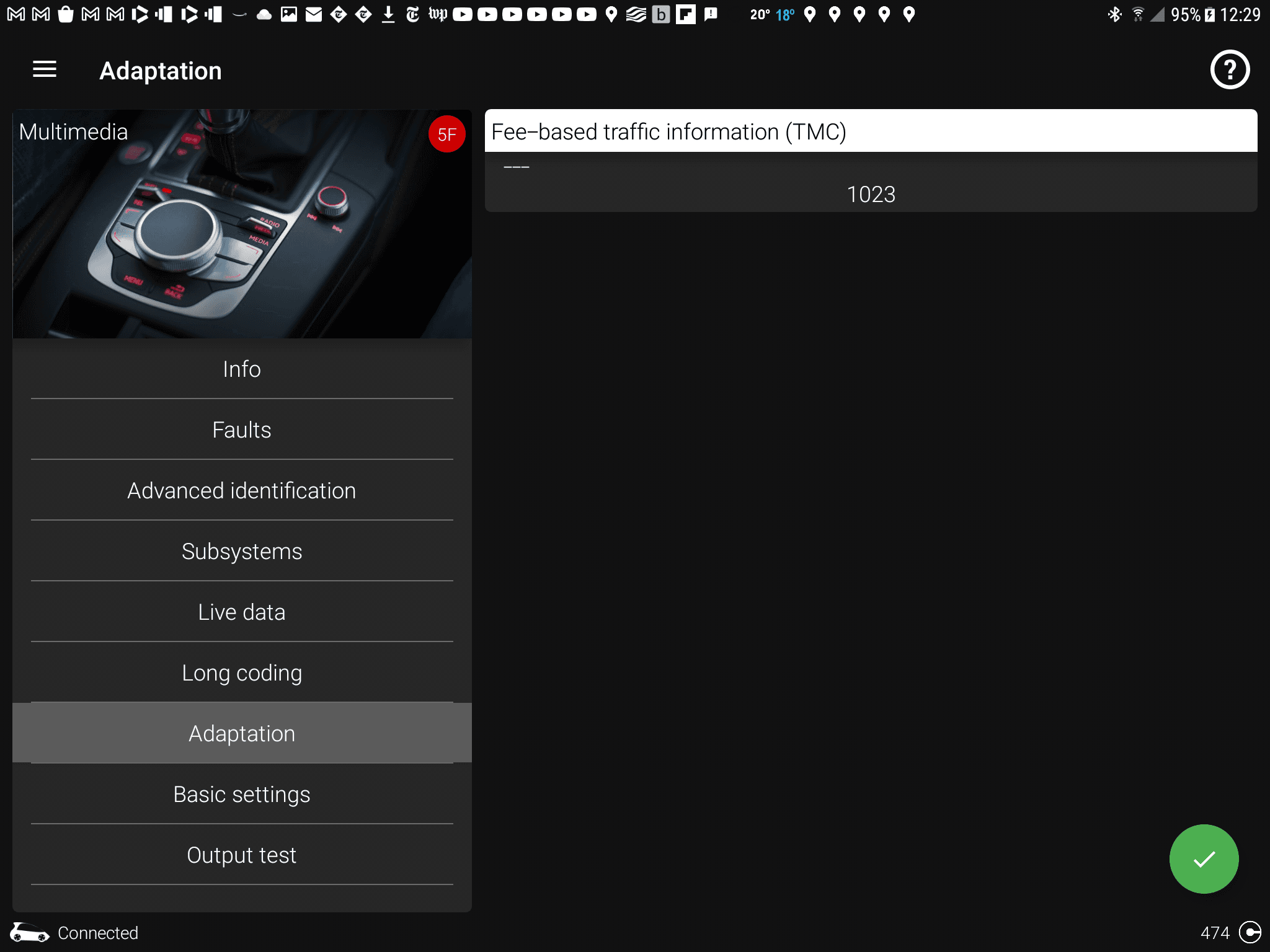

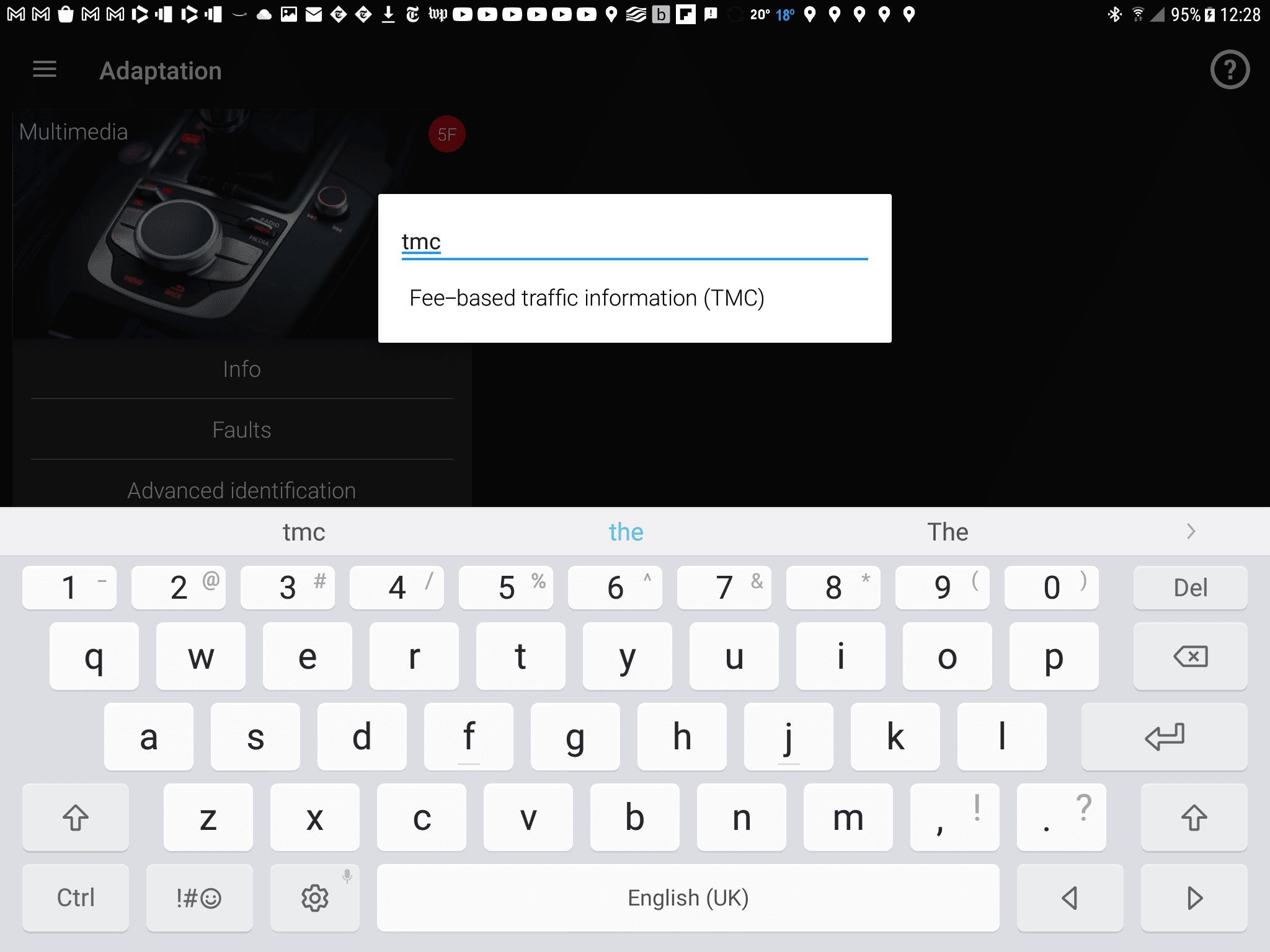

4. This step is optional if on a. Configure FEE BASED TRAFFIC INFO is set to 1023 using VCDS/OBD11. If b. ignore the step.
Example in Obdeleven, 5f unit, Adaptations, search under TMC:
Change to 1023, save and reboot the unit:
You need the two zip files covered in the steps above. Maps for the year circa release 2020 plus the adapted modules that you overwrite in the area which make it work (step 3 above).
On a Seat you must do the workaround process on the SD card after step 3 above if your original maps were prior to release v12:
The workaround for that is the standard one:
Steps:
  1. Download the latest standard MIB2 maps
  2. on the infotainment go to settings, safely remove, sd1 card
  3. remove sd1 card from glove box slot
  4. long press on the on / off to reboot it a couple of times
  5. insert sd card in to computer
  6. copy and paste all contents to a directory on your computer
  7. Format the SD card keep it as fat32 and leave format settings as default in file explorer (don't forget to push the card lock mechanism to off) (ditto in a MAC or delete all from the SD card)
  8. Copy the new downloaded map version to the SD card (after unzipping it)
  9. Replace /maps/EEC/EEC_WLD/OVERALL.NDS on the SD CARD with the one from the original SD card
  10. eject the sd card (on a MAC run CleanMyDrive on the SD card - then eject)
  11. Inserted the card into the card 1 slot in glove box whilst infotainment is off
  12. power on and go to navigation
Always back up the SD card before doing anything.
Example results with it working:

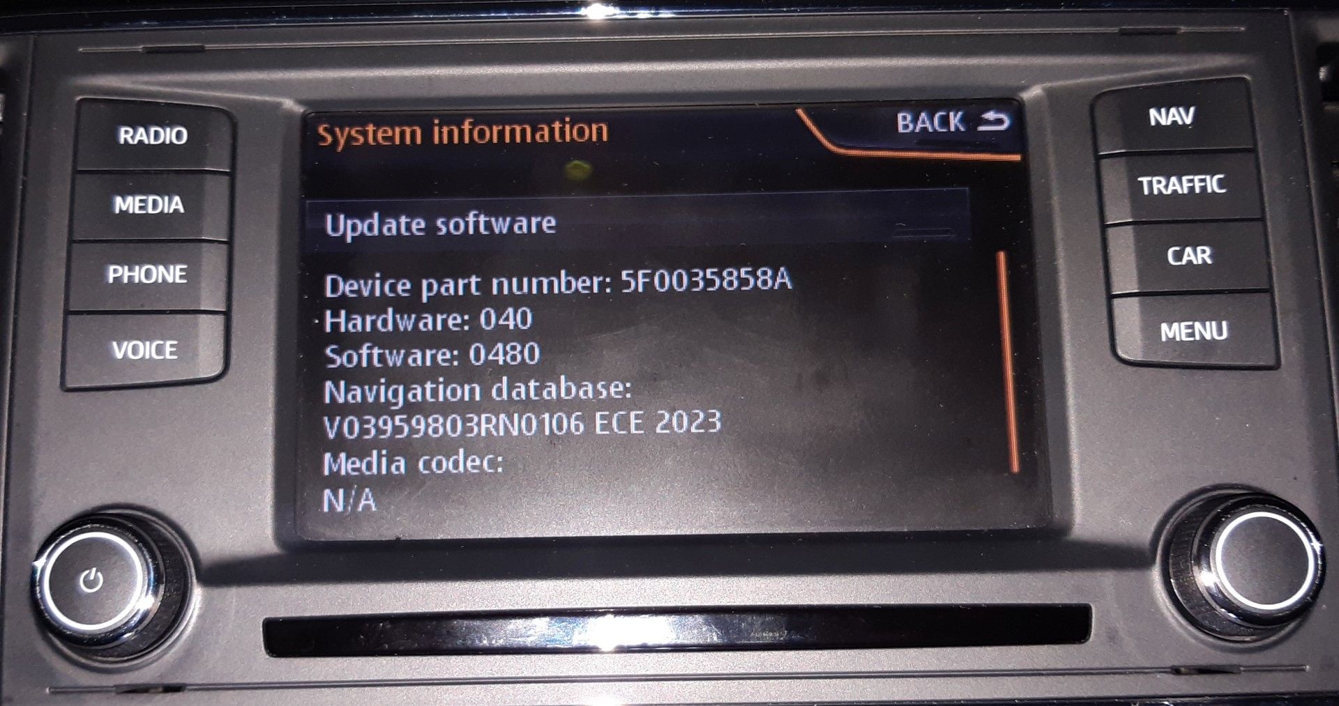

Interesting one for mib1. Presumably the SD card based one.

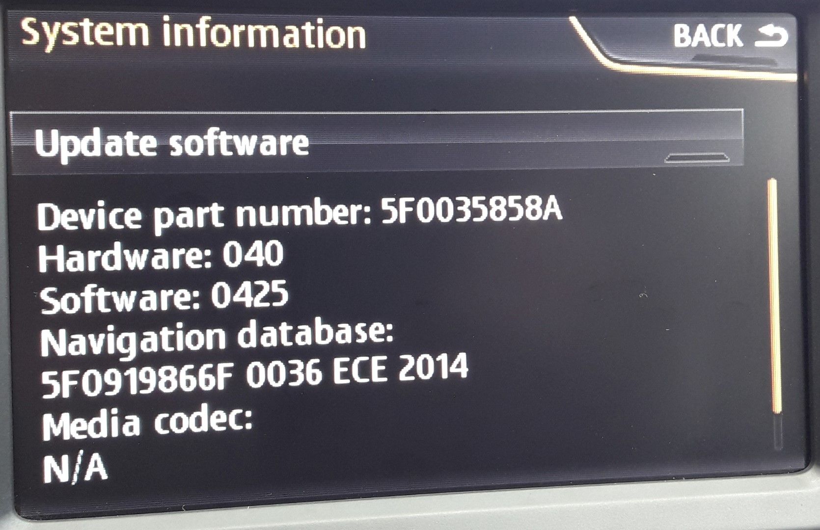

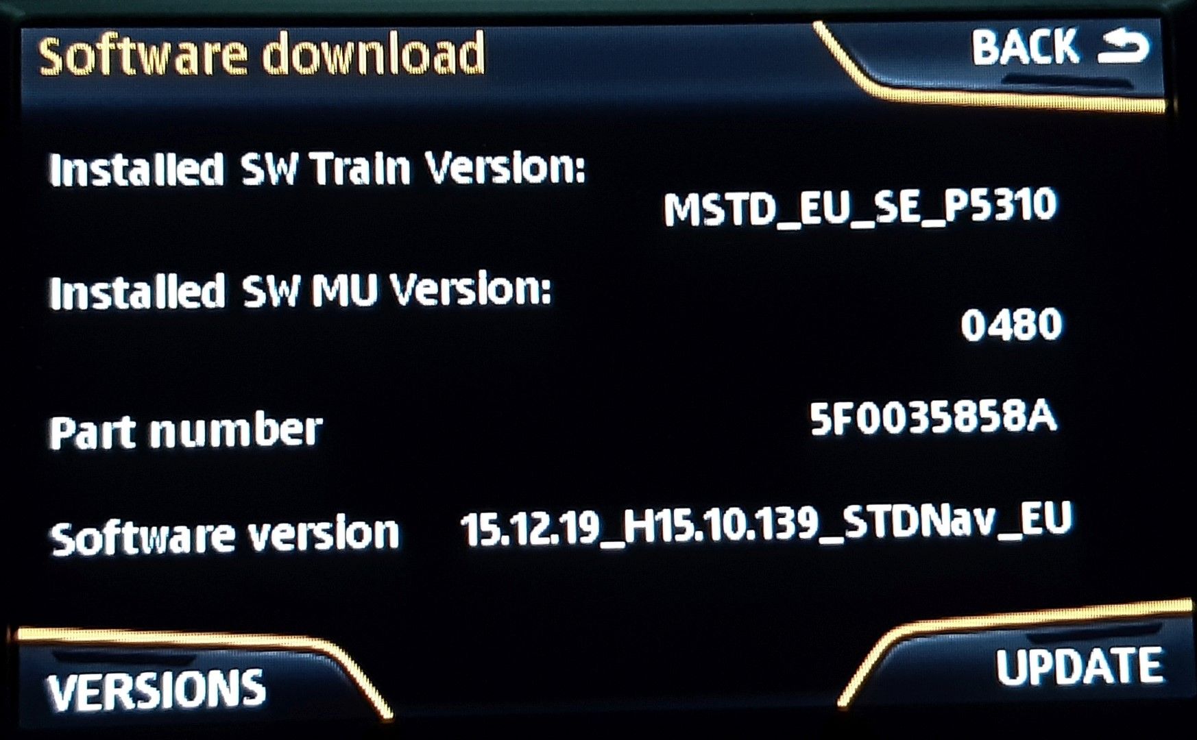

I managed to update our MIB1 Standard from 2014 maps to 2023 :cool: I found some info on a German forum. Here's what I did:
You might need to update your MIB1 to the latest firmware for it to work, I did it a couple of years ago. mib1_5F_480.rar [1.95 GB] (Spanish forum? I still have a Mega URL).
Backup original map SD to PC. [SEAT Navigation AT Europe (V4) 5F0.919.866.F] [4.46GB used of 7.48 GB]
Delete files on SD, probably best not to format it.
Download new map files, unzip on computer. P106_N60S3MIBS2_EU_NT (8V0060866S).7z [6.54 GB, 7.53GB EXPANDED ON PC] (mibsolution.one > Maps > MSTD)
Remove some files so it fits your SD, more than you expect due to cluster size? (Turkey, Ukraine etc). I ran out whilst copying, but I freed up 400 MB (just in case being completely full breaks the Sat Nav).
Change the following in the new DBInfo.txt (I didn't test if you could skip this step):
PartNumber1="V03959803RQ"
PartNumber="V03959803RQ"
TO
PartNumber1="V03959803RN"
PartNumber="V03959803RN"
Copy all to original SD.
Technical explanation here:

On the card size @Daz3d you could use one of the 16GB SD ebay VAG map cards with a reliable score if you didn't want to hack it down to size. People did find all VAG cards were interchangeable between mib1 and mib2 across brands. The CID was recognized as been valid on either unit.
Have you tried updating the TMC from 15 to 14. Skoda people seemed to find it worked but I wasn't totally sure they were mib1 standard users or mib1 high. Suspect it may work. Think the movement to TomTom maps was for mib2 standard whilst mib1 remained on HereMaps so that update is probably a HereMaps one. The Mib2 standard you have to downgrade and do the file tinkering, whilst Mib2 high is just the VCDS / Obdeleven simple coding with a reboot.
You'd follow this one as if mib2 high
Let us know.
As for the source of that map I was intrigued when it was being put about for retrofitter sale. Suspect it's from Audi servers that have updated maps still being produced, this is where we are hoping the mib2 high ones will go on beyond the 5 year cut off. This year I used the Audi update that came out early via that Russian site. They are streamed in mib1 high only, mib2 high only and both which is the normal Seat / Skoda / VW download. Normally you don't get to see these files since they are behind a VIN registration.
On the parts number edit if like mib2 standard that's just a display thing you didn't need to edit it for mib2 standard. Probably the same people were editing those part numbers when they just needed to move that overall.nds file but of course in mib1 standard it may look at them, why people were editing them but didn't need to in the mib2 standard. Reading the link you gave yes you do need to edit the part code for mib1 as you did !. (evidently part of the history of why people needlessly did it on mib2).
Looks like you do need that firmware update as well which you did. This might be the root reason why all those years back some people could do the update and others couldn't on mib1. We never got down to the bottom of that one. They were spending their money on buying the maps and it never worked. 50% got into work, 50% didn't. This right back in the early days of the thread.
Good find (y).
Reactions: Daz3d
