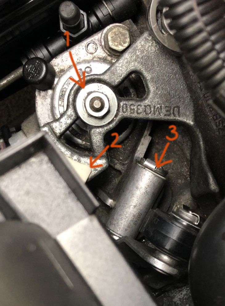

Got the lithium grease out and applied it to the gear linkage. A lot smoother now.
Apply to the shaft (1) and push it up and down a few times.
Also remove the clip at (3) and blast it into the cylinder.
I did that a couple of years ago, but have noticed recently that my shifts still feel pretty notchy. Starting to think about changing transmission fluid, as it's never been changed...
