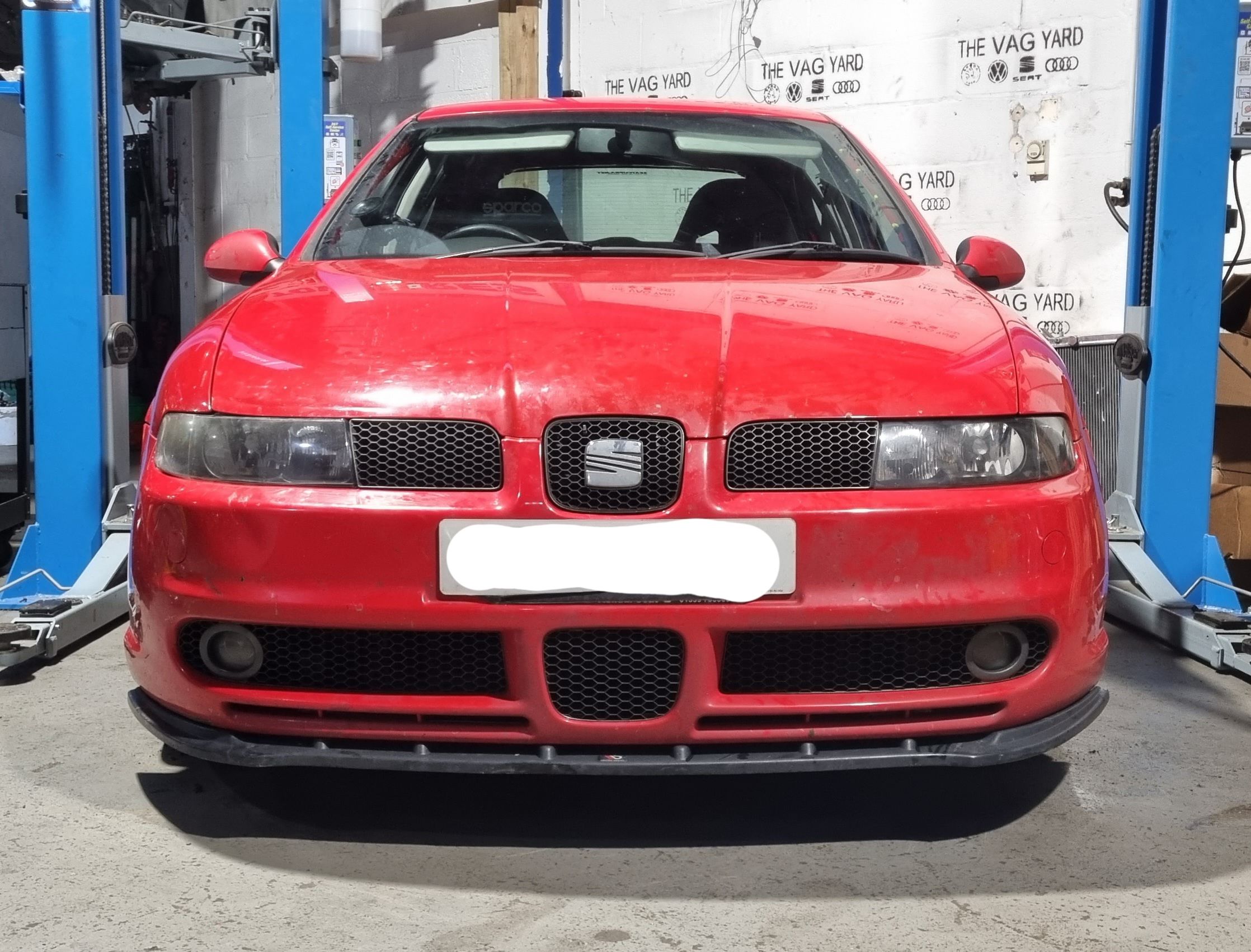

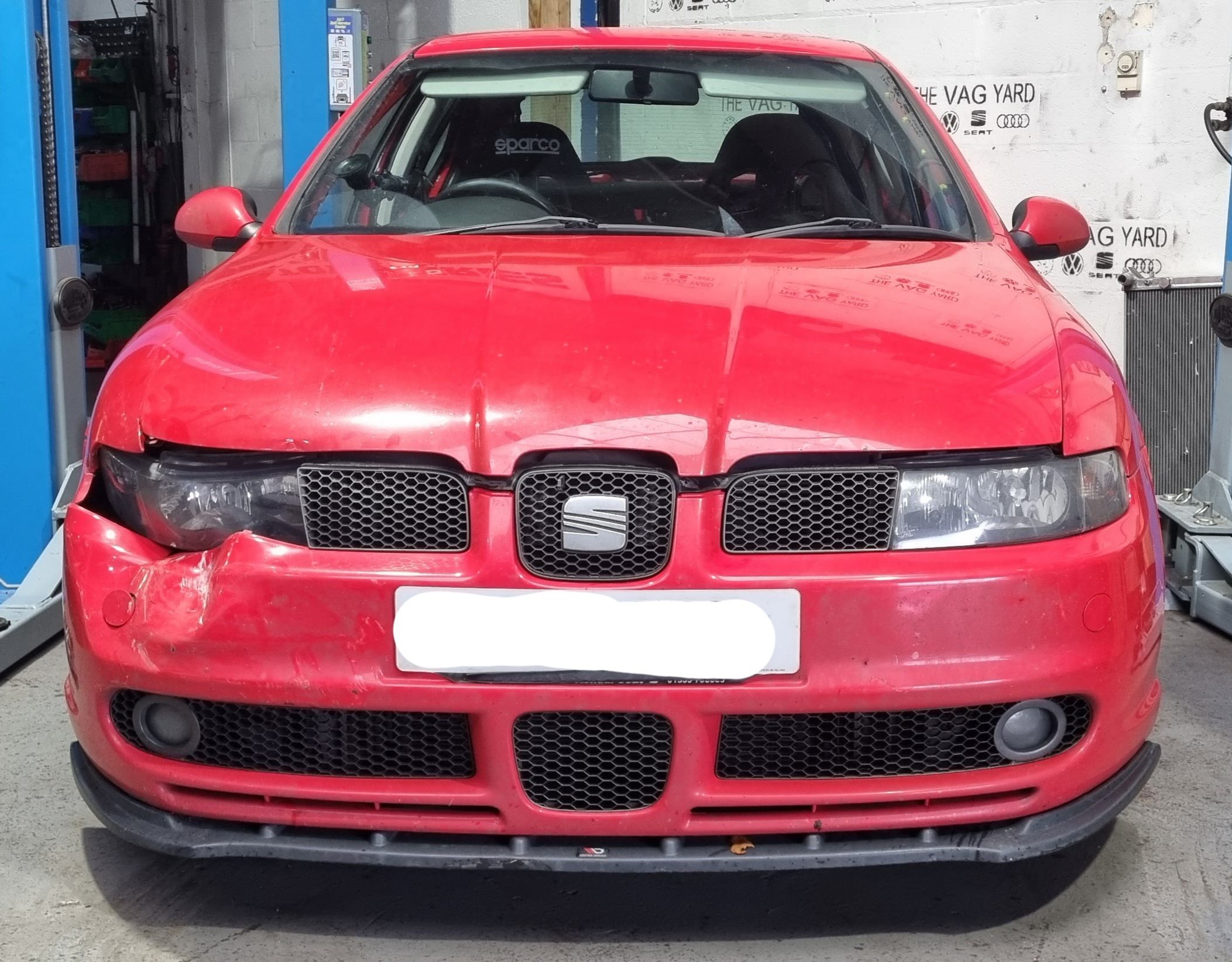

This weekend... did not go as planned
Sad Leon face.
That's what happens when someone goes for a gap, you go for the next gap only to find out the driver in front bailed on their gap and decided to wait for the gap after yours.
But, a quickish visit to The VAG Yard and
I dunno what other people think of Aaron but he did me a real solid on this one. It was never going to be good as new but it looks way better than it did. Really happy with the result.
Now I just get to wait to see how bad the fallout will be on the insurance (eventually)
Sad Leon face.
I'd say Aaron has done an awesome job, even the bonnet is sitting tight & tidy. Glad you've saved it's face 👍👋
Good luck with the insurance 😬

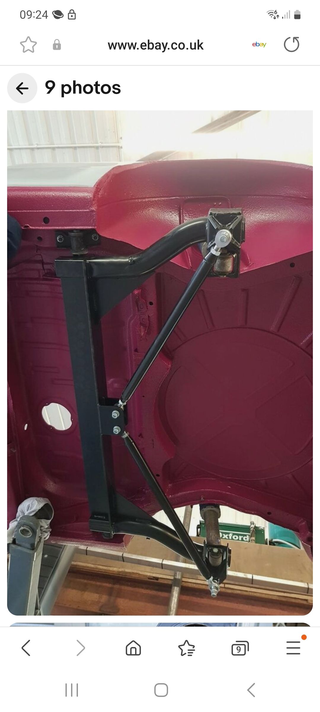

Right, to add a little bit of positivity cuz something good should come out of 2023, the results of my (not so extensive) research.
Digging about on Autodoc I saw that the wheel hubs from the Mk1 and Mk3 Leon (sub 120bhp version as they run a beam axle) have the same internal diameter. Could it really it be that easy? So, I bought a used rear stub axle and took the hub off. Does it fit on the Mk1 Leon stub? Yes... and no. It does physically fit but the ABS sensor is too far forward so no go.
Then I looked at the Mk3 stub and thought "I could always do an adapter plate, sort of like PCD changing spacers". So I offered up the Mk3 stub to the Mk1 axle...
It only bloody well bolts up as is!
This means if you want to run 5x112 without ABS or the fun of adapters, bolt on a Mk3 Leon (or others) stub axle and you're a good way there (there's brakes to line up etc but such is life).
Now, I do want to keep the ABS cuz it's a technical challenge so an adapter plate will be necessary as the Mk1 Leon has the sensor on the stub axle but the Mk3 doesn't.
The conversion probably won't be done till this time next year but it is progressing
