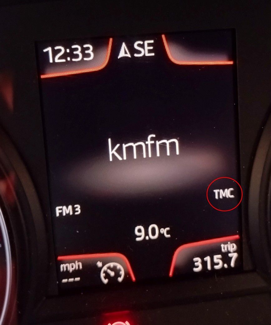

A few things to check. First make sure you have good reception of Classic FM on FM (not DAB). Next change the display in the binnacle to the Audio display. TMC should appear on the lower right side of the display after 1-2 minutes. That shows that the system is receiving TMC data which can only be from Classic FM now. If TMC does not appear, check you have successfully coded 14 for the TMC setting. If that is OK and TMC still does not appear, check that Classic FM is correctly transmitting dynamic RDS. To do that, tune to Classic FM on FM and see if the now playing information is current and correct and changing. The company that runs the transmitters (Arqiva) is not very good at making them work properly. I can only say that Wrotham (London and South East) is good right now.

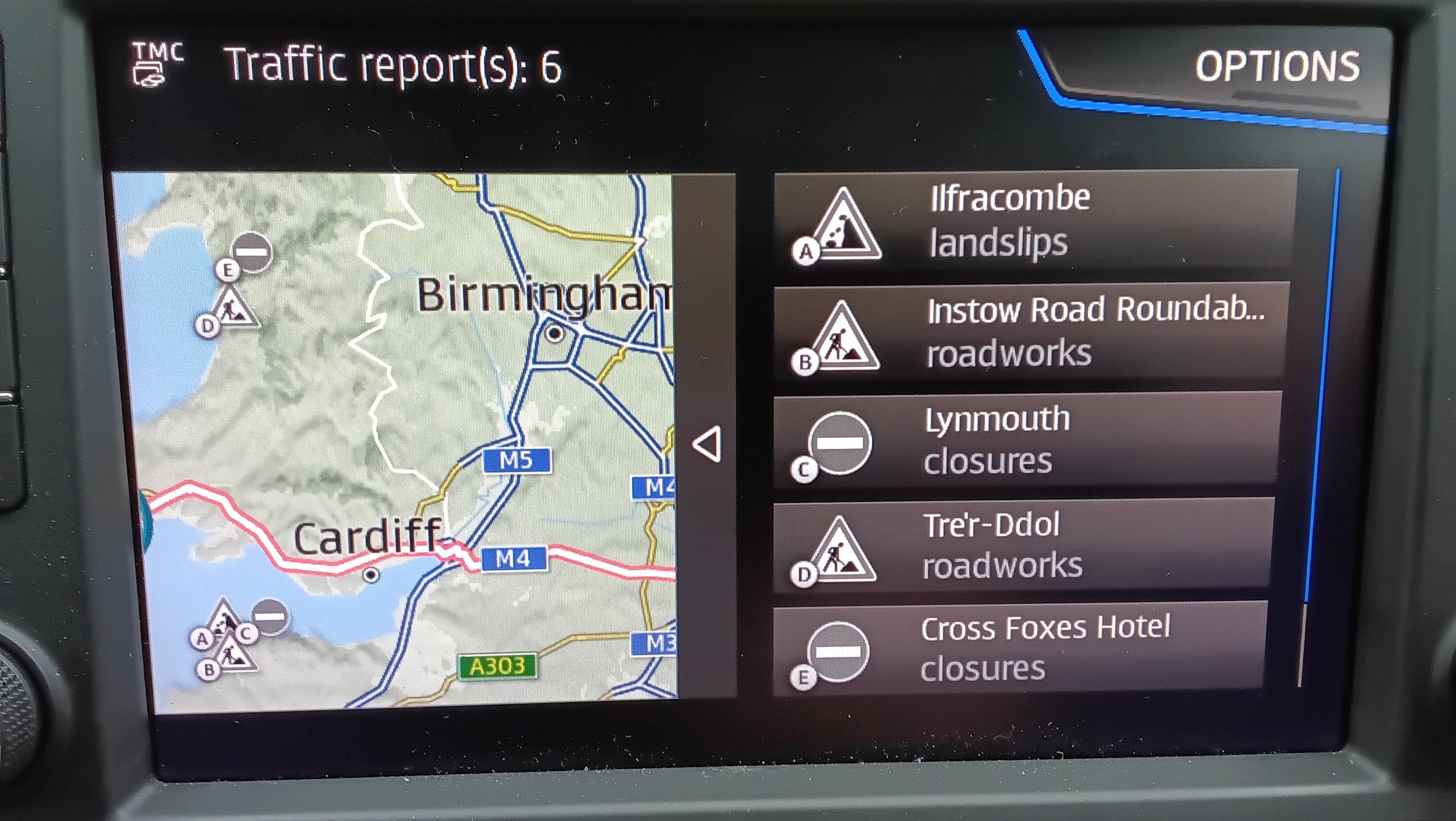

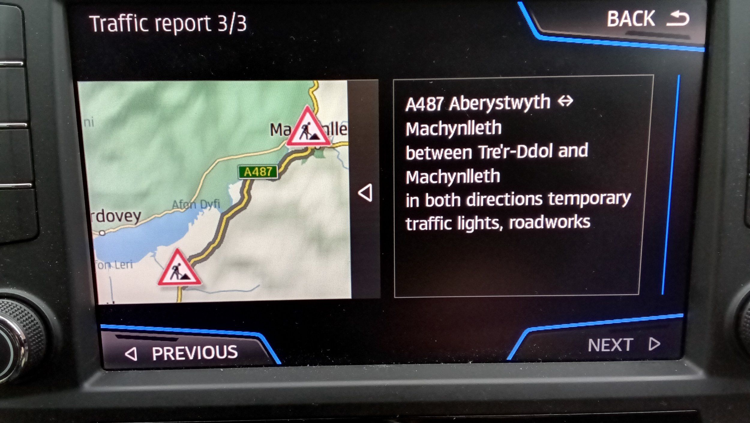

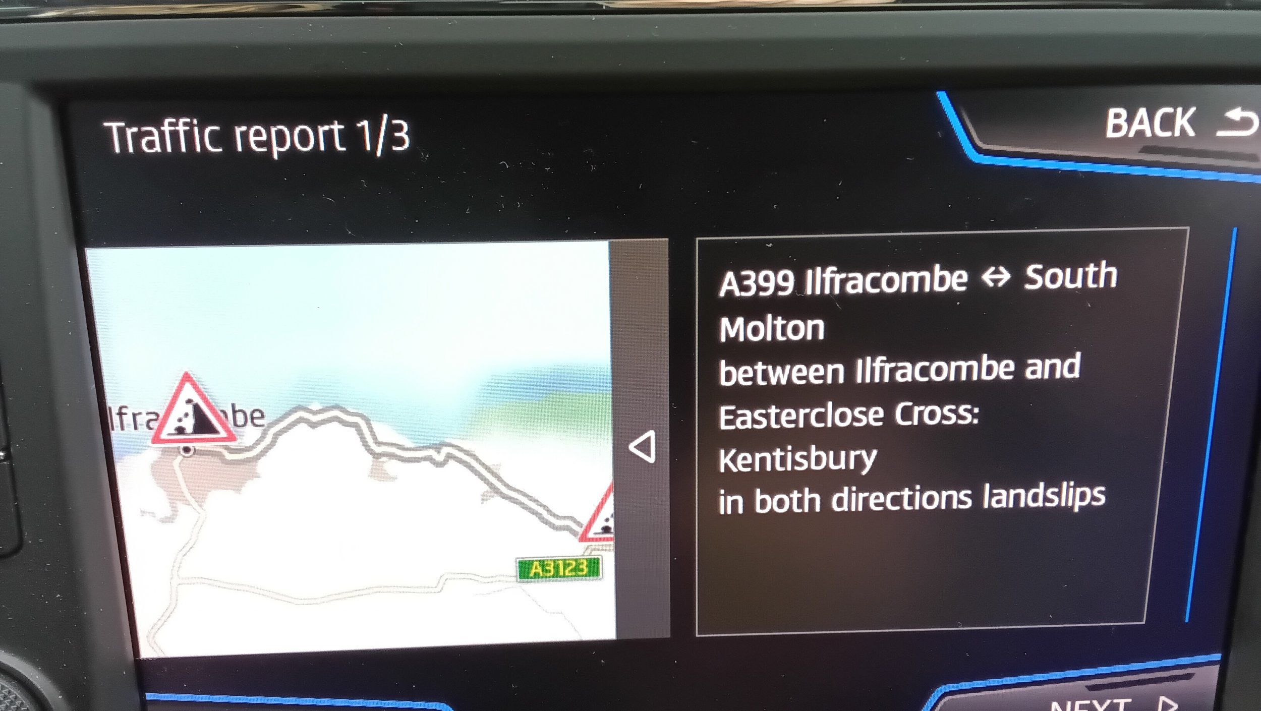

All working today round here. I didn't give it a proper test of waiting yesterday. With no destination in mib2. I think it shows road works and delays in a fixed radius of you so won't stretch to London for me although I've see London before. Might be filtered by transmitter. Best to look with no destination entered. 11 reports so far. Inrix as discussed.

Each transmitter does get its own localised feed. There would be too much data if everything in the UK was broadcast by each transmitter. From Wrotham I get to see everything in and around London despite being in East Kent. After a couple of minute earlier I had 107 reports from as far north as Luton. And this is what you want to see in the display:

The mib2 icon looks like the top one I posted, gets a cross through it when no TMC. That's on the traffic screen on the menu. Probably the same on mib1 when you see a traffic report on the map normally you tap it to read what's its reporting. Useful on the shopping run when I take the main road back to keep the DPF clear, ongoing water pipe work and I take the back road 🤣.
