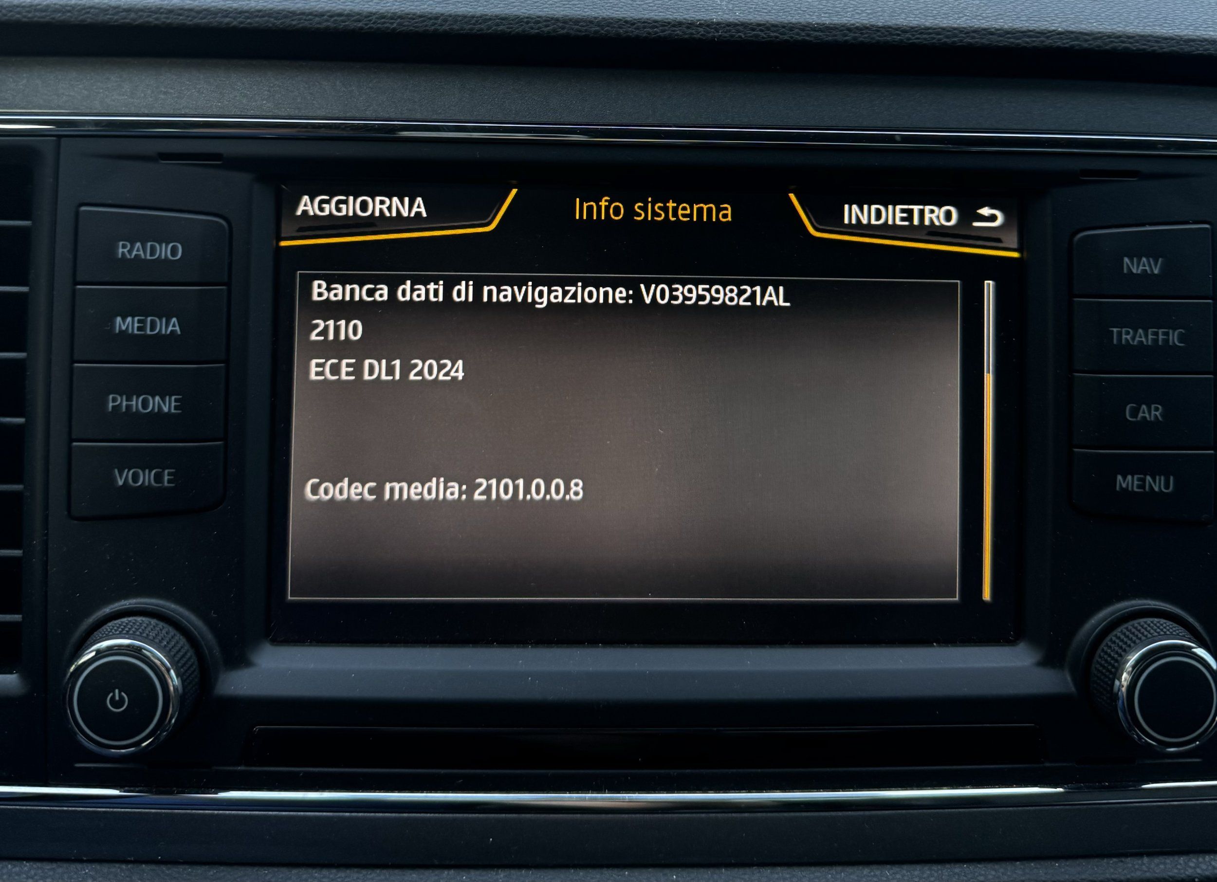

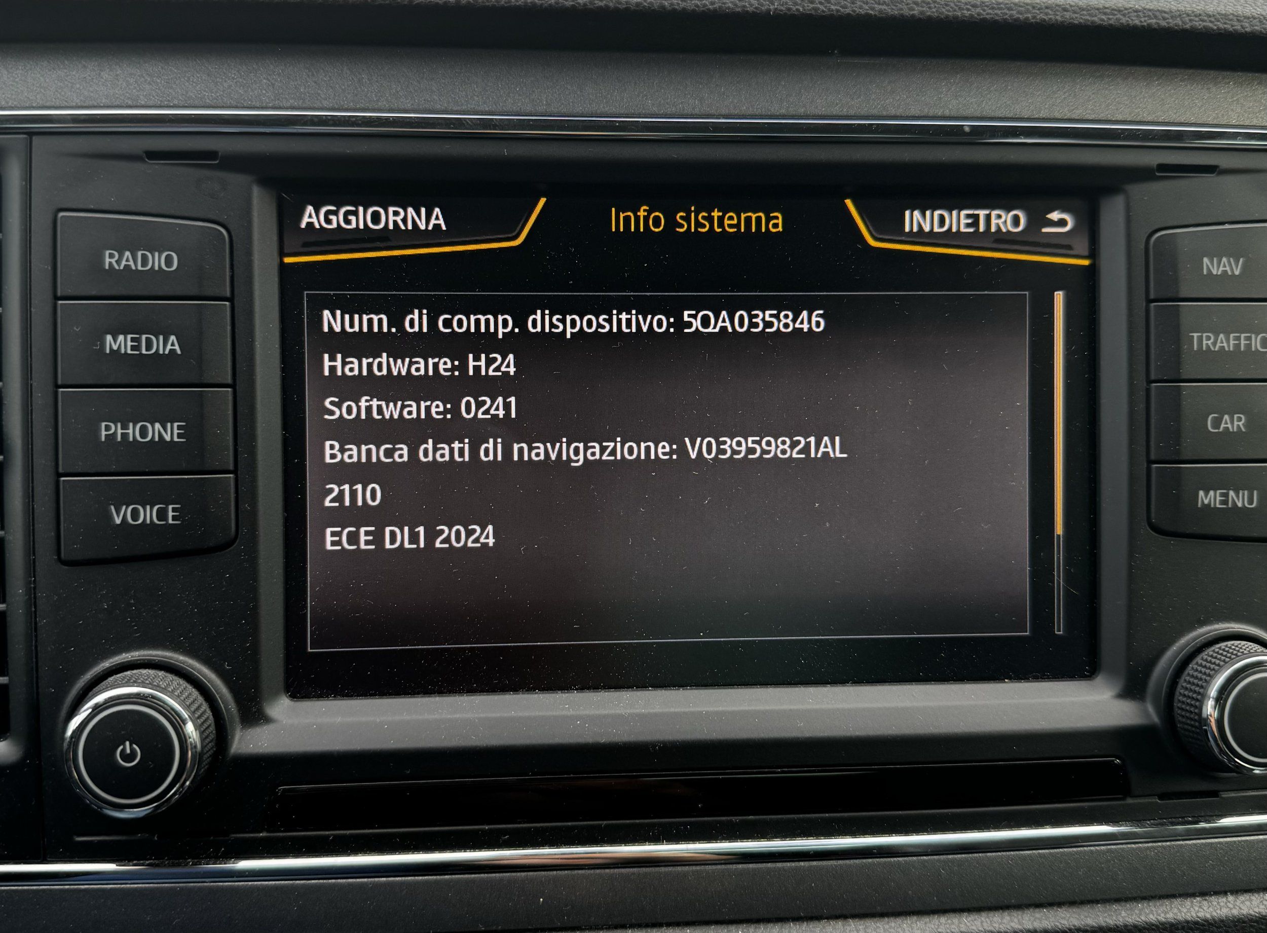

Good afternoon,
I am the owner of a Leon 5F with the following infotainment system:
5QA035846
Hardware: H24
Software: 0241
Navigation database (just updated): V03959821AL 2110 ECE DL1 2024
Codec Media: 2101.0.0.8
I kindly ask You to tell me where to download the most updated firmware file for my car model.
I remain at your disposal if you need more information,
thank you for the answer and have a good evening!

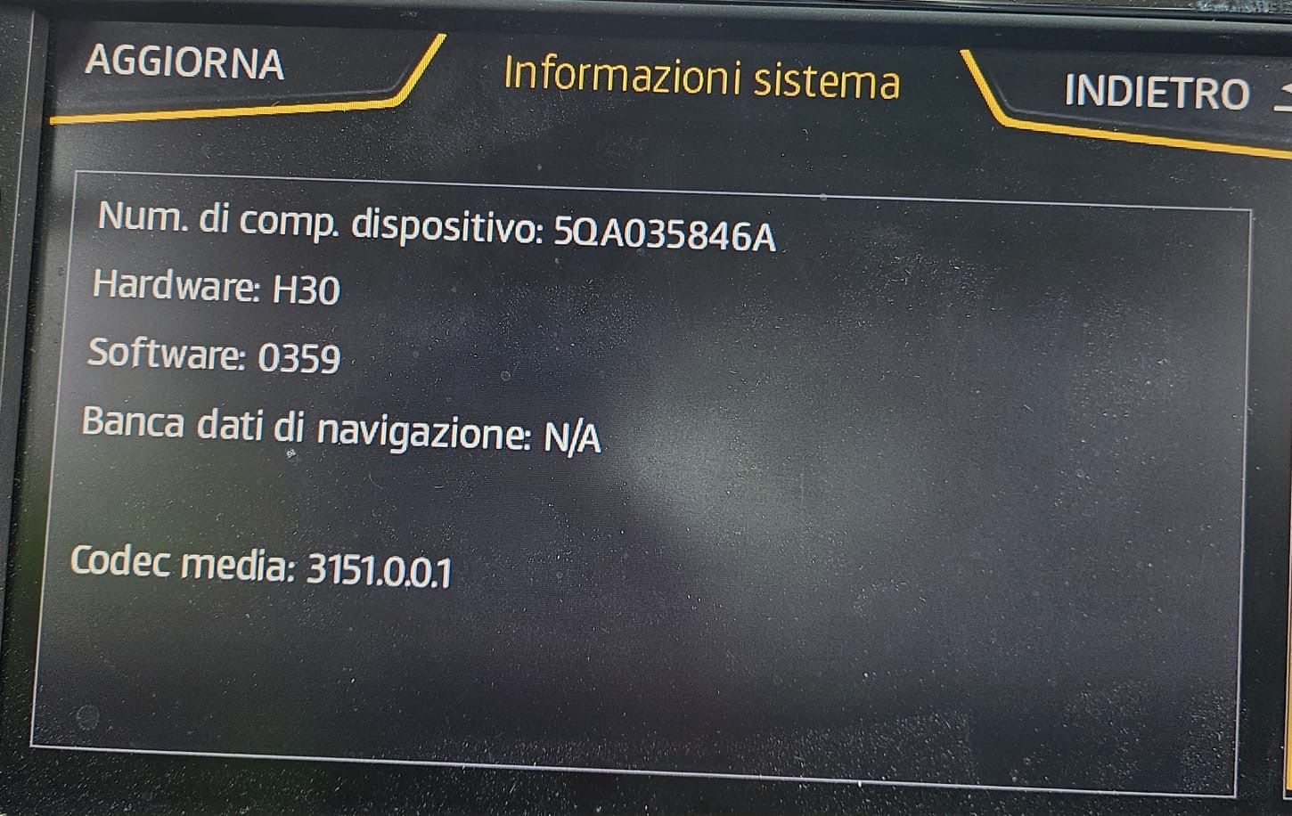

Good morning,
Maybe I explained myself badly.
The 2018 Seat Leon Xperience infotainment (device number 5QA035846A, hardware H30 and software 0359) has startup problems after using maybe the wrong map update on the SD card.
I would need to understand if there is the possibility of restoring and/or updating the infotainment system even though the infotainment itself does not always turn on and does not react. Is there a method to reset the infotainment system remotely?

The maps worked for a few days, after which the navigator started restarting on its own, every now and then turning off the screen and running in the background (without the possibility of a touch screen) and now not restarting at all.
In one of the last starts we tried to do a factory reset but it shut down before we could do it.
Is it possible to do it in remote control?

For me, that's more of an unfortunate coincidence. In my opinion, the device has simply become defective. Should I just take it to a service provider to repair it?
Reactions: Tell
Tell
Full Member
Yes the mib2 standard firmware isn't the bees knees it allows memory mismanagement we did get it once in the Arona. I pinned it down. That was due to embedded JPEGs in the music file being played in the unit. They are suppose to be circa 512x512. You would not expect a large jpeg breaking that parameter to reboot the system.
First I thought it was a corrupt mapcard. Pulled it out, tried another one I'd got, same issue. Not the map card. Next tried it without playing the SD music card, it worked. Then pinned it down to a track / album. It was off the net someone had embedded a 1,000 x 1,000 jpeg image in the track. Well fine on a home system but not on a mib2 standard where the programmer hadn't made an allowance for that. You'd go can I load this image into memory, yes/no. No don't load it in. They had gone yes and had produced memory overflow where it crashes the system.
This issue will come up on mp3 and FLAC libraries. There are programs you can run to delete the embedded jpeg and then put your own image as say cover.jpg in the album directory no bigger than 512×512. I've got a post where I name that program on the board, it was used a lot in the past.
I cover my problem here and solution:
It might be that issue. You have to see whether it reboots not playing music but just navigation. No music or navigation. If rebooting on navigation alone it will be a corrupt SD card. Buy another VAG one. Any brand.
You can put the unit in demo for navigation, under advanced. Engine off and just wait for the unit to reboot. That's what I did in the diagnosis of the issue going through those alternatives.
