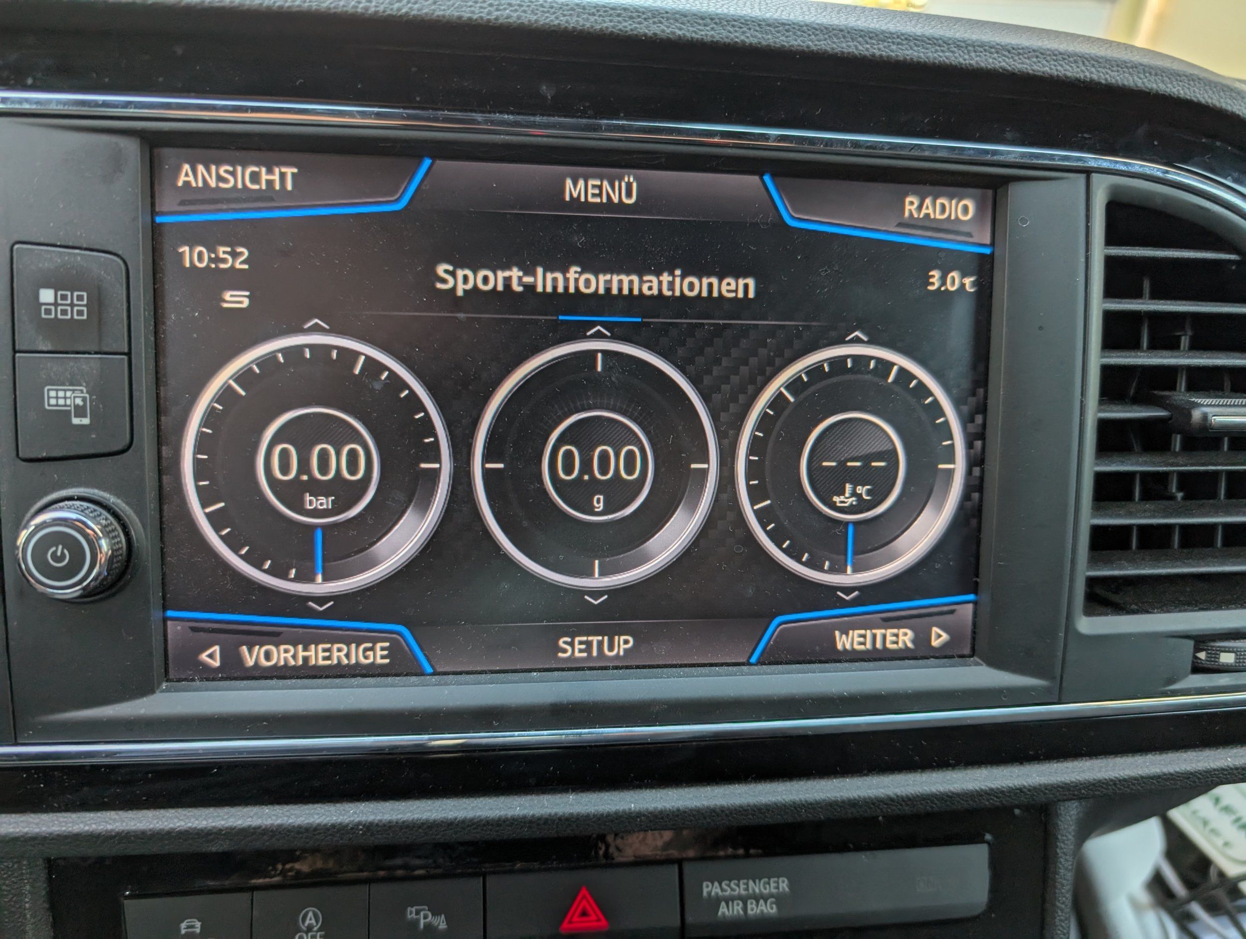

Firmware 0480T HMI ab Firmware 0516T
Blue from Ambiente

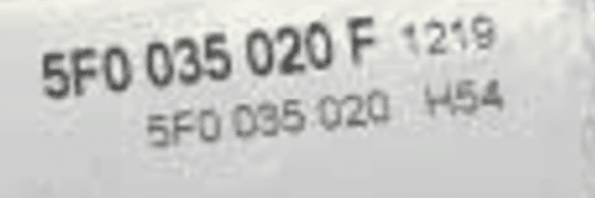

Thanks for your feedback. Today i bought a 5F0035020F MIB2 High i have the orginal invoice with old vin number so i can do online coding if is needed. Or can i patch 5F0035020F with the mib2 high toolbox?
That's not how SVM works... It's pointless spoofing the old VIN to configure the unit to it, as it's already configured to the old VIN. It's not possible to SVM incorrect part numbers/software info to your actual VIN
You'll have to manually code & parameterise the new unit
The invoice from the breaker with old vin was needed to be show to the seat dealer if i wanted coded to my vin. Thats shows its not a stolen part.

correct. best to use VCDS to create an image of the control unit. then upload this to the new unit. the channels that are the same will be adopted, everything else has to be done manually.
