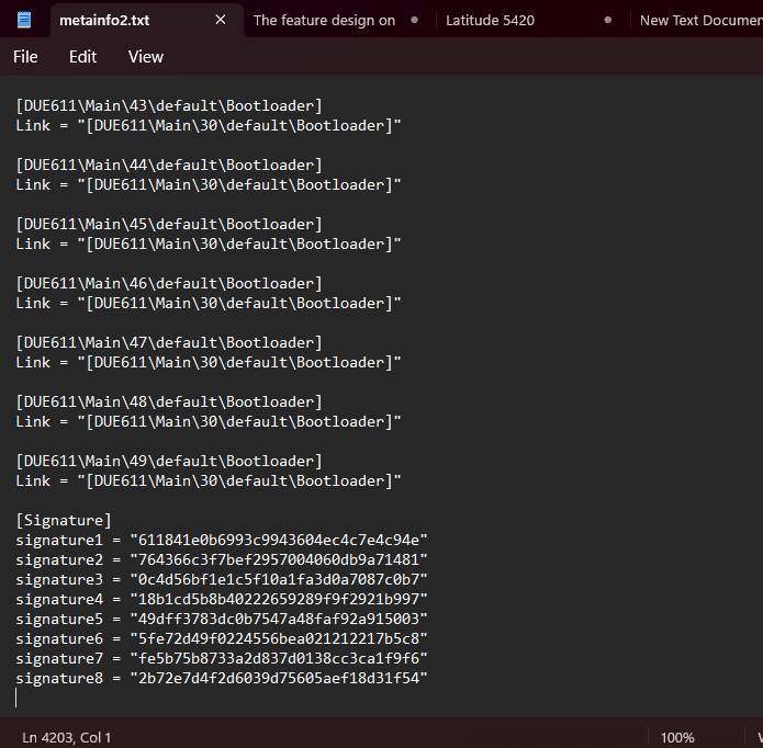

I have downloaded 480T zip file, extracted it to a folder. I'm not sure which files you were meaning by "meta files" but there is a file named "metainfo2.txt" at the root. As you can see in the screenshot below, it has a "Signature" section at the end and there are more than 4 signature lines, numbered from 1 to 8 actually. If this is the file & those are the signature lines you mentioned, it seems altered, am i wrong?

In a post above, @Tell mentioned about a way to check whether the files are original.
Now waiting for a reply from him, just to be on the safe side.
Yes it's an 8 signature... My memory 🤤.
The modded firmware bungs code under the signature. No code below those signatures you know it's not been modded. Those 8 lines is the lock on the files indexed above from being hacked. It was a Vag design oversight that the unit was open to the exploit.
Whilst with a super computer you can work out the primary key that Vag uses don't reckon anyone has done that yet. But a weakness in the mib2 firmware was you could run code after the POI import method which is how all the modded firmware works. The green menu tool kits all use that plus the "AIO" software. It's still clever stuff since they have to compute all the hashes as well.
I have come across people that say it can be modded but you still have got to make that signature sla1 signature check to work. A tall order.
The same Vag primary key is used across all the mib2 products whether firmware and map files. The public key has been published so you can crank the check by hand which is what the unit does. If you have not got the primary key you can't manufacture the signature.
Was part of my education when looking at map updates. The navigation map file FeC was what I was really looking for as it turned out.

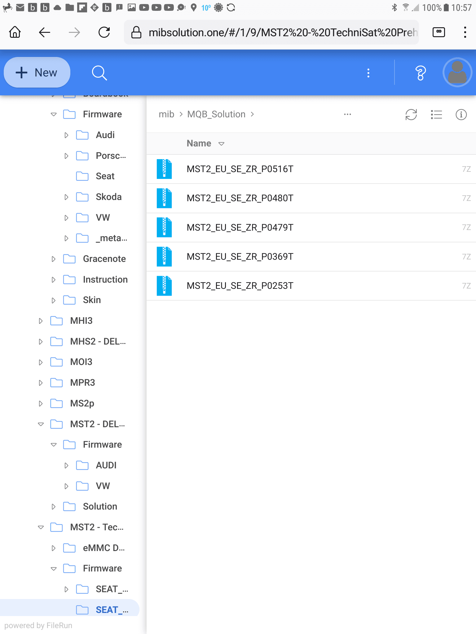

Hello all,
I would like to update firmware on my MIB2 system and to have full link system working.
Here are HW and software installed on my seat leon 5F 2016:
Sw: MST2_EU_SE_ZR_P0245T
Hw: 5QA035846
Sw version: H25.14.78_STD2Nav_EU
I would like to upgrade the firmware with following version:
MST2_EU_SE_ZR_P0253T
I downloaded it from mibsolution.one
Do you see any problems? Should it be compatibile with my system? Will be full link system working? I have also read in this forum about issues on USB not working after Firmware update..could it be a risk?
