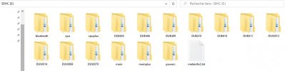

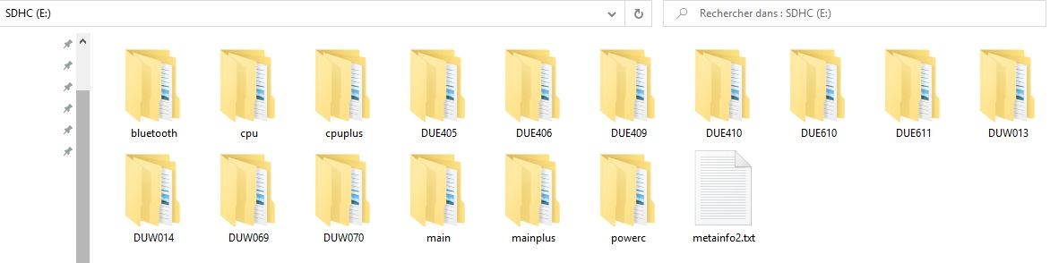

téléchargé cette version de 3,3 Go et décompressé sur la carte SD
Je suis surpris du nombre de dossiers ?
( je pensais trouver 2 ou 3 dossiers pas plus ) )
certaines personnes disent que la mise à jour a pris 1 heure, d'autres disent que cela a pris 10 minutes ?

downloaded this 3.3 GB version and unzipped on SD card
I'm surprised by the number of folders?
( I thought I'd find 2 or 3 folders, no more ) )
some people say the update took 1 hour, others say it took 10 minutes?
who's right?
thanks

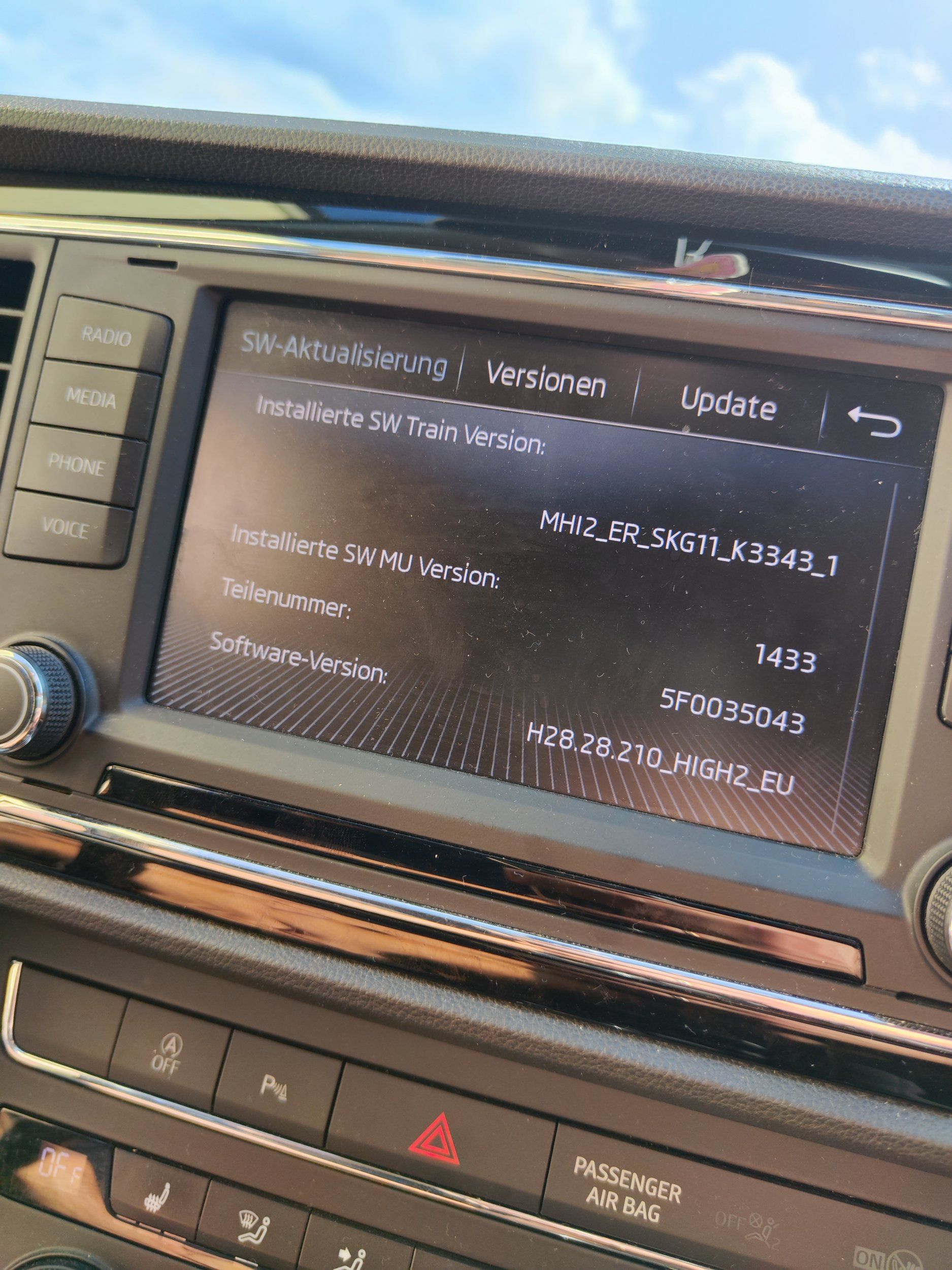

Ive got an Leon from 2015 with MIB2 High.
I think the car has never got an update from the dealer because the firmware on the unit was MHI2_ER_SKG11_P0257.
Why the hell a firmware from Skoda?
So it was not possible to do an update with Seat firmware. Then I choose the AIO firmware MHI2_ER_SKG11_K3343_1.
The flash was possible and I got only an Gracenote error but the only thing I want to use is android auto.
The Problems are:
1. At OPS overview no car will be shown. The beeper works but no car and no obstacle at the display.
2. Full Link menü opens and shows the symbols for android auto, mirror link and apple carplay. After pluggin in the smartphone, nothing happens. I already checked the coding with VCDS for full link and OPS but havent seen any errors.
After the update the system boots as Seat Connect. Ive changed the skin to carbon and then it boots as Skoda.
Could someone give me some hints? Only thing in my oppinion is a downgrade with an older Skoda firmware without patch.
At mibsolution there is a manual to convert Seat to Skoda firmware but they used the same firmware version which I couldn´t find.
Another hint at the spanish forum is that it was possible to change train and name so that official Seat firmware could be flashed, but there are no words how that could be done.

That is the Skoda version of the software you need the 1447 AIO version for Seat. Why it might talk about Skoda on what you have done. I guess you can write it straight on top of it.
There is a thread on here but also comes up on this thread.
The correct software is this
Third row down, guest, guest
1447 AIO is the Home brew final release of 1447 taken further by hobbyists adding in updates for Gracenotes and all Seat FeCs. You let it run to the end to do the FeC stuff. There was one case where someone answered the question wrong which is something like install mib tools, answer would be yes, so you get all the FeC updates which would be AA, unlimited maps etc. Wrong answer they didn't get the FeCs, the added value. Suspect if you look at your FeCs now you might have some Skoda one's in, but you are missing the Seat one's may be. The mib tool app is installed during the process to do the FeC edits.
@jpmedia is an expert... many more and @MIB-Wiki is like the enthusiasts administrator of their work. He posted up that separate thread on here somewhere.

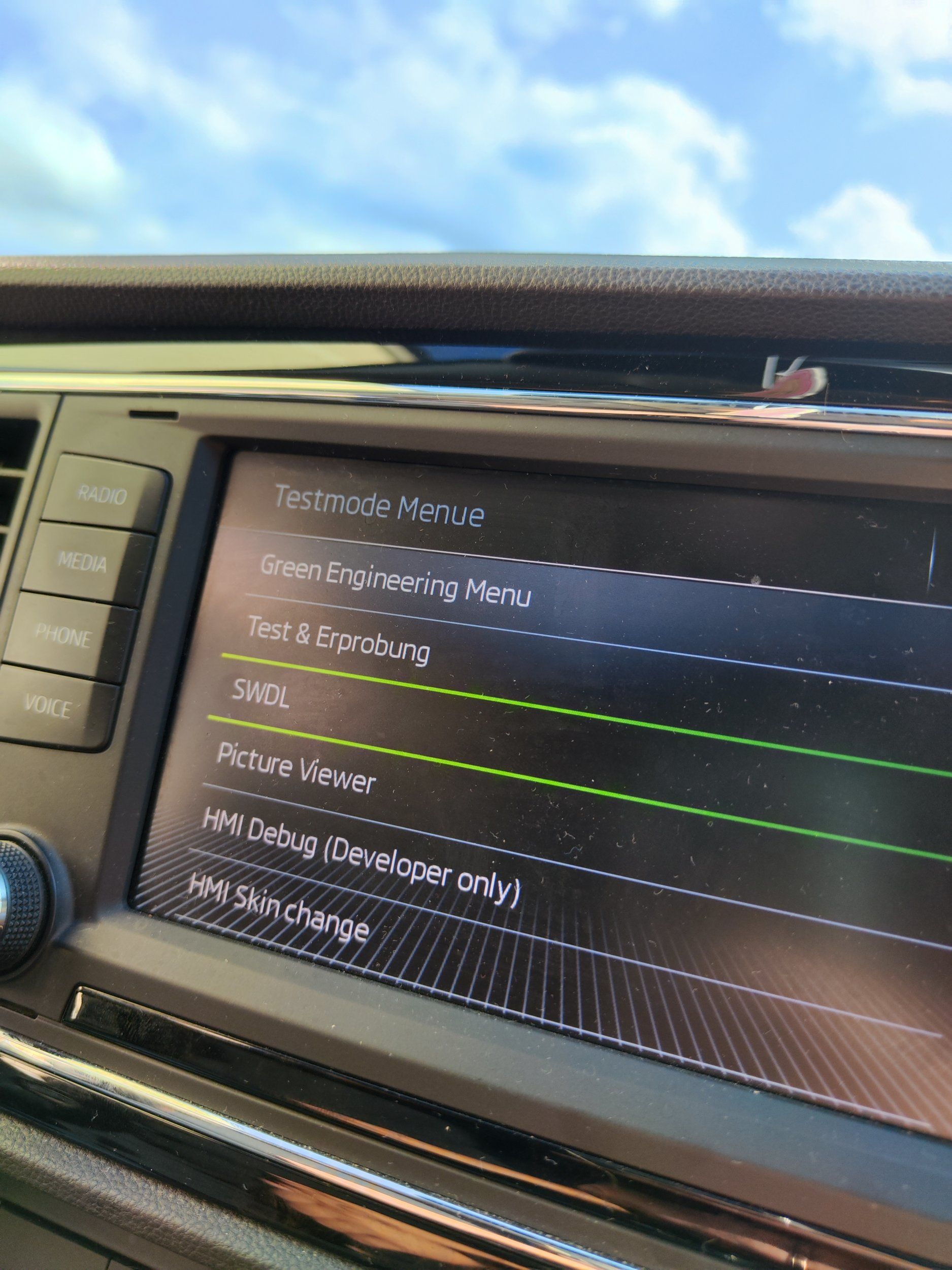

You might have to go into the backend menu, call up swdl to get the 1447 AIO running. Thats the long menu told till you see SWDL menu. You'll need the developers menu in the 5f unit unlocked if it hasn't been yet.
Photograph your FeCs now. Do 1447 AIO photograph after. There is on this thread a conversation on changing the display colours on the FIS. That comes up when you install this firmware on older units. Seems more of an issue where people use tools to fiddle with the colour palette on the mib2 screen then the colours don't tally with the FIS. You'll see that weaved in on this thread.
That's my advice but don't blame me. Generally it's a good idea to use the correct firmware 😍.

At the first time when using the Seat AIO firmware the error was Train error because of existing Skoda Firmware.
Haven't checked yet but is it possible to flash Seat AIO firmware with SWDL function? No check of compatibility with existing Firmware? The Developer menu was activated by myself with VCDS and the Skoda AIO Firmware installed m.i.b.

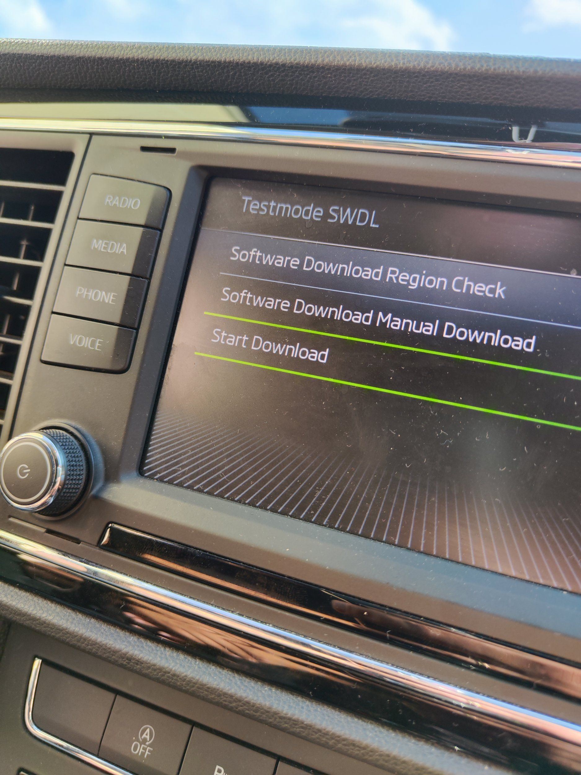

Whilst I think of it the SWDL menu has a forced do all on it. Question of picking up the download all on it. Normally it works forwards like the the front update menu but if you want to update everything (includes a downgrade) there is an all toggle on it. You will see it by moving about (key word is All from memory, on a tab at the top). Had to explain it once when somebody wanted to do a downgrade. Depends how it sees the Skoda firmware you managed to put on it by mistake. That would be a replace all rather than an incremental update.

The SWDL menu did not look like it has to be.
First one, click SWDL, click Start Download, then opens the normal software update screen (look at left corner)
At this point, there is no update possible because of the same error message "Train blocked".
My second try was to use the autostart SWDL funktion with the sd card. But then the message came up:
Update not ready. Please wait .... This can last 10 minutes"
At the left corner is the circle which didnt move and after 10 Minutes nothing happend, Only way to use buttons is to restart unit.

It's the software start manual download option, then you force all from the top toggle, then go start. That's how I remember it. The manual download overrides the auto update. You see after toggling the all bit or whatever its called, it what's marked for update. Go to far backwards and you leave it by accident. Done that a few times now. When I'm playing with part map updates but the same with the actual firmware.
Before using the autoupdate, the menu was not as you described. When choosing the SD Card, the train error shows up. There was nothing to select or nothing markable for update.
So then I will restart the autoupdate and wait longer. But must the circle rotate or not? It looks like the system hung up.
Better using Ctek MX5 or running engine?
