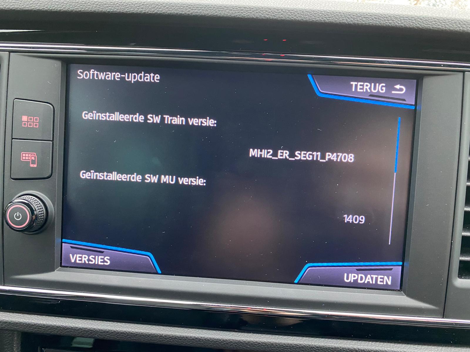

Following this threat for a while, nice to see there is almost a solution for anything. :) I have a MY19 Cupra with a MIB2 High and Beats Audio. I'm currently running P4708. Can I go straight to 4709 by using: MHI2_ER_SEG11_P4709?

You cant jump trains, which means you are OK since that is a "4".
That's the one that gives you 1449 release. You are on 1409.
There were some language issues with that but you fix with topping up with missing language files from 1409 which you have. If you look at Mib Wiki's last post they have something that fixes that. The DEB board still rumbles on about missing language files. Back on here they can be fixed via the backend mib2 high menu (SWDL) via adding the missing stuff from 1409 (you need that release as well to hand). That was done here where I steered someone thru it.... as said if you read above that is suppose to be fixed. Where Mib Wiki says I have something new for you to play with. 1449 is the final release of the mib2 high... I'm happy with 1338 or 1339... which ever it is.
