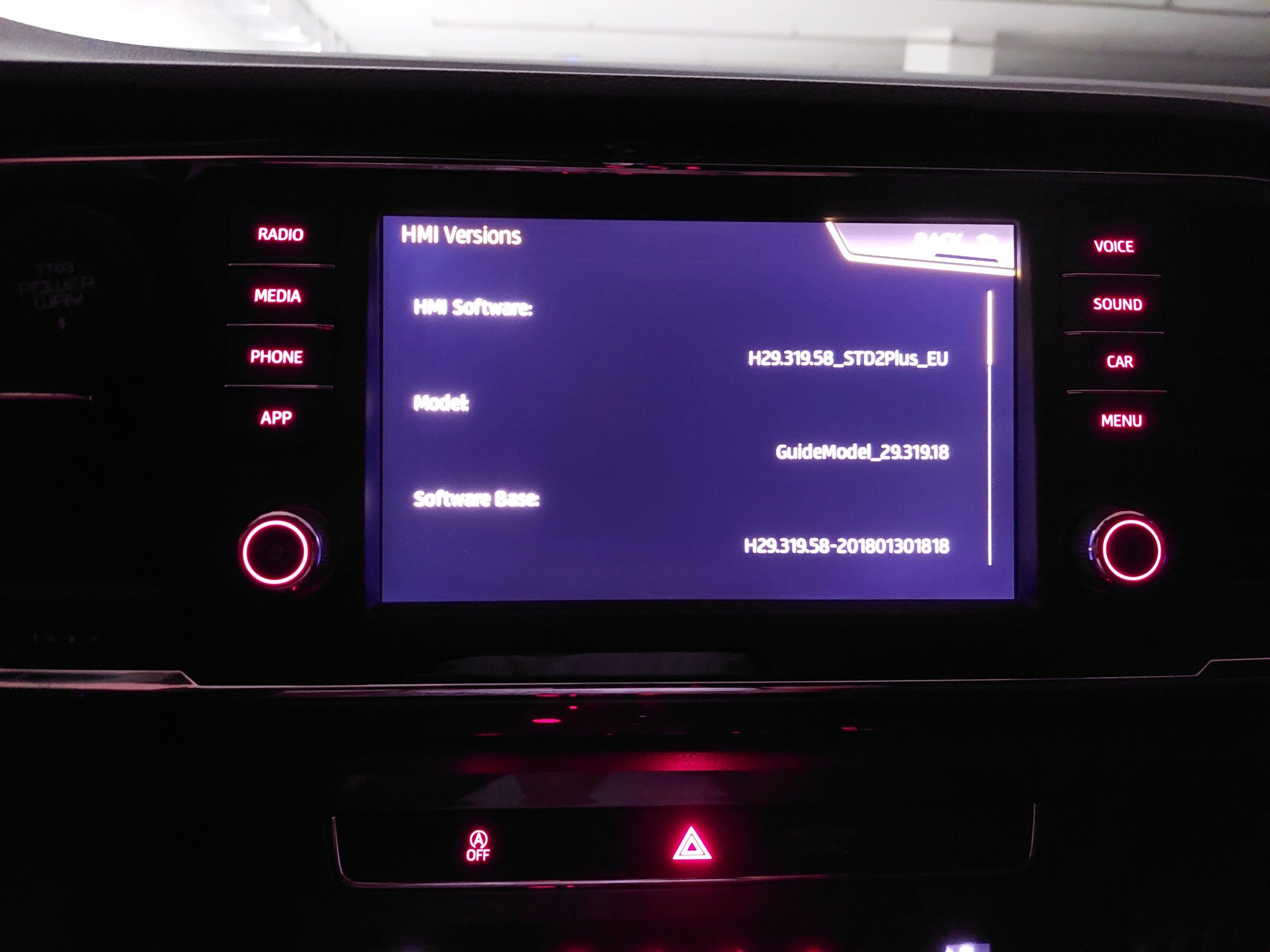

Good evening to all of you! First of all thanks to @Tell who is helping me out for the issue.
I own a MIB2 (Seat Leon) with dedicated hard drive (so no SD card for maps) and was looking into a way to update my 4 year old maps.
Looking around I discovered some things here and there and at the end I updated from MU0897-MHI2_ER_SEG11_P3315 to MHI_ER_SEG_11_P4709.
During the update I had an issue with "speech-tts-voices" with error code 143. At the end it was the only voice Non-Ok. I looked into the SD folder finding the specific folder and everything seemed fine to me.
Afterwards I patched the version to have again and ended this way with my version. I then picked the maps, put them in a SD and tried to updated but nothing, it stood there looking for metainfo for 40 minutes.
Now, here are my points.
  • Am I missing something during the maps update? Am I doing something wrong? FEC states 073000ee
  • Once the car started the navigation module takes up to 2 minutes to load, before it took like 10 seconds, anyone know the issue?
  • The speech-tts-voices is related to the navigation part so I don't get any vocal indication. How can I fix this?
Thanks for your help

I took again the folder from 1409, deleted the one present in my SD 1447 and pasted the one from 1409.
I tried then to apply the update but nothing still error. The car discovers that the only change to do is on the speech part but then an error appear again and cannot istall it. Some screen of what he sees
On the other side I confirm the slow boot, once started it take up to 2 minutes to load the navigation or the full link. To boot the service mode it takes like 5 minutes.
Now, can I update/revert to another version?

I was finally able to update the FW!
Formatted the card with SD formatter, copied MU1447, looked into the speech-tts-voices and found the TR_male language missing. Copied it from MU1409.
Updated everything by SWDL, patched the version. Everything seems fine, tomorrow I'll test the navigation tts. Also the startup doesn't take long now, just the time needed. Now I'll copy the maps and try to update it
