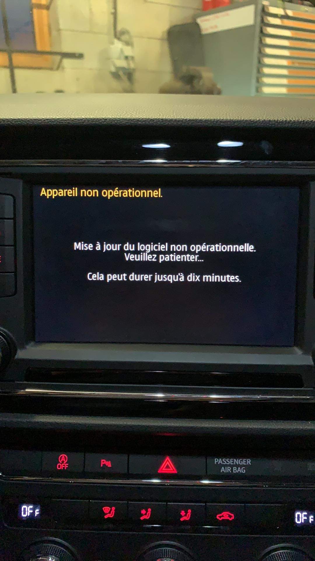

i saw it in french it's very complete and the first time i see all the explanation in one document!!!

Did someone pass directly from firmware 02XX to 04XX or 05XX ? I always did it from 03XX to 04XX then 05XX. Thanks!

do emmergency update with proper fw in same sw range.....MU version 0245 you do emmergency with MU0253 and so on.
for this you need uart and connect pin to the right pins (soldering inside to the pcb . tx rx gnd to mib2 frame...=gnd)
when powering up bridge the 2 contact holes , when you see option list , remove bridge and press 2.
you used swdownload not from 02xx 03xx 04xx Version you had originally on technisat....
from 02xx to 0516 , when using swdownload from 03xx (xx= any version) then this happened....
tutorial is on mibsolution i think. if not then in my brain...
What does MU version mean? I'm on 0245 and had seen the update MST2_EU_SE_ZR_P0252T_5F0919360A, then I saw MST2_EU_SE_ZR_P0253T_MU0253. Is the MU an untouched update from SEAT or is it one that's been patched, etc?
