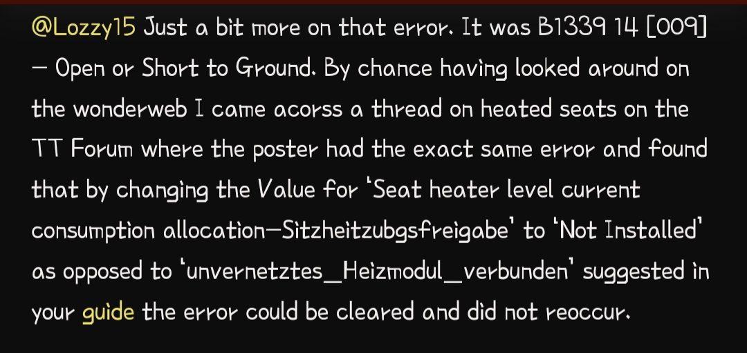

Changed the coding today and the fault code has now gone. Not sure what that setting is supposed to be. Google suggests un networked heat module. Either way selecting not installed has solved the problem..
Sorry for the late response, I saw you had posted the other week but have been too busy to respond until now.
I do remember coming across this error not long after installing the seats, but for whatever reason I didn't look further into it as it wasn't causing issues with functionality. I'm glad you managed to find a solution to the issue and appreciate you sharing the info for it here.
I've updated the guide to reflect this and have credited you for your contribution.
Many thanks!
Lozzy.

Lozzy15 updated Retrofit Heated Seats - A Complete How-To with a new update entry:
Error correction.
Forum member @STU3Y found an issue with some of the coding instructions in the guide. The guide has been updated to reflect this, however if you have previously used the guide and have come across error code B133914 [009] please carry out the following instruction to correct this:
Connect VCDS to the car and goto Central Electics. Click Security Access and enter code 31347 then click Do It!.
Now go to Adaptations and using the search function type 'Sitz', then press...

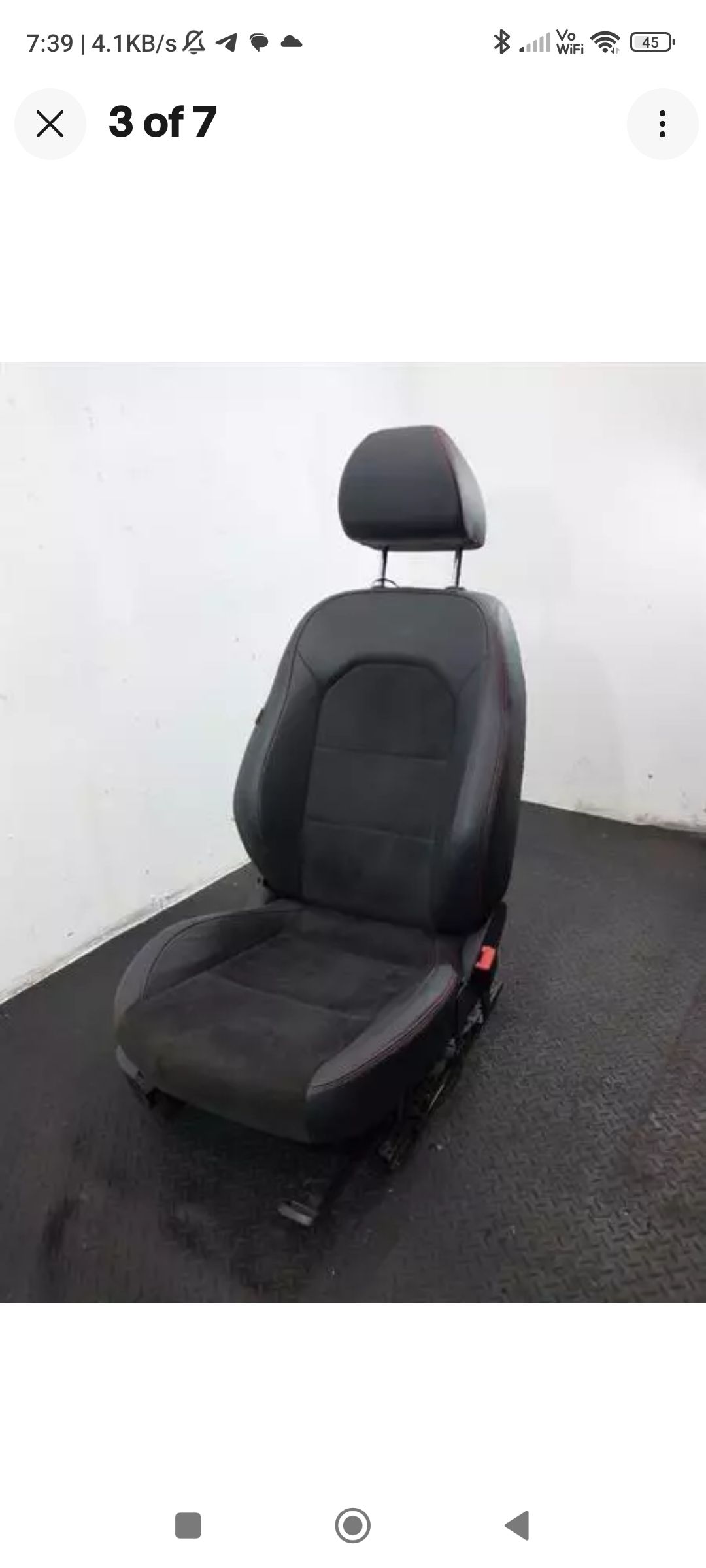

I have the half leather half alcantara seats from the black edition Ibiza. I want to pull the fabrics back but I've heard / read that alcantara and fake leather don't really stretch much and I'll likely damage it if I have a go for it?
Example of the seats from ebay

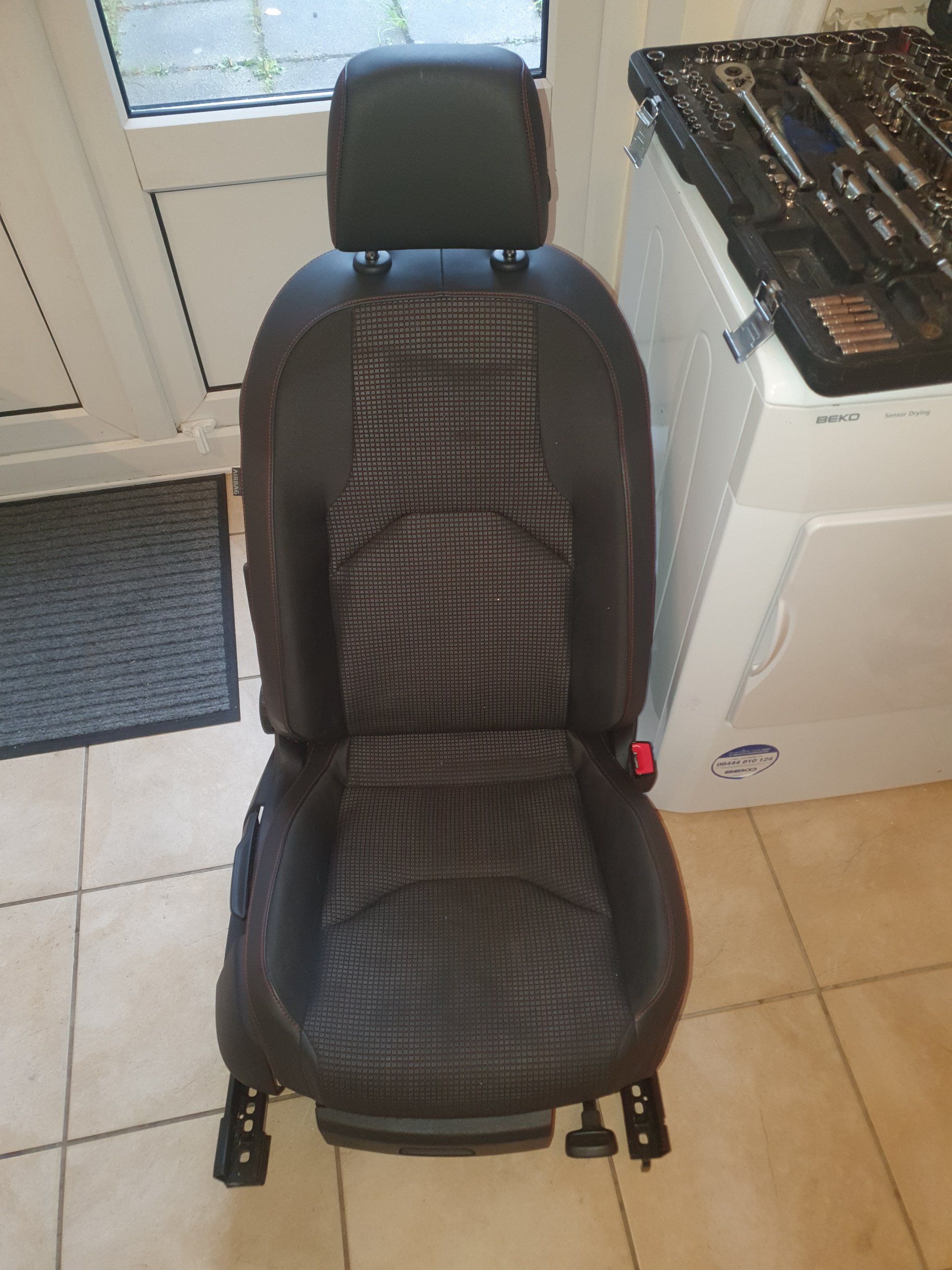

Is it this style of seat?
If so the P/N should be 5F0963557C for the back pad and 5F0963555D for the bottom pad.

Yeah this exact one. Respect for the help. I'll have a look for one now.

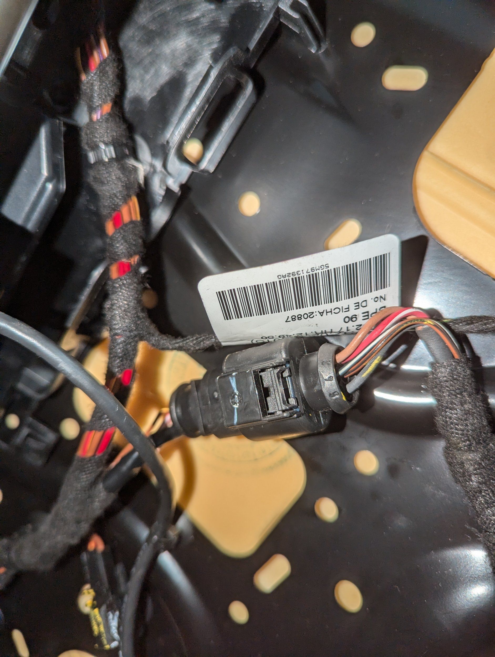

Hello! I'm coming to the party late, but I have recently purchased what I believed to be all the required items. After digging into the car a bit, I noticed that the passenger seat has a 6 pin connector compared to the 4 pin that comes with the Kufatec harness. The OEM connector seems to plug into the NAR(?) from the research that I have done.
Are there any workarounds you may suggest?
Thanks!

Hi,
Your location suggests you are based in the US? There is a difference in the wiring for US based models, off the top of my head I don't know what the extra wires are for.
Looking at the photo you posted I can only spot 5 wires in total?
I'll try and have a look for what the extra wire/wires are for later today if I get chance. Looking back at the guide I mentioned about this difference but never clarified what they are for so I may never have found out the difference!

Yes, that is correct. I'll have to double check but I think there is a green and yellow wire behind the others. I'll confirm that when I have a moment! The driver's side has matching connectors.
Thank you!
