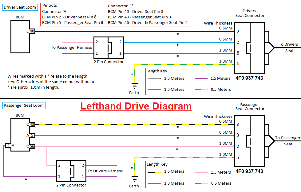

Coding and programming Retrofit Heated Seats - A Complete How-To
