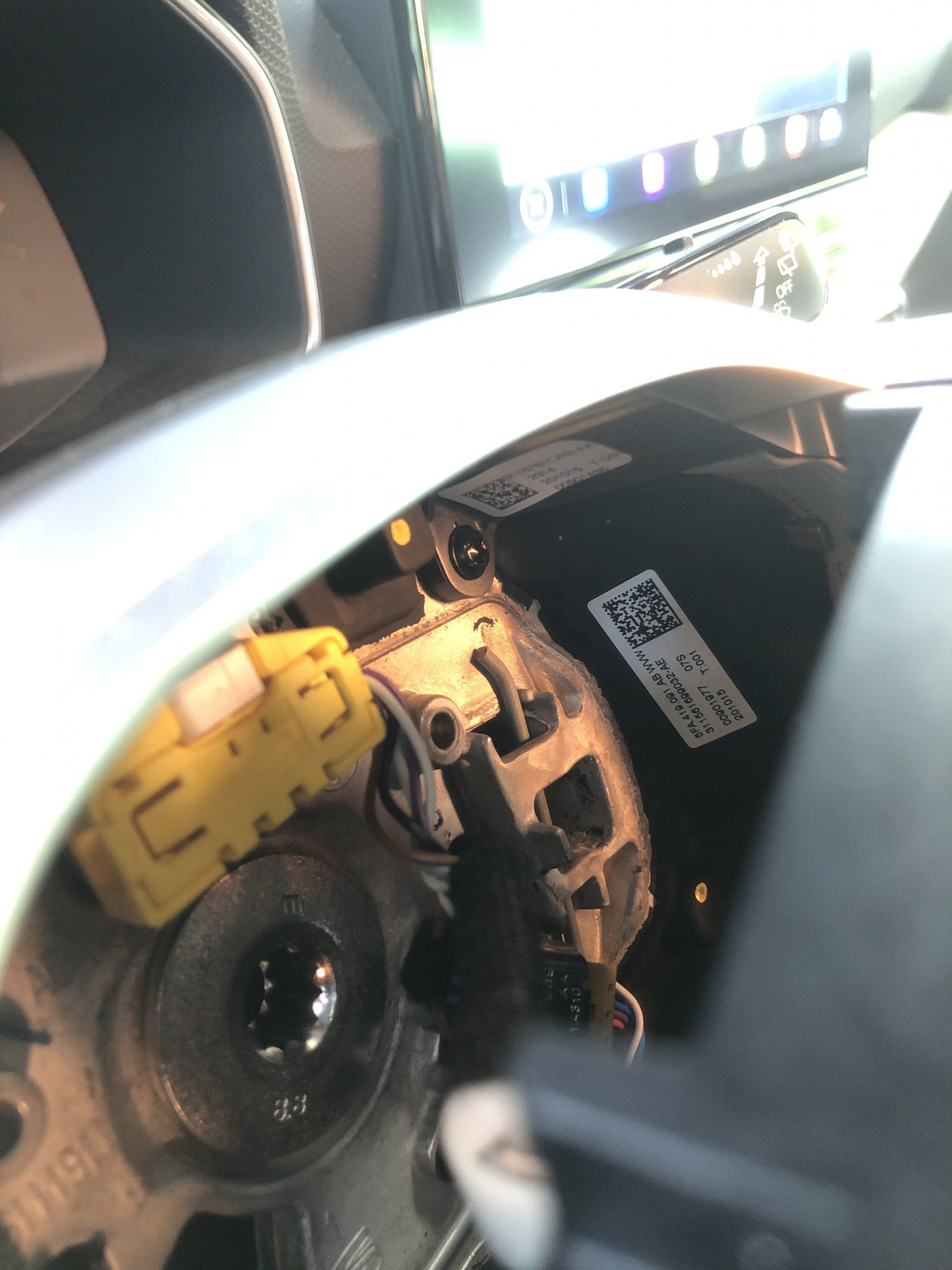

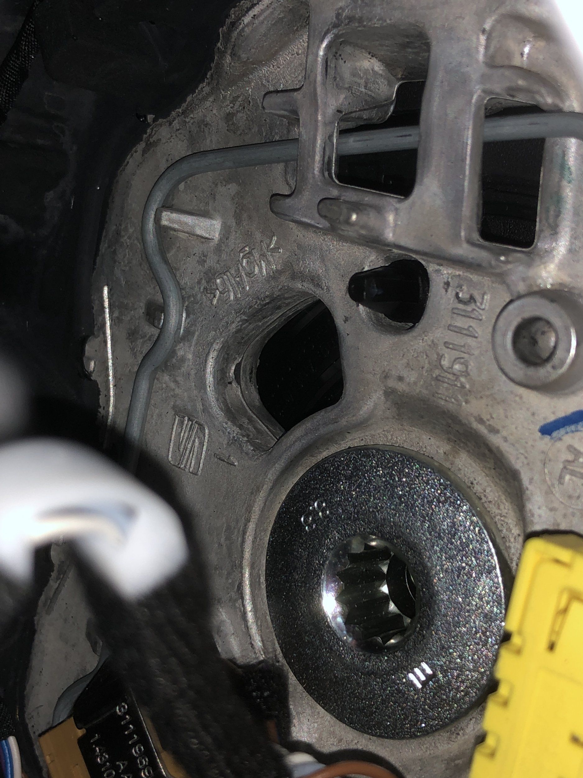

Well, I’ve removed my airbag. As I thought, I don’t have the female plug for the heating fonction on the steering wheel tree but otherwise It seems there would be no problem for installing the capacitive wheel.
However, do guys think that not being able to connect the heating plug would cause trouble with the travel assist feature.
