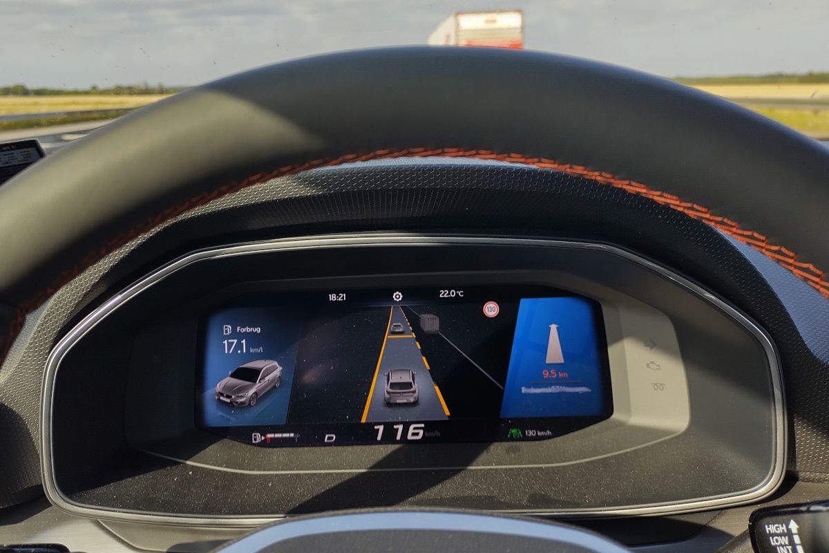

Show a picture of yours? I have to look this one is the first one who came out.
Mine looks like this, the road and other vehicles are grey instead of blue. I'm on software version 1788.
