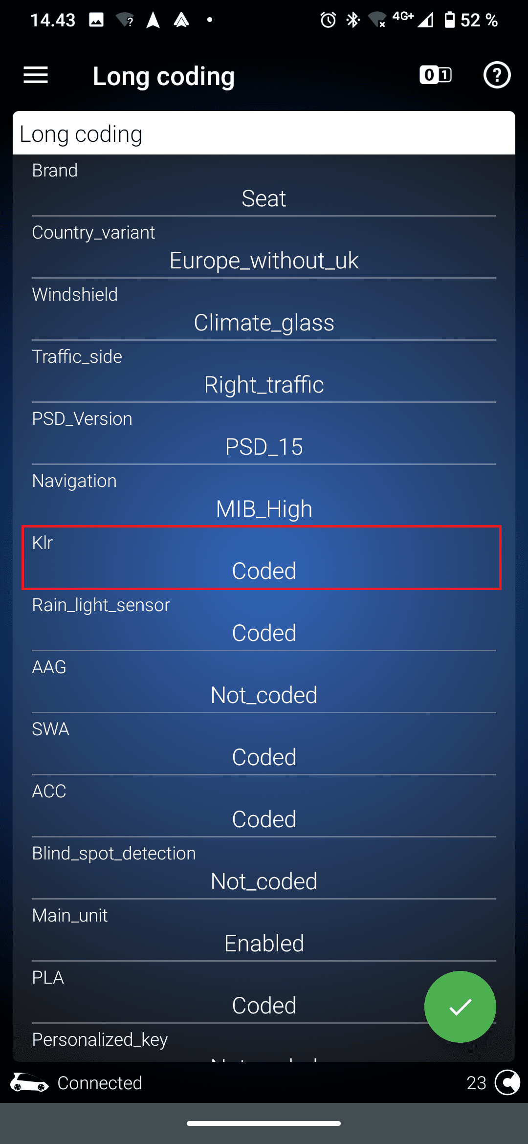

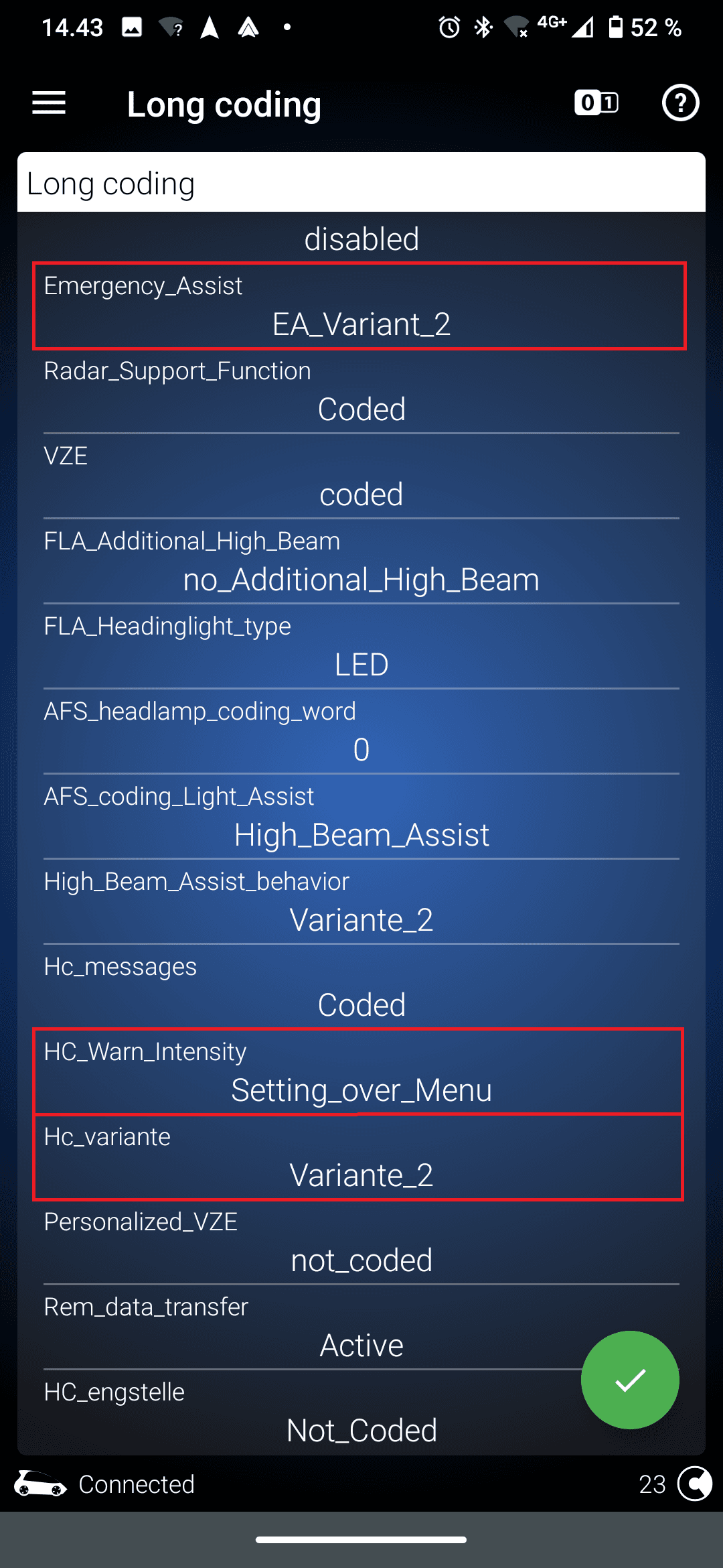

Well, I finally cracked it. Turns out the capacitive steering wheel must be coded seperately for ACC and Lane Assist, I had only coded it for ACC. Setting "Klr" to "coded" in A5 did the trick and I can now drive for hours without a single warning, as long as I keep at least one hand on the wheel :D This is really a game changer and it transforms TA from an annoying gimick to a very useful feature.
I also coded Emergency Assist ("EA_variante_2") and that seems to work very well also. I haven't testet all the way to the end, in case it decides to call the emergency services, but it is definitely bringing the car to a controlled stop if I let go of the wheel for too long.

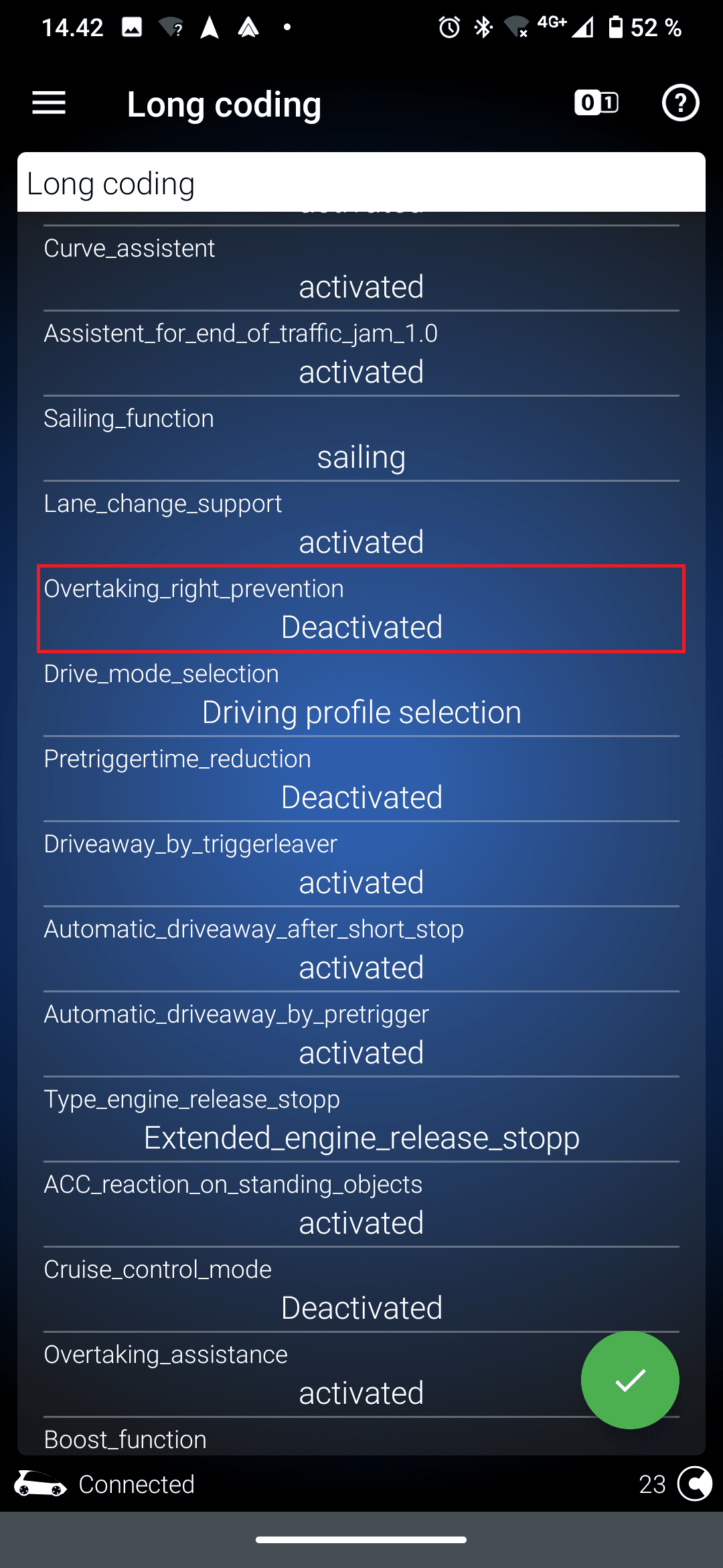

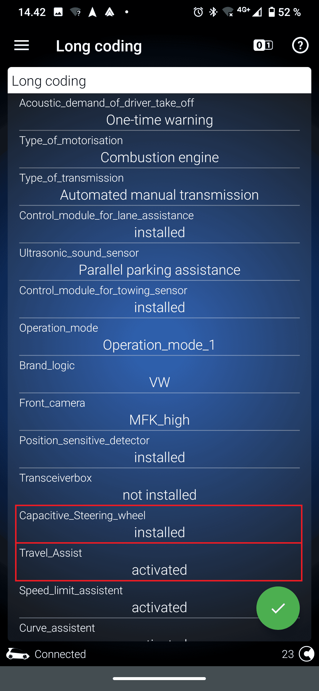

Zoidberg could you please share screenshots of your current obd configuration? With the recent changes you added I mean
Here are my current settings, the ones in red are the ones I have changed. I have no idea what "HC_advanced_takeover_request" does, I coded it before "Klr" and it didn't seem to have an effect, so just left it like that.
Control unit A5:
Control unit 13:

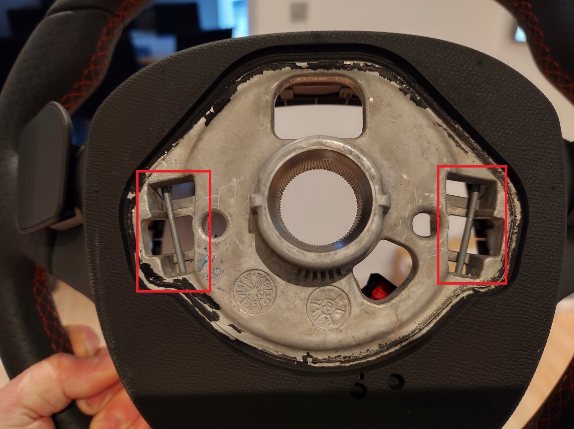

It would be awesome if the people who are gonna try installing the capacitive steering wheel could make a video of the DIY, for us simpler folk that have no idea how to actually do something like this hehe
I think it will be dificult to make a good video, because you are working behind the steering wheel, so not a lot of room. But basically the only dificult part is removing the airbag unit, and once you figure out the right sequence of steps, it's actually not that bad. To remove the airbag you just need to release two springs (marked below) with a flat screw driver. The only problem is, that with the steering wheel level, the springs are hidden between the steering wheel and the steering column.
So, my suggestion for the right sequence:
1. Turn wheel 90 degrees
2. Release one side of the airbag unit
3. Turn wheel 90 degrees, opposite direction
4. Release the other side of the airbag unit
5. Return steering wheel to neutral position
6. Remove negative pole from battery and wait a few minutes
7. Unplug airbag unit. IMPORTANT: you can release the airbag unit from the steering wheel with the battery connected, but do not remove the plug while the battery is live, as this may cause an error (I'm not a mechanic, just something I read while researching for myself)
8. Remove old steering wheel (M12 XZN tool required)
9. Install new steering wheel (M12 XZN tool required)
10. Install airbag unit
11. Hook up battery
12. Power on car, it may be necessary to restart the car again to reset errors.
