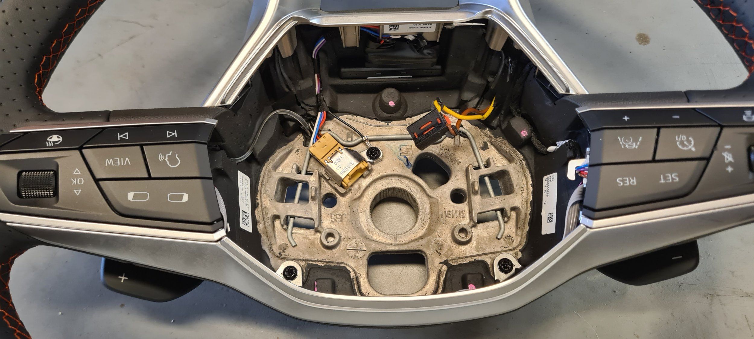

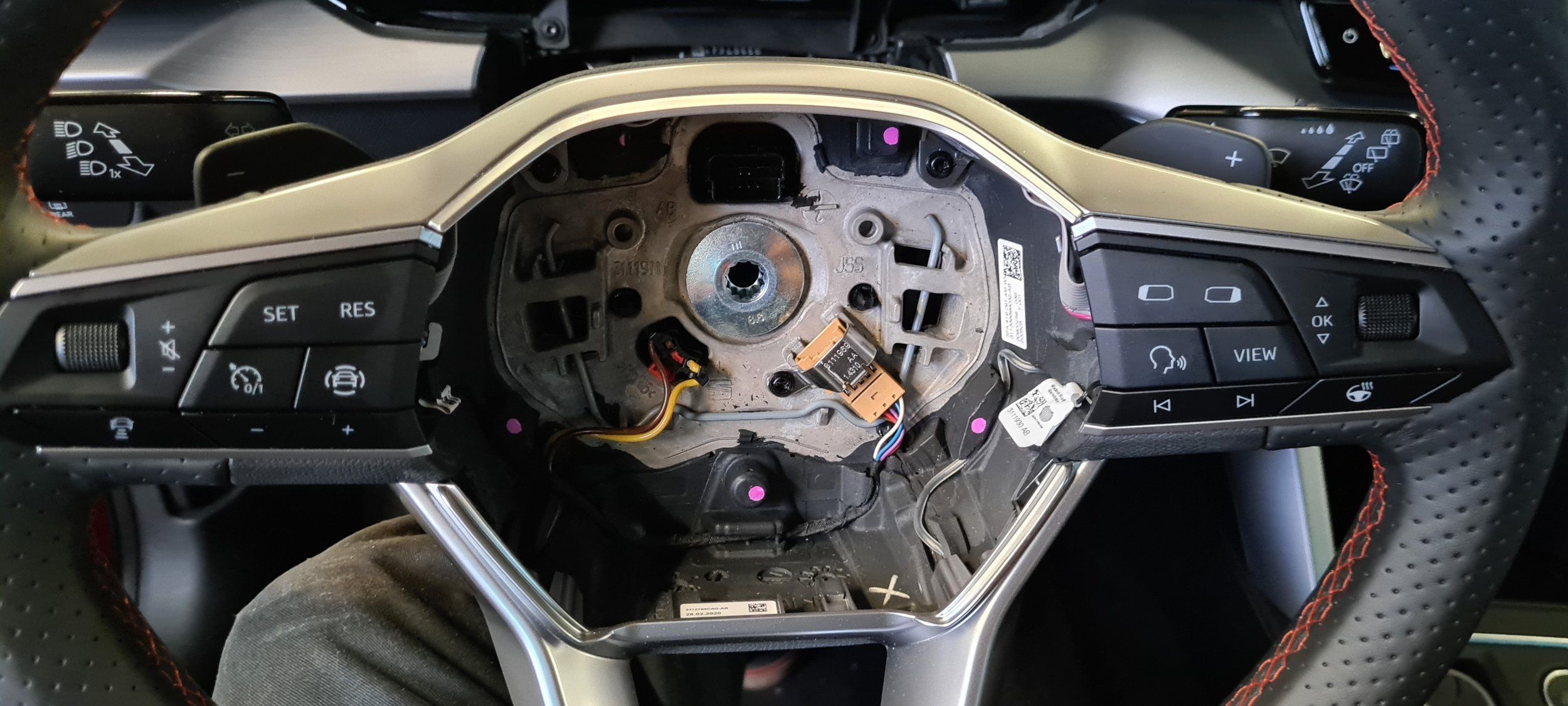

There is no difference in wiring on the car. The steering wheel is different. Extra sensor in bottom off the space behind the airbag
OEM steering wheel without TA:
OEM steering wheel with TA :
Widil
Jul 5, 2021
108
22
thank you it's interesting, I see that the "left steering wheel plug" have a destination on your original set up.
So if there's no thing on mine, I'm out of it hardware wise. On the other hand, if it's there, it may work.
Again thank you
