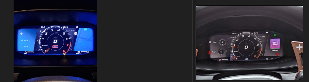

Dear all,
I'm looking for a way to change the lateral menu black instead of blue. I find the option: module 17 - adaptation - display depiction - version 2 but I receive en error 31. Somebody with a cupra could please help me to read this value in his car? thanks in advance.
KoNG
Jul 27, 2016
528
116
London
Same here I thin this is not supported by the cluster HW as the early cluster had different hardware
