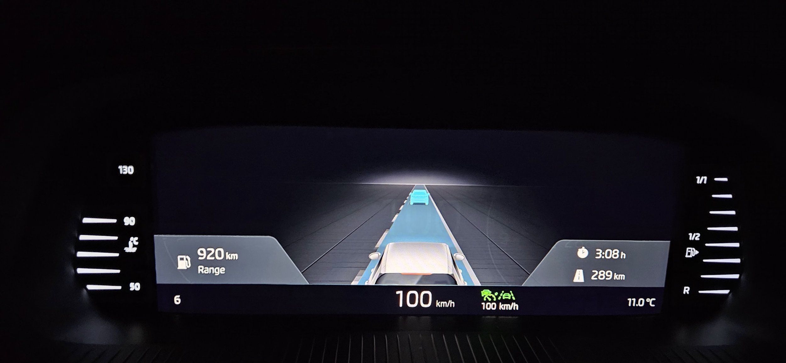

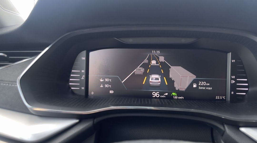

Hello! I have an Octavia MQB Evo (NX4) and I activated the travel assistant. But my car does not see neighboring cars. Although there are many photos and videos of his work on the Internet. Any ideas?
Only on highway. I have the same on Leon. Na autostradzie A4 i A1 jest ok. Dwupasmówka S1 już niestety nie.

How does the car understand that I'm on the highway? I was traveling from Poznan to Warsaw.
Do you have built navi on your O4 ? maybe he is reading from the navigation whether you are on the highway. I don't know. For me, as I mentioned, on A4 Katowice-Kraków and A1 Żory - Częstochowa it works well.

Yes, I have Columbus. I'll check how the car drives on other roads. Thank you.

And from the rear and side off the car you need Blind spot and auto park assist
I have only park assist for now. I have an appointment to remove the component protection from blind spot radars on March 6. And one radar has bad firmware. but this will also work for me. maybe with radars it will be better on a regular two-lane road. Ot only highways
