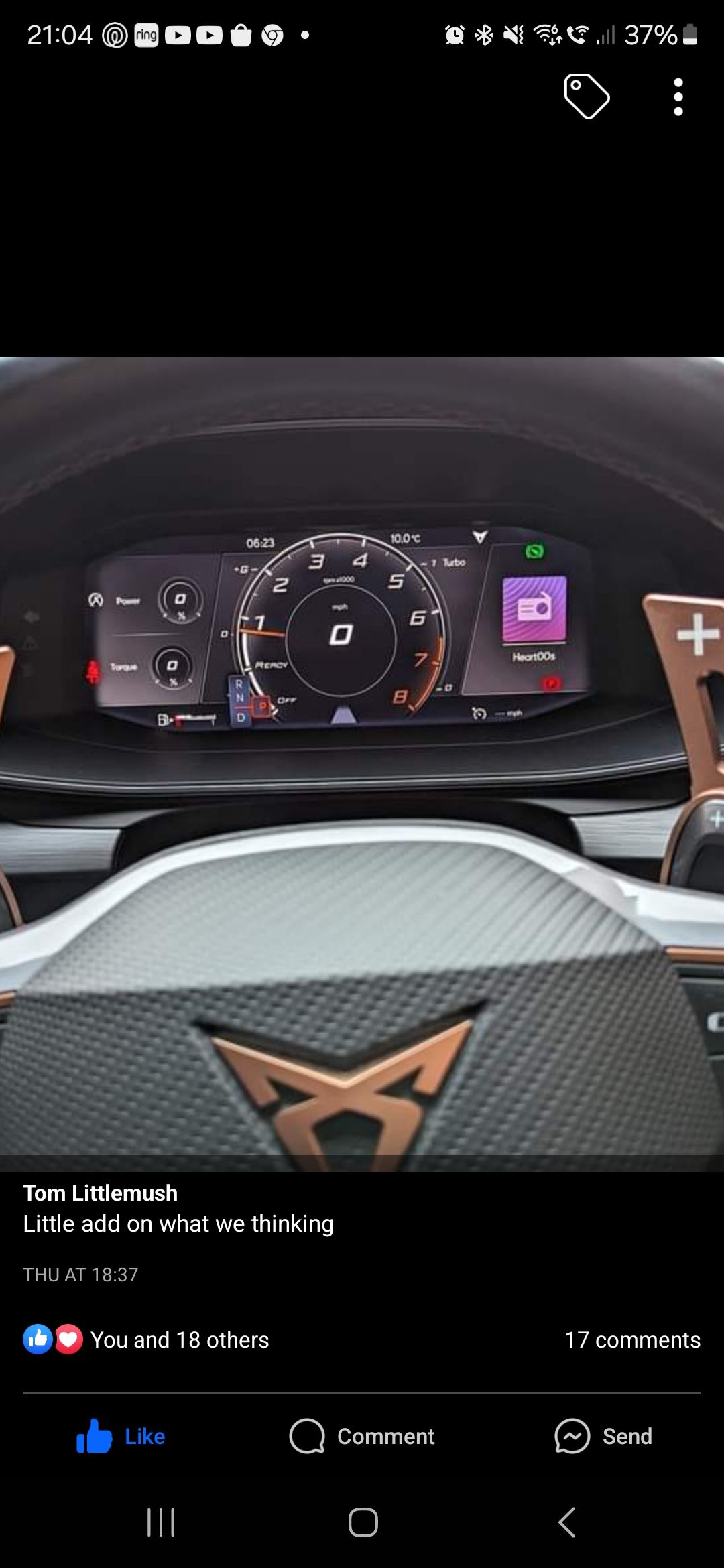

Anyone know how to code the power and torque screen in ?
