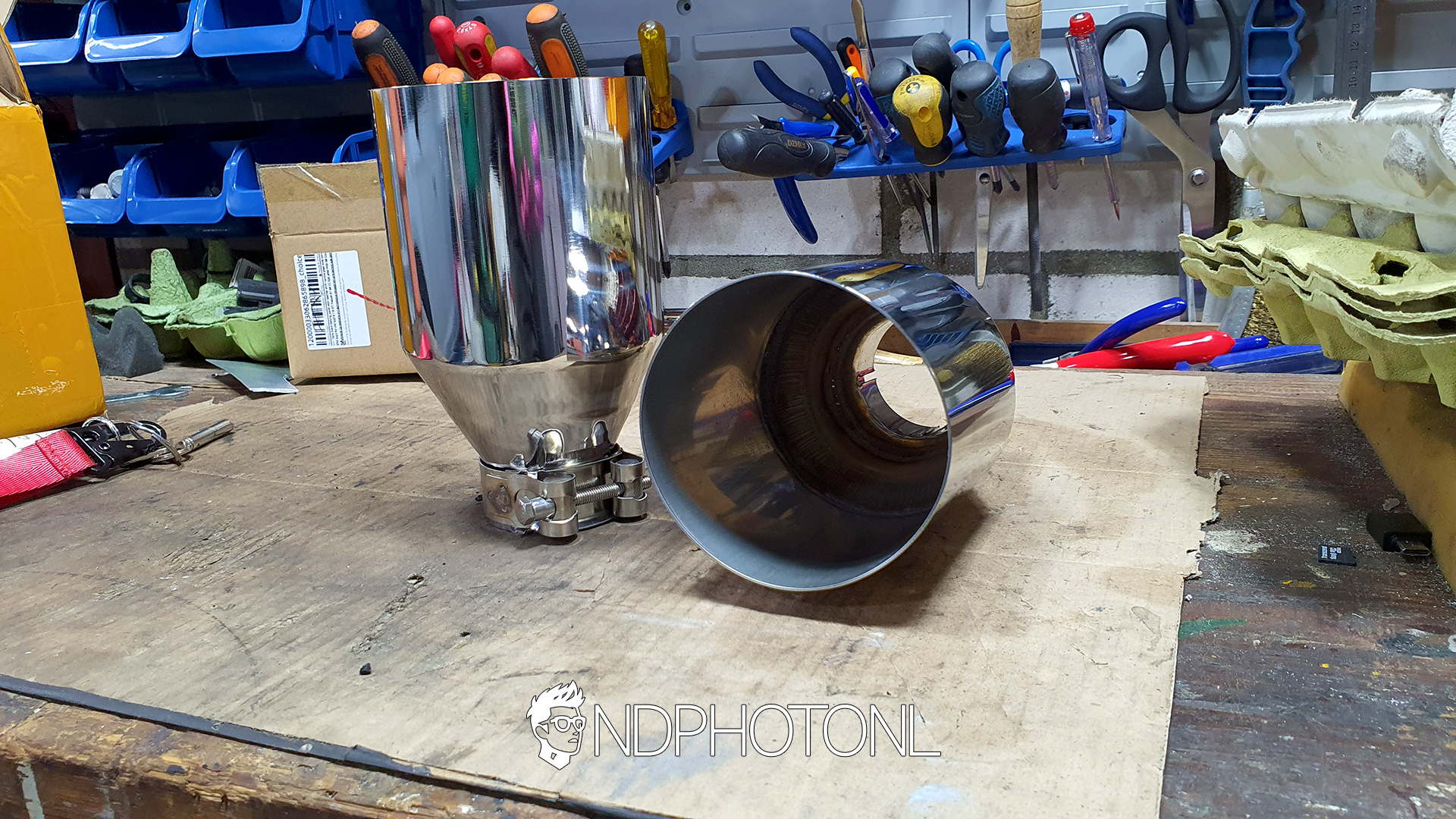

As I mentioned before, I wasn't totally satisfied with the oval tips. So I went ahead and took a little gamble on 2x round 101mm exhaust tips 😍 I was inspired by the Golf MK8 GTI and they worked out great!
AP1GczNaT1oyE5ysKOGIsmfWgKzliQqdmPKZjQSTM5wdzSQeHBTuw1waAQSB0CK5JS8EVpFifMDcoXJUY6a651uZrcIdStypgBR-fhlW_5IHTMOUc7eG91Pq-u5EH3ix9PU6-Xg3YEdbaDRqT_l0pHvi4Jawzw=w1920-h1080-s-no-gm
Fisting test approved 🙊
AP1GczNUJ4BmcEwhCsQ01qMszKgO-Jyu4srTZl_8RrwRHP4ch8AKJQYXXAOd_kxYcbXtu3vag0dfWaCVbDXLEsENlpCumLfUxYSj8It7xkNp2ntoEXjshvIjHGa4x-p4DTUL6LUJwrDdmBblpte26OUZ7wmY_w=w1920-h1080-s-no-gm
They are massive
AP1GczPRg548-yIsul8HK-X5xlkLdrRZ6FojsXTPHVS1OuM5NXNwIP2dJmOS3bW5ZXCNHmeP0dSfl5yFGdxXPIpZmgmR5PiQy1vLDldKOmaNs2RVev3Z6yetgz1WAaQEnR3P_Y4V7MdO_4y5FOpnTNYNXTrCug=w1920-h1080-s-no-gm
AP1GczPKxscsJ7iCIHae3accc3JtfkfMVbLUvKMozVueARoXl7GbUD6ji0-MzQJlIBMsZUjOPClV8uWfQbDL8k5UpVI8EkeZZ8wpPBLcQglDInLkpO6mSXWyQdcghICONnBJ7Q6y9Yt56tQrdZHqjpwVW5StWw=w1920-h1080-s-no-gm
Quality is nice, but not perfect. But at this price point, I am not complaining at all
AP1GczM51XZ5CNtFF0EhVCyOoWafLGVLBU1jeb-Fbb4nUrXZXwz0r1Tta1QWBtGM6GfldqwWopt96Qnff8E3lgnIlSMKbtkI8xaOz_1t6OAtHr_nsWriUWjnOGBBPAQBwABvaGH9R_OVkenYMrlbemFKQTwSew=w1920-h1080-s-no-gm
AP1GczMO1RsGuxaJ8xlKBjc_rCWt9R0yZfPyTF5KmGLir-gUz1or7Iu1tBFJhtOVRhQFVIpcQhmsgVLw4F2omkzvlXCUyzdPvhXeAsxz4J67Ufy3sEc1fEXr2hLRVfA_WDcubXu-qVsTJzEhyUiOIWmtNcMouw=w1920-h1080-s-no-gm
51mm inner diameter for the inlet side (ID)
AP1GczMG-MLACx6Uotzz7pDddHKKoyEObRrywAPAEg94MTHXURwU03nWvghHFM7YVHwYLPR0_hviU127-fOBhIs14MjaQQD4LMg9Lf26iUfkywbeNdT9goCEpDDaoeOKy6qt-IF_hxJ-Hg_wewC4rrBBzyQHjQ=w1920-h1080-s-no-gm
99mm inner diameter for the exhaust side (ID)
AP1GczOkcopADCb8gyDt9fGZqYnPNesrlFhEqZ56vp5Y3RN4P__V4-EgEZ459I-zCvSzl9Hk5wYaAm95o-IYWg4IXHBBbfkic_ZqaGAeZNSM2Vc7cxB8wJwuY30Hzt_2VG6h-D8xG3PBR59-kTkFY3KC7a0EHQ=w1920-h1080-s-no-gm
About 17cm in total length
AP1GczNS8QMvuCRwV7OO-lgJPIPcAe7w9jG_JeYcXnpeO4KHAwZxEIaq9NSAPa06HAfK-GguVXZXLg84yZF9m5Vxq9QCYfBVz9_Q6L1iKa-aMD3Qoo1sdwqODsWmxn_zxwyoiPjFqan1B7NGQxX2srgkAbVSKA=w1920-h1080-s-no-gm

This was more or less me, after fitment :rofl:
Happy Little Girl GIF by Demic
AP1GczO4dCIxeHsA9oWEsC5xI_UfRINBfk9h1OlCnhMSZi9kjlqs51K9xL-JIUb2PzIHT_XYGk_r0Bid0nkkrpz_iTV9VyEEQHTj52SVsUSDoj2TiGgSCenBKJKaJk-aqgxxYe9nY53z6TkCKA9-OnZOD-cHnw=w1920-h1080-s-no-gm
AP1GczNuw_rlG1Konp71I74jHjMS9ZGAHf-1r-8xFUnTHkRKAWely1VugyhwJW4hvo4tcdlD0KEn6xDawTe5sbS3L6DvGJ6Jc5lPaLefxqkfjpBGwRYKAII9iGPQaG5j3xtfdHdYh8W3kCXD3Wt0wFdckiz7NA=w1920-h1080-s-no-gm
The inside of the tips need to become black. That will happen in time with carbon soot, no worries there
AP1GczP-YJnYHo0YAAwgxfB60nBPgqtm2HNwhFH1ymYXVpJNgnOzZyp-HyBvpjODRUTGUDqnmk_od_4dYhWDXIlp4TIBy7fUGdHZaLudoMX6z-P4PmnMSs6E6AEfNSNiDaHJuAWApqx7-jZqp6fJ6ozYiOo8qA=w1920-h1080-s-no-gm
I think it will look even better/more aggressive with the Rieger Tuning diffuser
Robert Redford Nod GIF
AP1GczNkPyxT6XKxAGU7gAkcqUHPezrILDqU_y2XsvUrq7IZtTGz59vUKclVA2frxR0GfmOMkEIABu9LGPBQQHo8QrADGRS0KYQar24VQenT0hRCaaa86ENYsP4oH5OhqMmDIZ5DwLk2Lu3MVVzglqnzStX3yg=w1920-h1080-s-no-gm
Looks even better in daylight hehe
AP1GczMdsz558r0KSJCR8VxjIEgWj41cLomcHlW3txyaB5ClchI7dxxBnUqXStPAT4lwfiWmxlPUYponD-h_Mikvnkq8E2jmxx5bHrz4VDQbzdQ-t4I28QuAIm_Q7h0a-OZYmnmYcMixRw57AtMT3VaLnccBFA=w1920-h1080-s-no-gm
