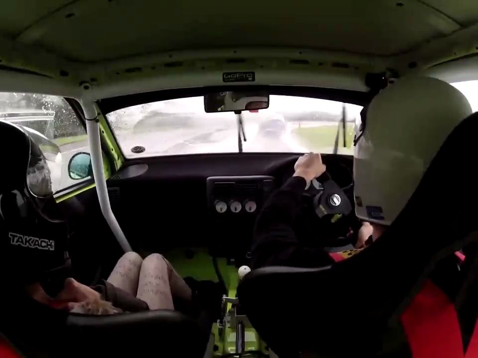

Because it started raining first thing today I actually had a chance to fit my speedline comp 2's with Uniroyal Rain Sports
Really impressed with the amount of grip I had from these, the track seems grippy as most were commenting on so not sure if the grip I had was due to the tyres or track but I could throw it into the corners like I was in the dry.
Here's a load of photos from the day
