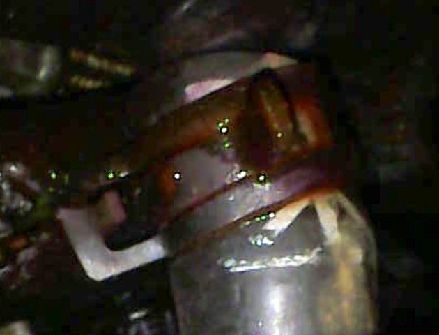

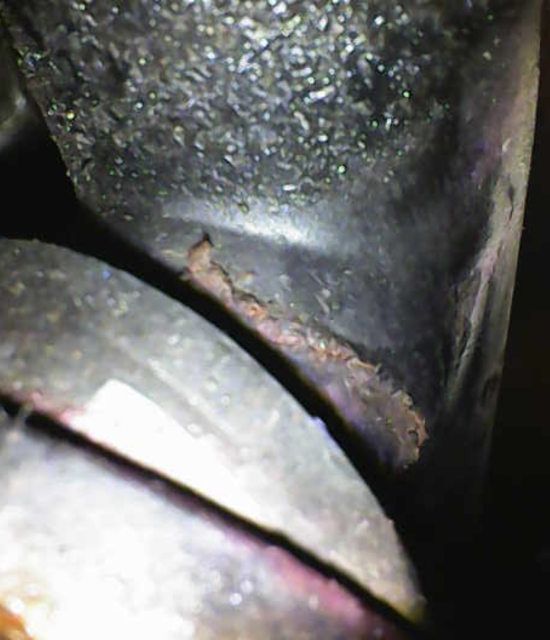

Oh boy, not happy with my garage - the pollen filter shroud hadn't been fitted correctly at service - so one soggy filter and a ton of water down the air inlet.
After the torrential rain of the last week I noticed a sloshing sound from he passenger front area - I had to go though a couple of flooded areas recently and was concerned the noise was related to that as the water was a several inches deep, but I'm worried the water has bypassed the blower fan and headed south. I'd noticed within the engine bay a lot of water dripping on the firewall from what I assume is the aircon condenser down onto the subframe. Carpet seems dry on top at present.

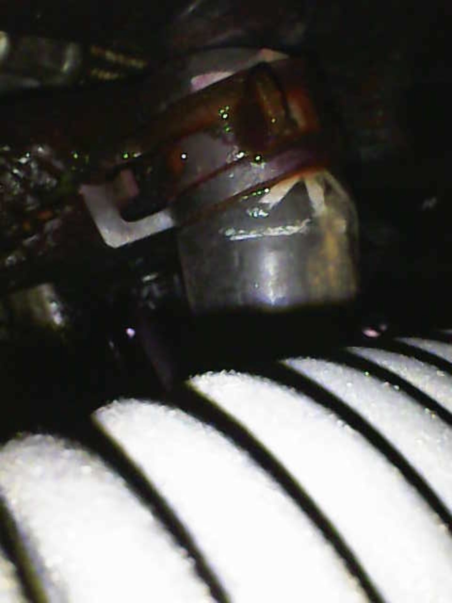

Second find was what I hope is the cause of my coolant leak - thanks to an endoscope camera I'd acquired for another purpose its great for thos hard to see places in the engine bay...
So it looks to me that the pipe isn's seated correctly and the retaining clip is way off straight allowing coolant to get by and ooze out. Rate of loss is about quarter of a litre oc coolant every 100 miles or so.
Thankfully I'm on leave this week, so if weather permits I'll be removing battery and air filter housing etc to get in there and set itall straight.

To be fair I've had to refit the pollen filter three times before and only the third time stopped the leaking and I have no idea why!
That clamp definitely looks wonky

Managed to get in there firstly with some long nose pliers and alter the clamp by rotating it so that it faces upwards. Once done I got in there with some bettergrip, reseated the hose and feel happier... however...
I found the coolant was dripping onto that hose from above from one of those black electrical cable protectors with a fairly consistent drip every minute or so. Tracing it back it seems the coolant is weeping from the coolant flange that holds the coolant temp sensor where it meets the cylinder head, looks like it drips onto the hard lines that share the flange mounting, then the drip transfers to the cable protector.
New flange and o-ring seal ordered as being plastic I dunno if its slightly warped or just the o-ring gone.
As I need to replace the radiator fan switch and wil need to drain the coolant I may as well do it at the same time.

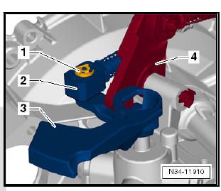

Also found the upper gearbox cable it missing the clip that holds it on to the gearbox selector - oh the joys.
I'm struggling to find a part number for the retaining circlip - the yellow item #1
@Thai-wronghorse - do you happen to have any?

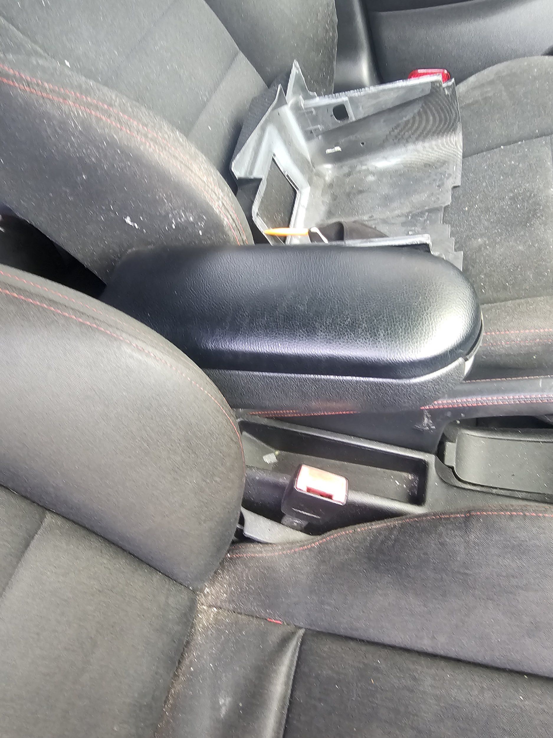

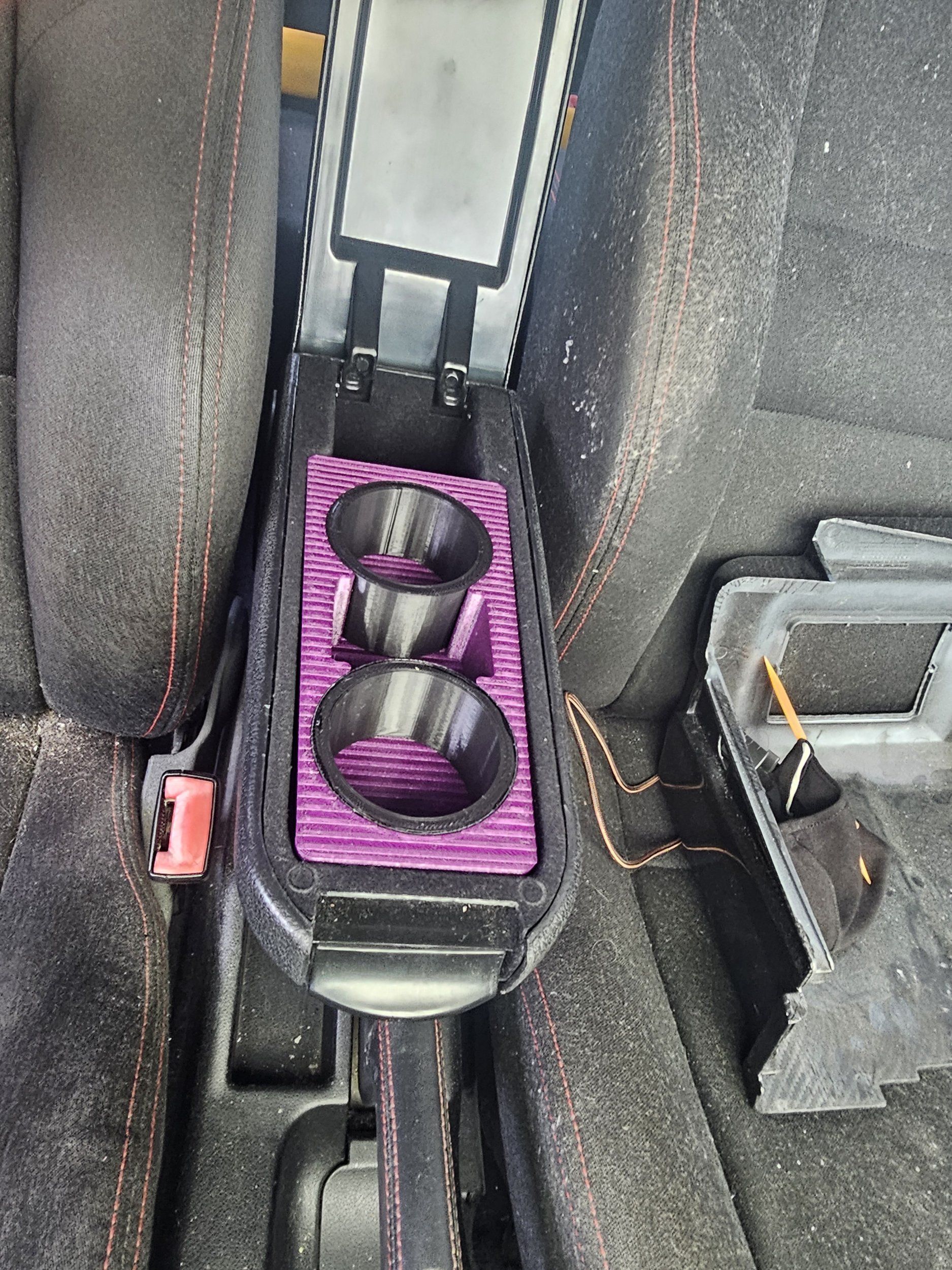

Hi all, I have not made this. But someone who did, the inserts firmly hold a 250mm redbull can remove inserts for coffee cups and larger bottles. No more dreaded drips onto stereo lol. If interested just comment below.
Also forgot to mention it's a nice snug fit into the armrest, and he does many colors and the best part was this cost £15 with delivery and I think the inserts as well, as I asked for them afterwards but I'm sure they are included.
