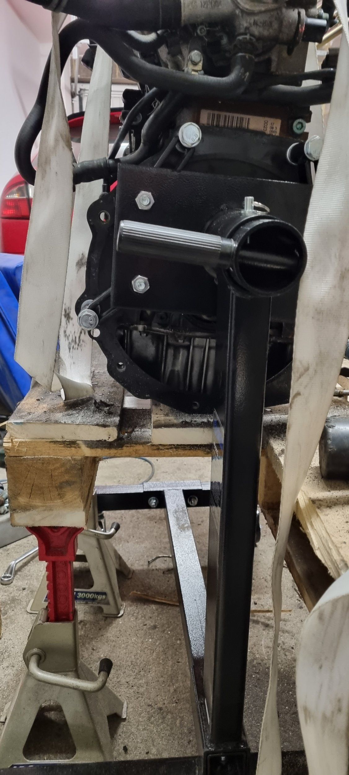

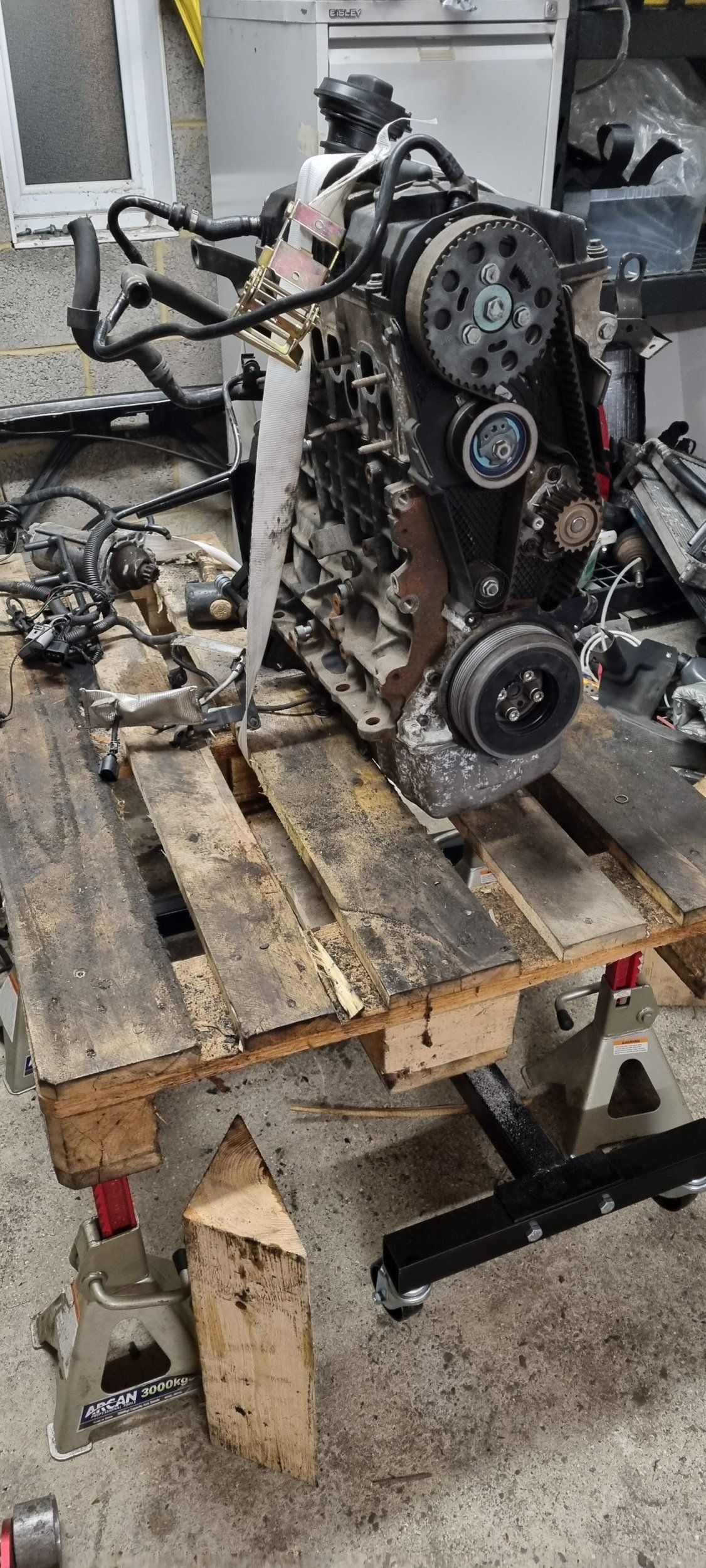

Yeah, I keep looking at the photos but I still can't work out how you did that.
Ok, so here's how not to do it:
Strap the engine down to the pallet
Use a suicide jack to lift it up high enough to get some wood under the pallet
Keep going until there's enough room for a trolley jack
Use the trolley jack to lift the pallet enough to get ratchet stands under
Lift each corner of the pallet and raise the stands
Repeat until it's almost high enough
Cut out part of the pallet to give room for the stand
Bolt the bit you need to bolt to the engine
Raise up the pallet as necessary
Kick s#*$ out of the stand till it goes on to the bit that's bolted to the engine
Lock it together
Undo the strap
Kick out the jack stands
And hey presto, done
Reactions: iammooks

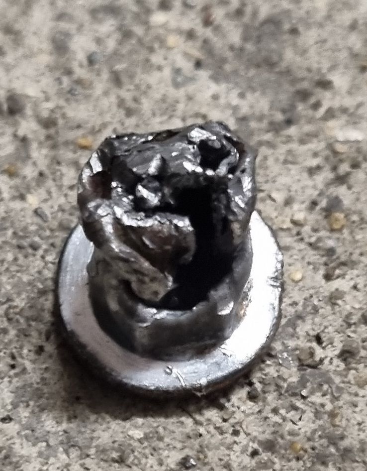

Just finished sorting mine out, totally rusted so the whole thing just span, it's gone through MoTs okay but just wanted it sorted.
Ended up drilling/smashing the captive nut out, went to put a rivnut in but that didn't go to plan so for now it's an M8 with a nyloc nut on the clamp then a normal nut n washer. Bit of a faff but it works
The offending rusty hardware:
Reactions: iammooks
Yep - I recognise that twisted bit of metal. I realised after I ordered a new battery tray and the relevant bolt that I could have just done what it sounds like you did - put the bolt and maybe a washer on the underside, and tighten a nut from the top. I've even got some M12 allthread and some nuts that I could fashion something out of. Like you, everything is secure even without the retaining clamp, but if I can get the parts I may as well do it properly.
That's the second time I've had a bolt get stuck partially undone - the other time was when my offside rear lower shock bolt seized. It only got jammed when I'd undone it about a centimetre, so I'm more annoyed at myself for not wire brushing the thread and putting some penetrating fluid on it and going straight for the hacksaw. That's always the worst thing about jobs like these - I make stupid decisions when I'm tired and normally a bit emotional that in hindsight if I'd just taken a bit more time over it I wouldn't be in this situation...
