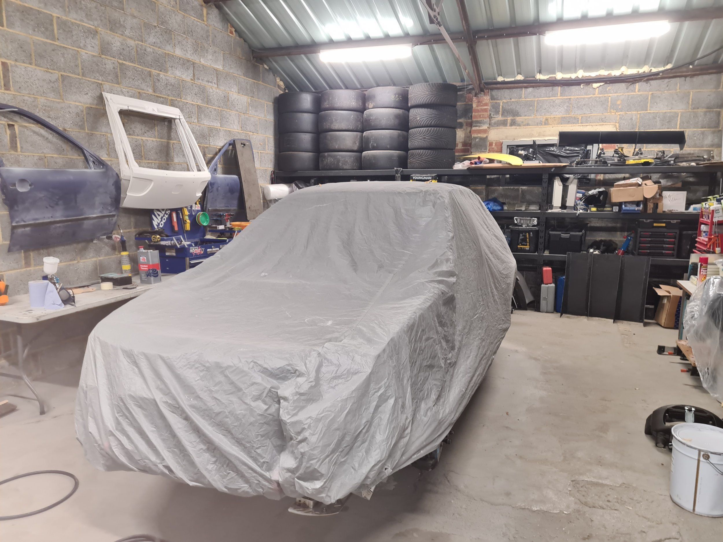

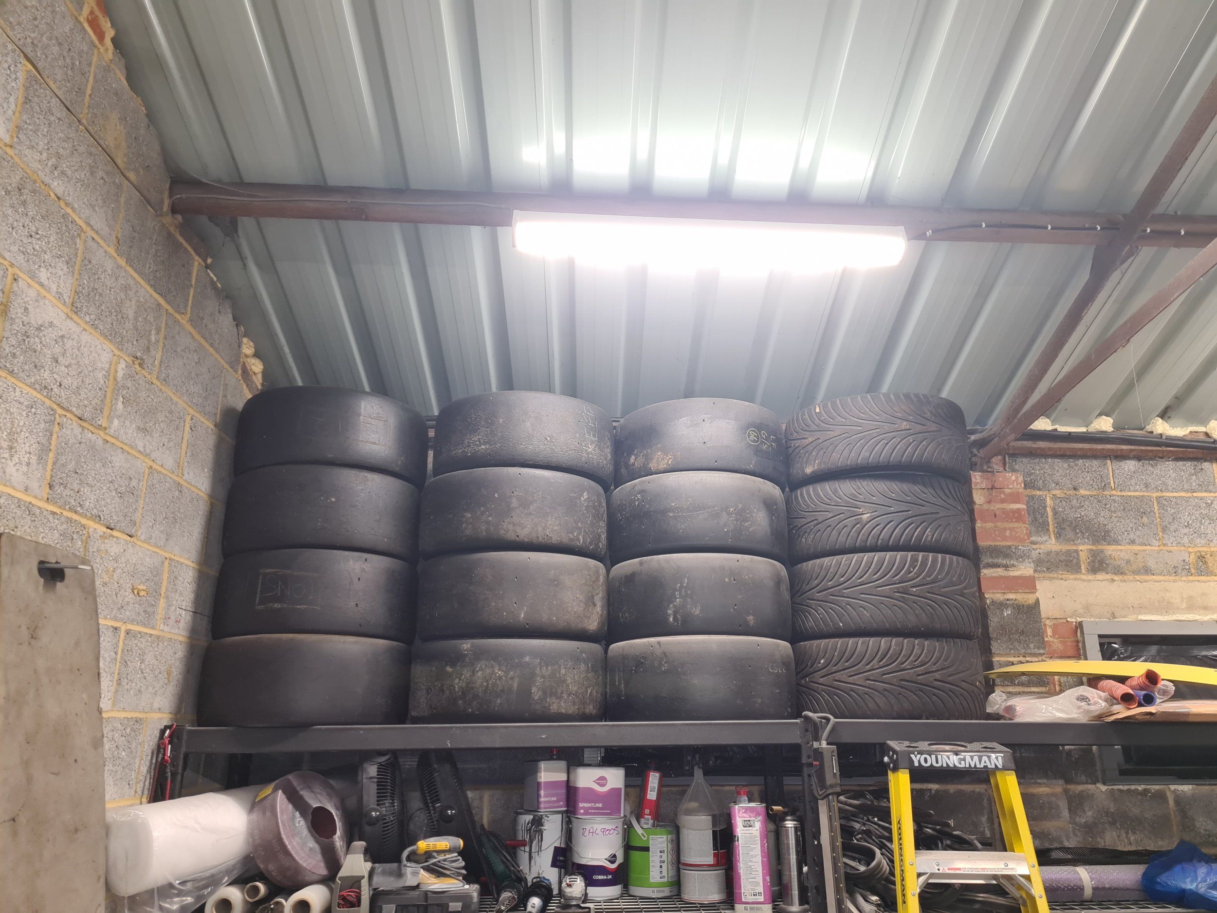

Lucky you guys, I’ve not even got a garage so all my work is on the drive
Drive? I have to do all my work on the street.
Not in that way, you filthy beggars.
