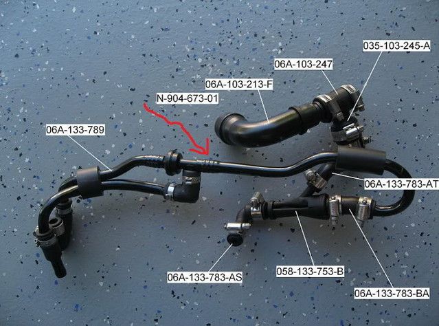

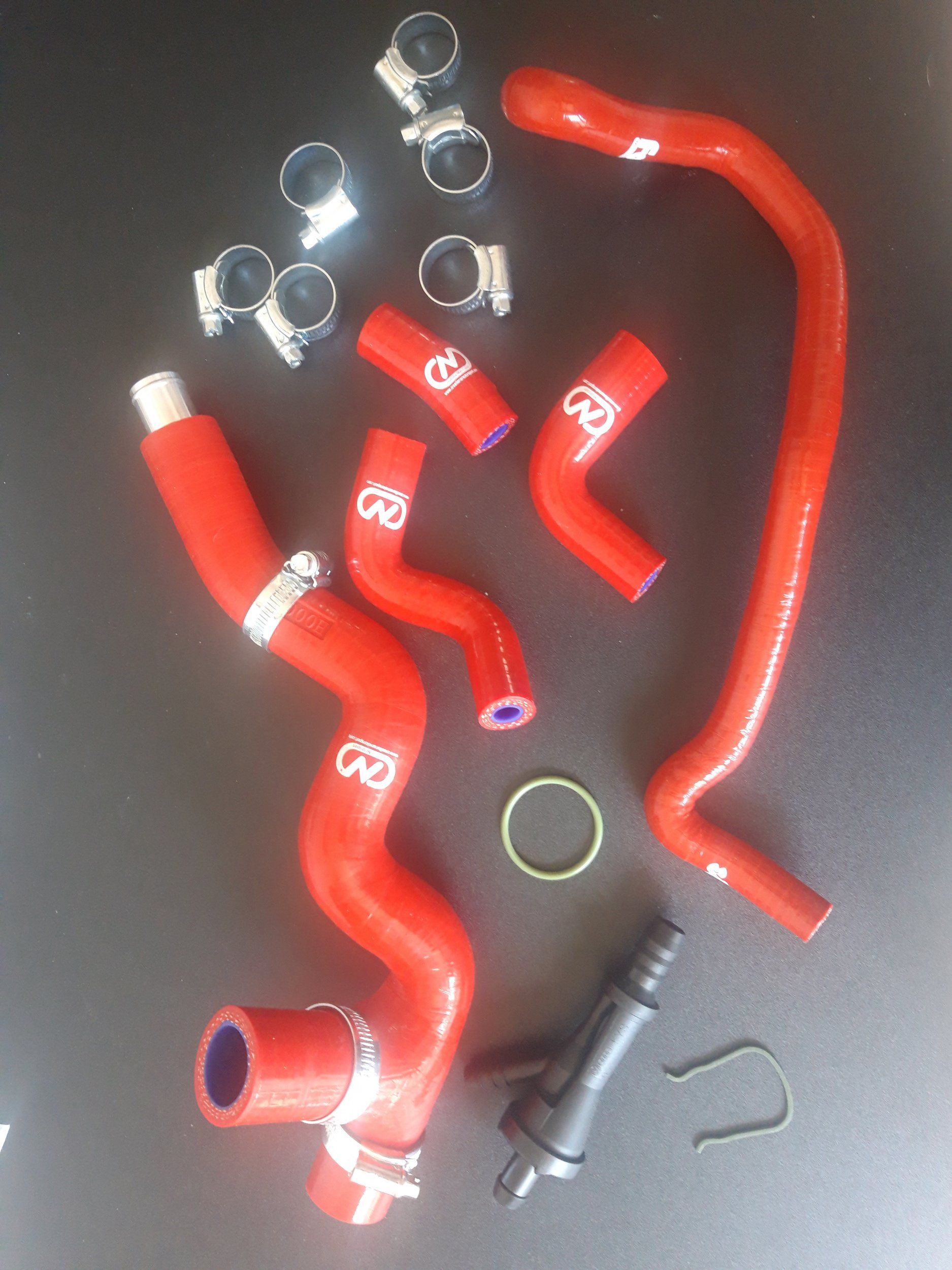

Give Creation motorsport a ring. They sell silicone versions of the PCV pipes.
welshy46
Dec 6, 2015
37
44
Maanchestorr
Does this help? Part of part 06a-103-247 which is the big fat pipe that goes from the elbow out of the crankcase to the 3 way pipe. Those small pipes are shown along with black valve thingy. check the part numbers on creations page for the part numbers they replace. You also need a PCV check valve. My head hurts now and I need to lay on a couch and look at old things.
Reactions: Rich.T

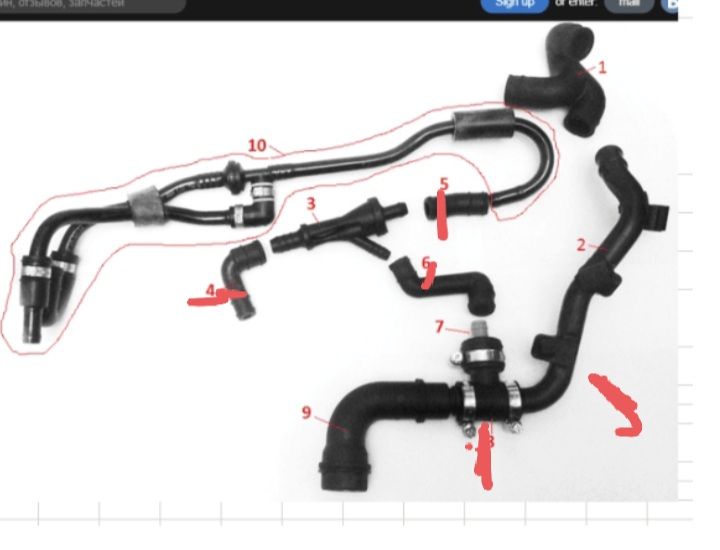

Ok, i built the pcv pipework together as i remember taking it out in 1 piece. But soon realised id have to refit it in 2 or 3 sections.
Nothing fitted well and i found myself having to trim the hose with the built in T piece. I trimmed it where the right angle section from the block goes in and where the little valve goes in. Fitted what i could and found some parts pressing up against the underside of the manifold. So trimmed some more. Finally got it all together to find the pipe that heads up to next to the rocker cover, A) resting on a coolant pipe B) at a crap angle at the top.
Pulled it all out and plugged the catch tank back in.
Im going to order the oe items when ive finnished typing this post.
Items i need are marked in red below. Then everything should fit as SEAT intended.
Cheers Rich
