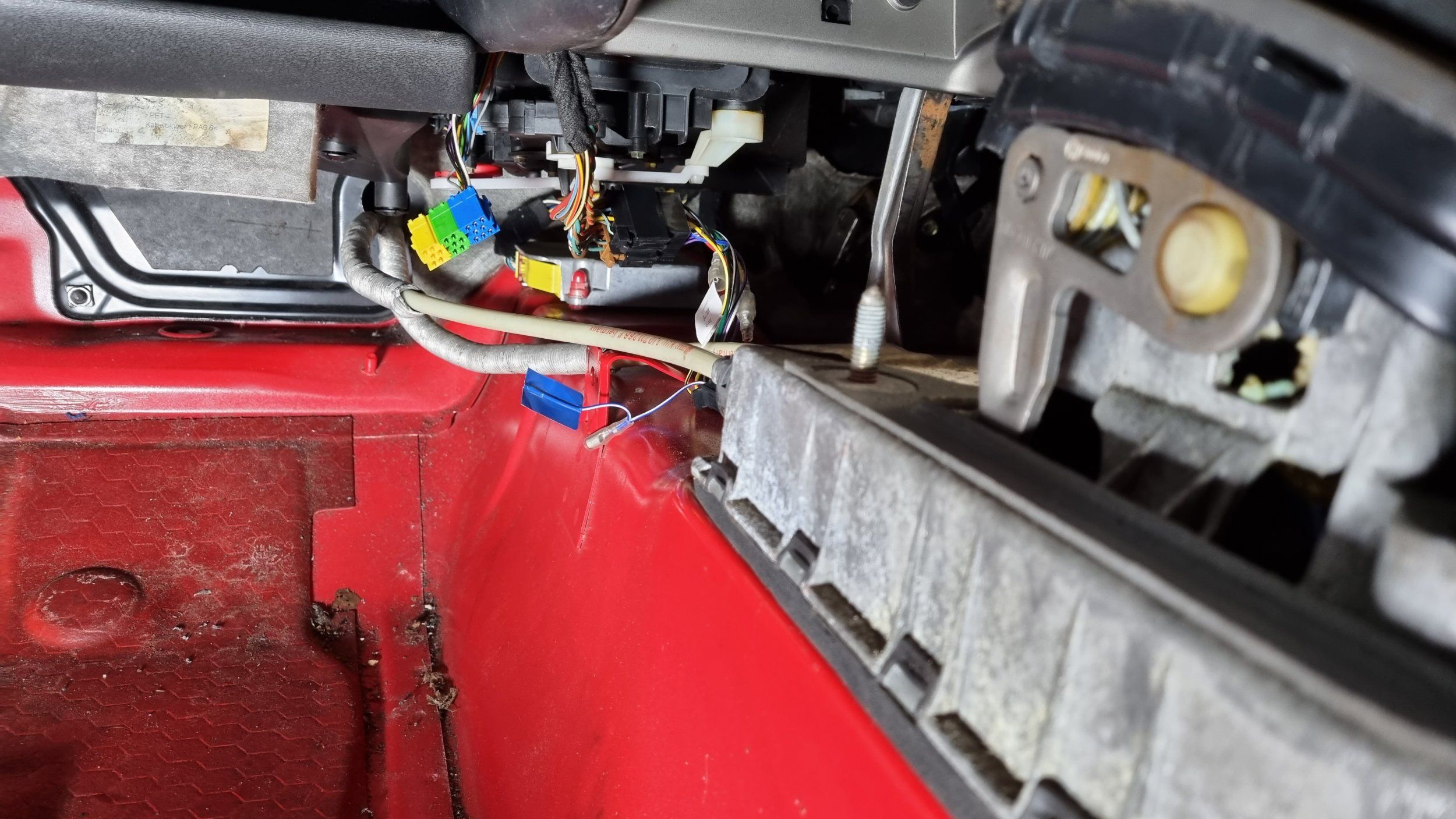

Finally got rid off that warning airbag light. Dismantled the steering wheel, the spring clock dongle, cleaned and sprayed all those connectors. Put it all back up and checked for airbag light. Still there but now VCDS was a buddy and remembered me why it was such a good investment: scan it, erase it and its gonne. No more yellow light on the dashboard. Ufff.....

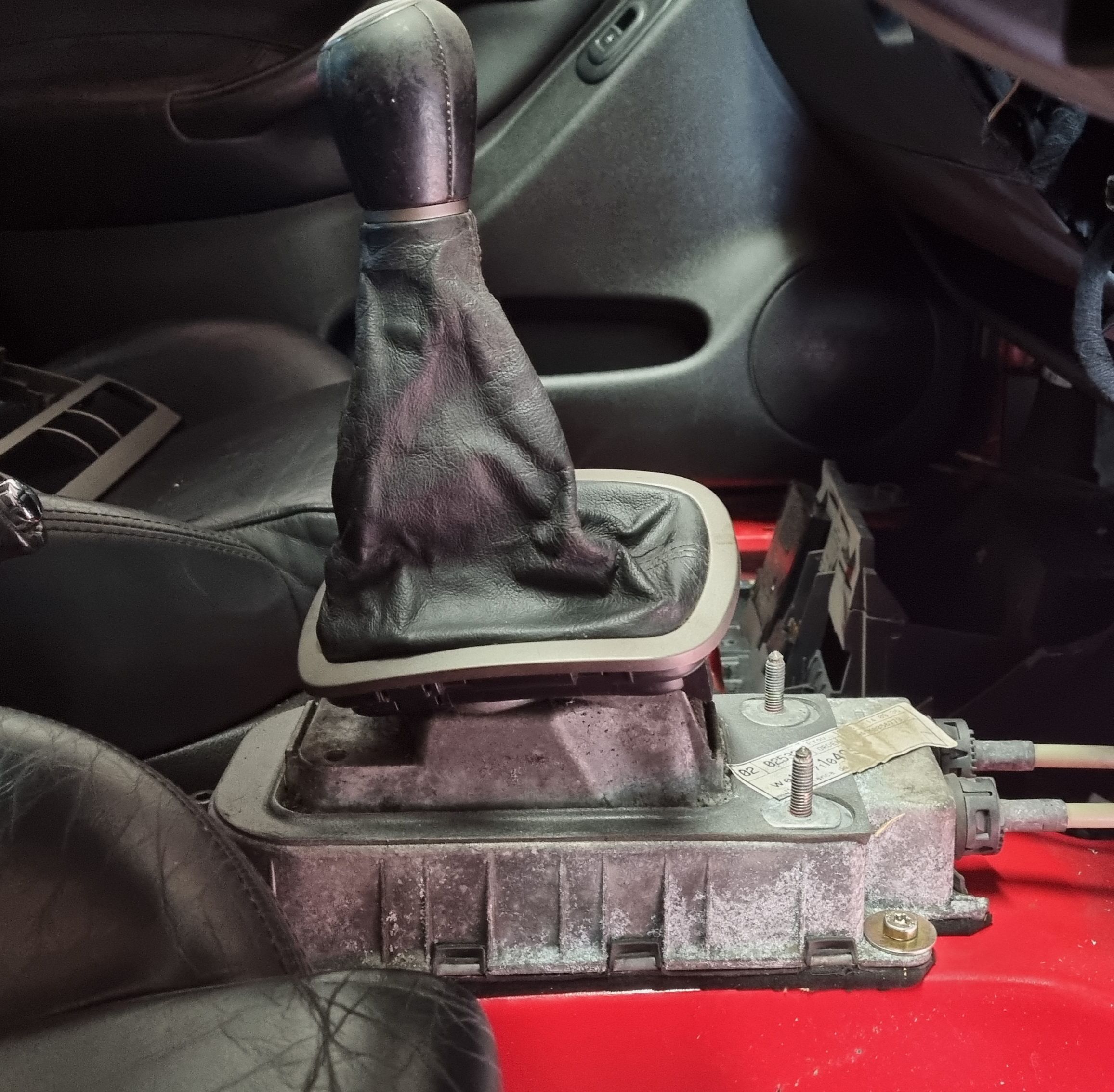

Normally the shifter box is mounted in the tunnel, have moved it to on top. Just need to cut a hole in the bulkhead, feed the cables through, seal it all up, and put everything back together.
Just having a break atm as my arm is fecked (previously mentioned workplace injury)
MoToJoJo
Mar 25, 2014
847
685
Northants
The car will be doing track days at some point. There’s a few reasons why, main one is to get it closer to the steering wheel which should speed up changes a bit, it also means servicing it is easier as there’s no need to remove the exhaust centre section and the heat shielding to get at it, also gives a mounting point for some switchgear I’m thinking of mounting there

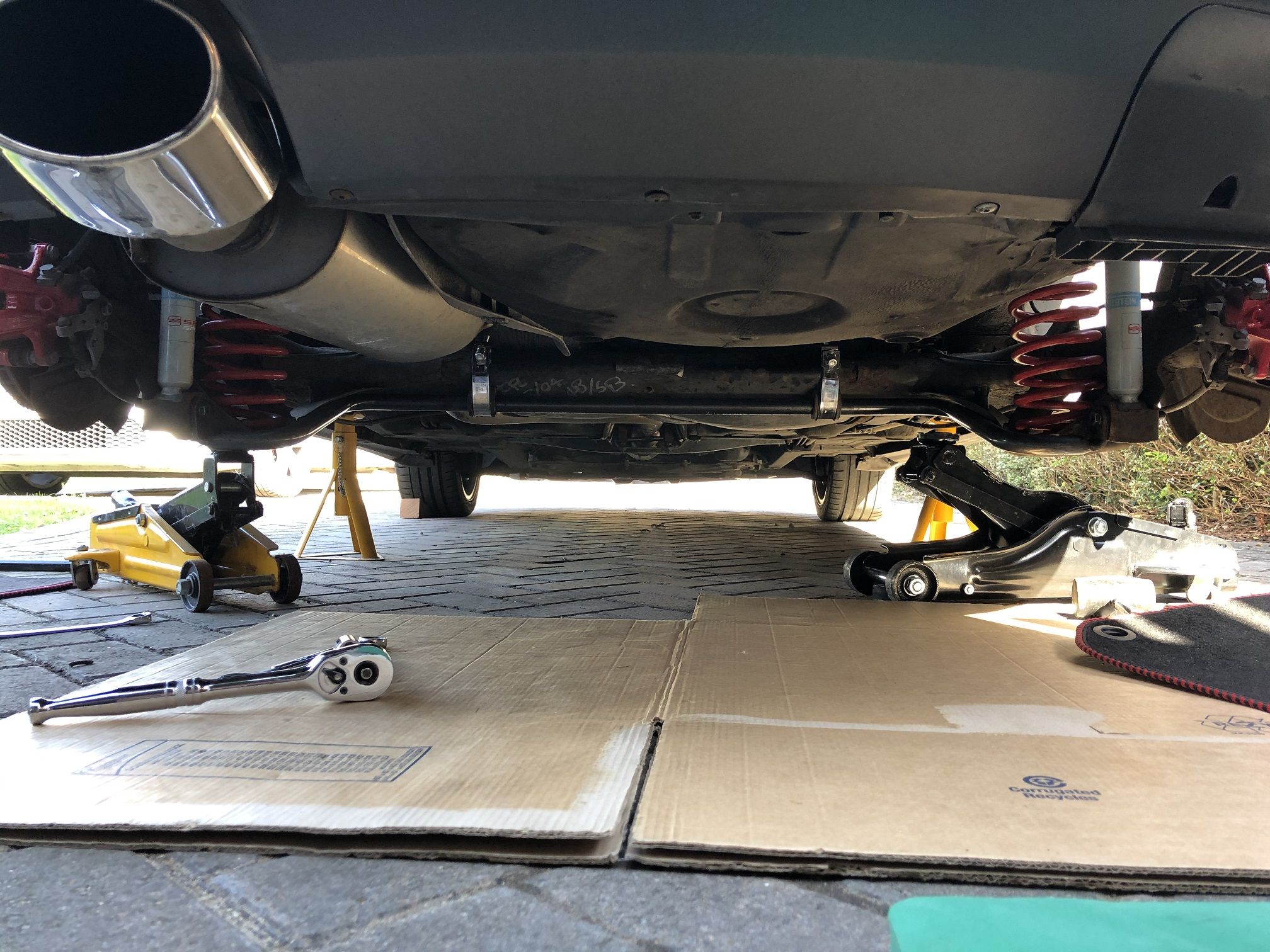

Fitted a rear anti roll bar. Thanks @Thai-wronghorse for supplying it ;)
The clamps going round the rear beam were a pain in the bum. I’d love to get hold of some proper clamps like the ones used on the neuspeed arbs. Anyhow, all fitted and all good.
I have the front arb too, but fitting that is way above my grade and I really don’t want to go to a garage so it’ll stay off for now.
You've got a very clean and tidy looking rear end there.
Good to see you've got it fitted it mate, yeah those clamps are fiddly when new as they're obviously not to the shape of the rear beam but once on they're sweet.
I've got the Neuspeed bar on mine and admittedly the supplied clamps with those are better but then they're also considerably more expensive.
The front isn't particularly difficult but definitely more involved as you'll need to drop the subframe to do it.
