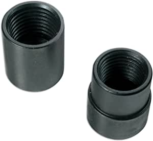

If you've got a security wheel nut and no key, you can get special rattle gun sockets that have an anticlockwise internal thread.
These chew their way over the wretched thing until the bolt gives up and winds off. I don't know if you can reuse them though.
Ebay should have lots chinesium ones that might be useless.

Like these which are basically bigger versions of the Irwin bolt extractors I own.
Well the 1/2 drive plan just stripped the inside of the bolt

Ordered a 2 piece stud removal set off eBay. Basically 2 sockets with reversed threads as suggested above
