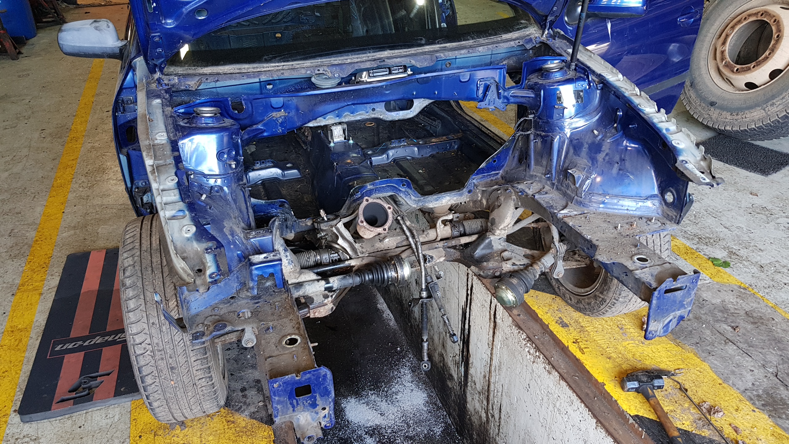

Searching for an oil leak and found this....
Another classic bodge silicone fixes everything.
Also found the turbo intake pipe was linked and half off the compressor housing so that won’t be helping anything.

It's like a white blue but more of white. I call it transparent white not thick white. Puffs when you Rev.
I've took the intake pipe off and the pipe is pretty clean of oil but the intake after the flap is filled with what looks like oil and petrol. Has the colour of oil but smells of Petrol. So I took the fuel rail off to have a look at the injectors and they look fine but I'm not sure who I can test without killing myself or setting myself on fire
Sent from my Nexus 6 using Tapatalk
Usually crank case smelling like gas means blow by on the rings.
To check the turbo you can take off the intake pipe and feel for side to side play on the turbo shaft, or take off the down pipe and try to wiggle the hot side of the turbo.
You could also have a busted PCV or CCV valve, this is why people go to air oil separators aka catch tank setups

Thanks mate, thinking about it...it's probably going to be cheaper just to buy another Cupra....or put a bam lump in it...not sure what I'm going to do atm as both will cost about the same.
I've done the delete and smoke comes from that. Vented to air atm.
Cupra r I don't have 800 atm.
Seen an agu for 300 in me, probably go with that.

But the turbo is only a K03 from the AGU not a k03s so it would be a downgrade on the turbo. Check your turbo out first before you go buying an engine

Found the intake pipe wasn't on right,turbo seems to be leaking oil, cleaned and tested just now and will have her back up after the beating she just took to see where the oil is coming from...sump ECT all looks like new now lol. Sai was hanging off lmao, attempted to remove it but I guess they just left it (removed now and all piping to it) boot pipe from turbo to pan cake pipe wasn't in right with the clip just around the pipe, had to take all the pipe work off to get it on and again I guess this is why they left it. Other than that the block seems very clean with no sign of issues. After putting it back together there was little to no smoke...but still some, not gone.

I see I’m not the only one with turbo problems.
I see an oil leak and a cross threaded bolt?
Definitely a leak somewhere mate. No not threaded just put it by a complete moron. Problem was pipe needed to be pulled down slightly and then the bolt went in nicely.
