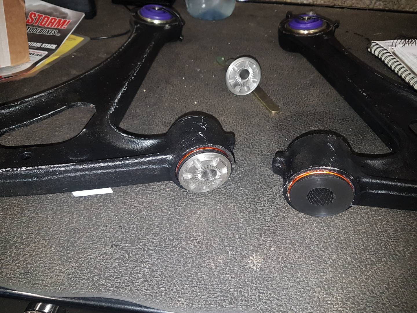

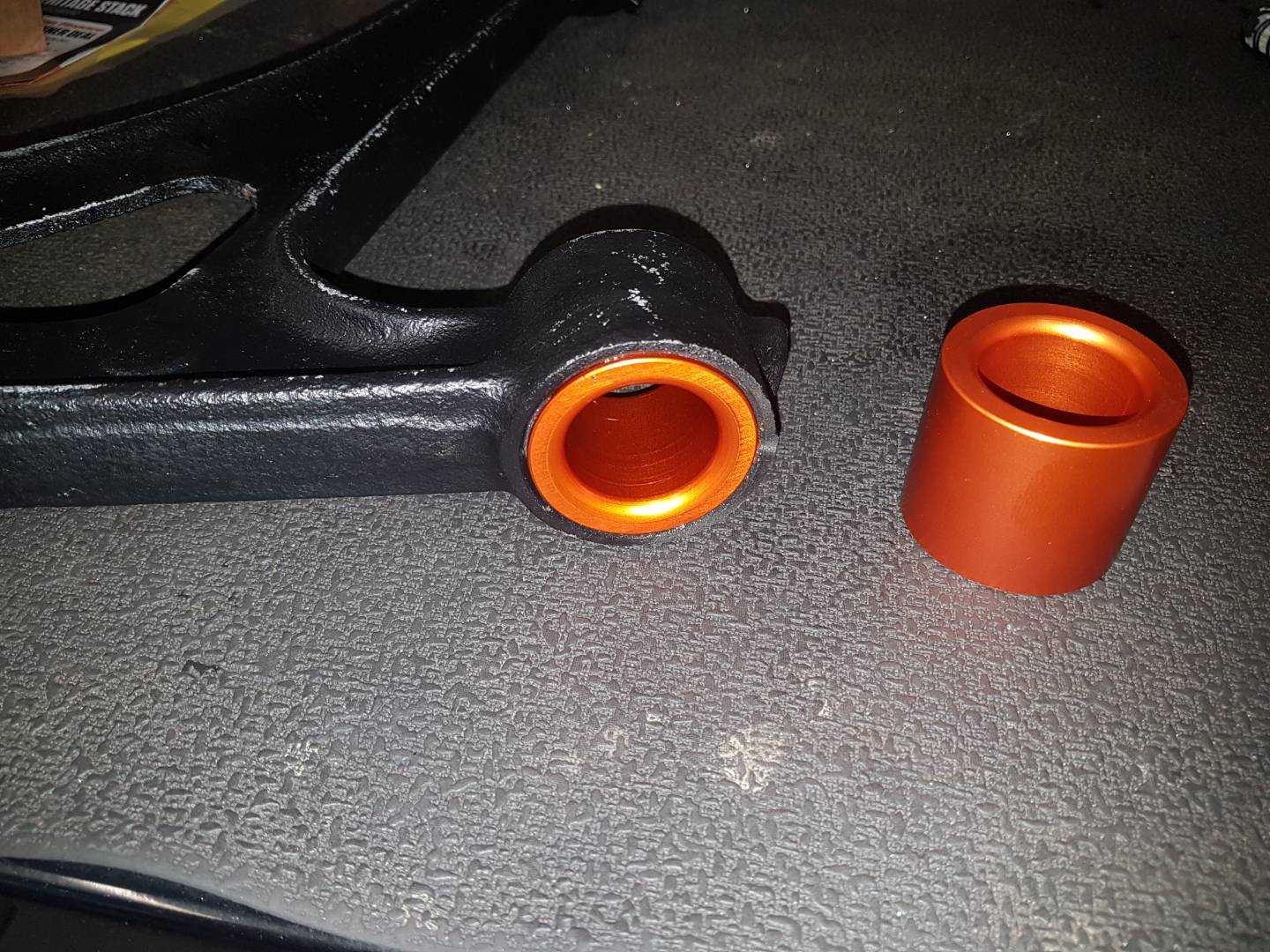

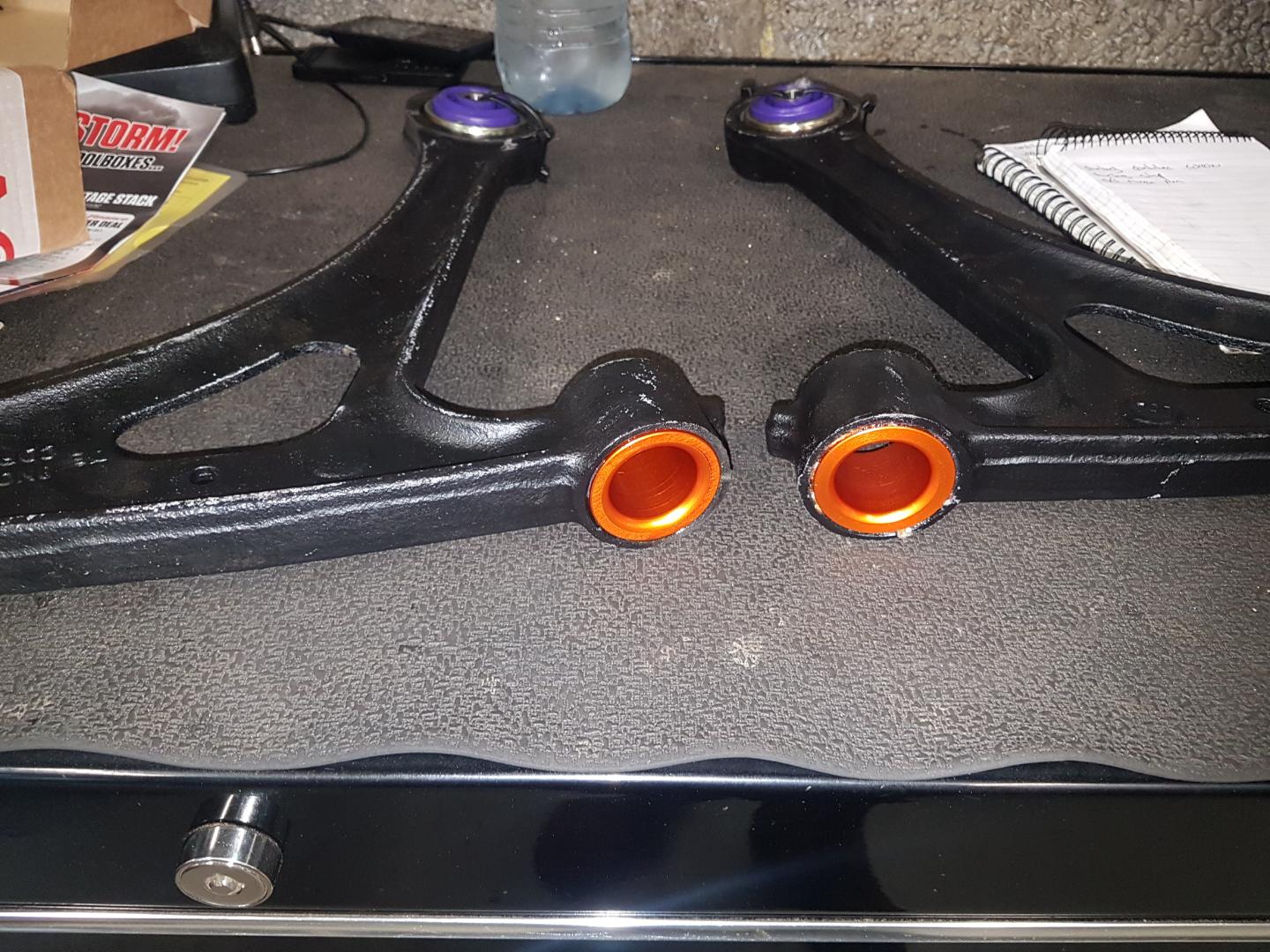

Quick tea break job
Fitted the reducing inserts in to the lower arms to reduce the size from 45mm to 30mm. This will help to reduce flex in the bush as well so should help stiffen up the front end more. So I can then fit the powerflex black series camber adjustable bushes and inserts.

Quick tea break job
