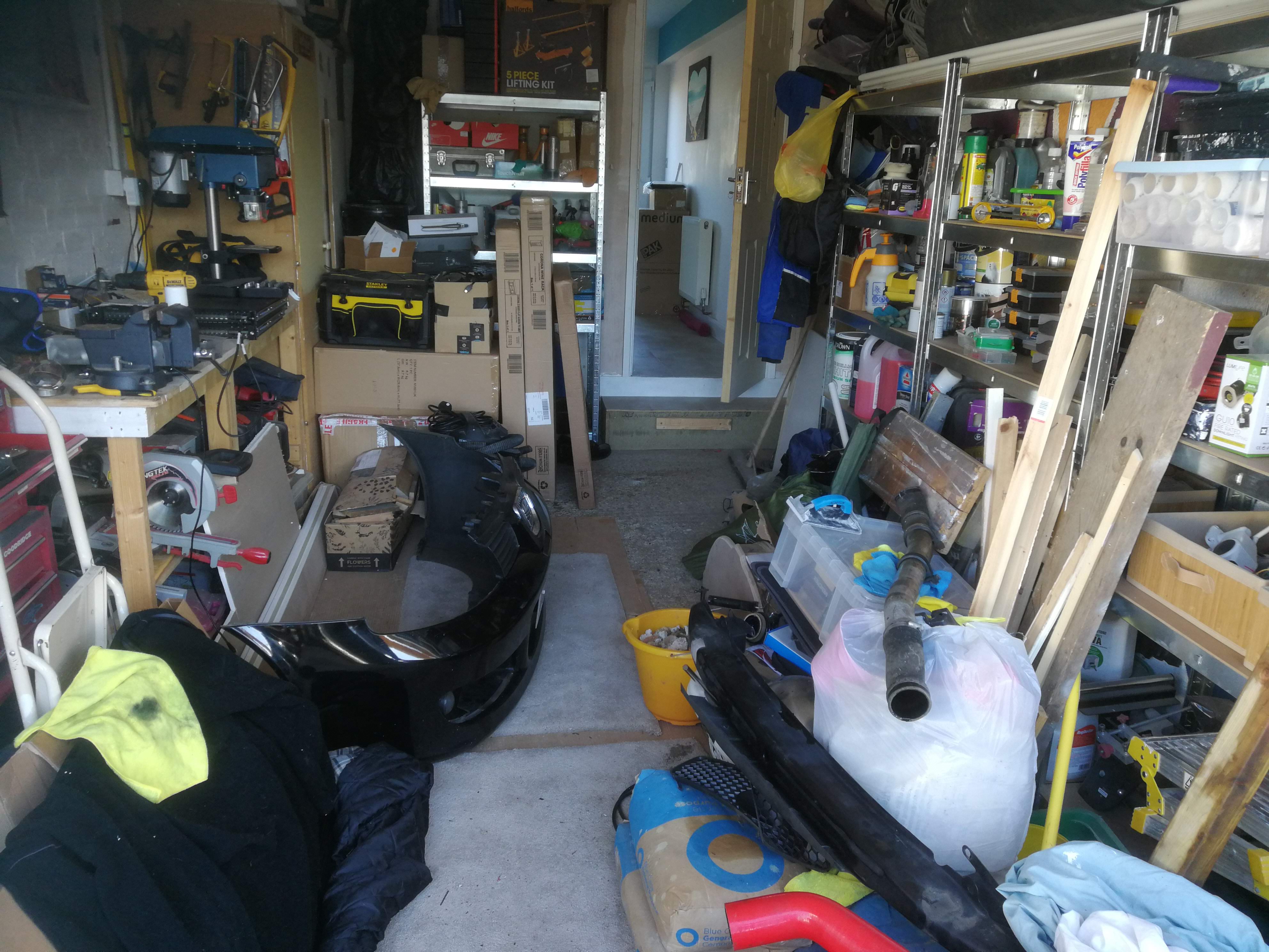

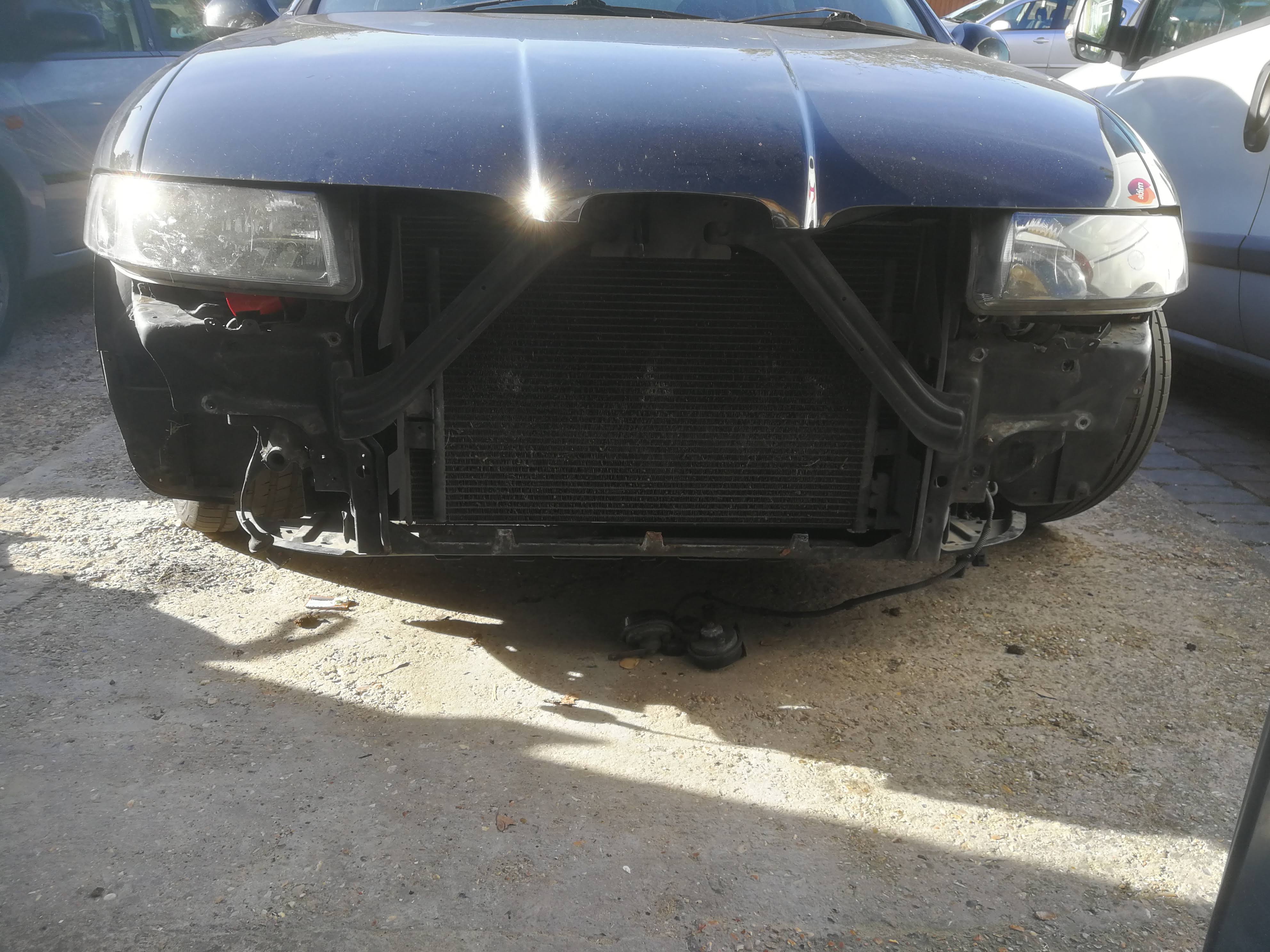

Started to take front bumper off but she stuck :(, I've taken all 6 clips off the top, the 2 bolts inside the fog lights, the 2 10mm inside the wheel arches....the screws on the bottom undertray. Its loose but just doesnt want to budge.

Funnily enough I was trying to get my front bumper off today aswell.
It’s never been sat flush with the wing ever since I’ve had it. One of the clips on the inside of the bumper nearest the off side headlamp is missing I think. I couldn’t get it off and I felt like it was going to do more damage trying to get it off.
In the end I took the front wheel arch liner off and managed to fix a small bracket to the flange on the inside of the wing and glue it to the back of the bumper using my favourite thing, gorilla glue!
Seems to have worked, I’ll see properly tommorow when I take the masking tape off the wing and bumper.
I’ll take the opportunity to give the wheel arch lining a good clean while it’s off.

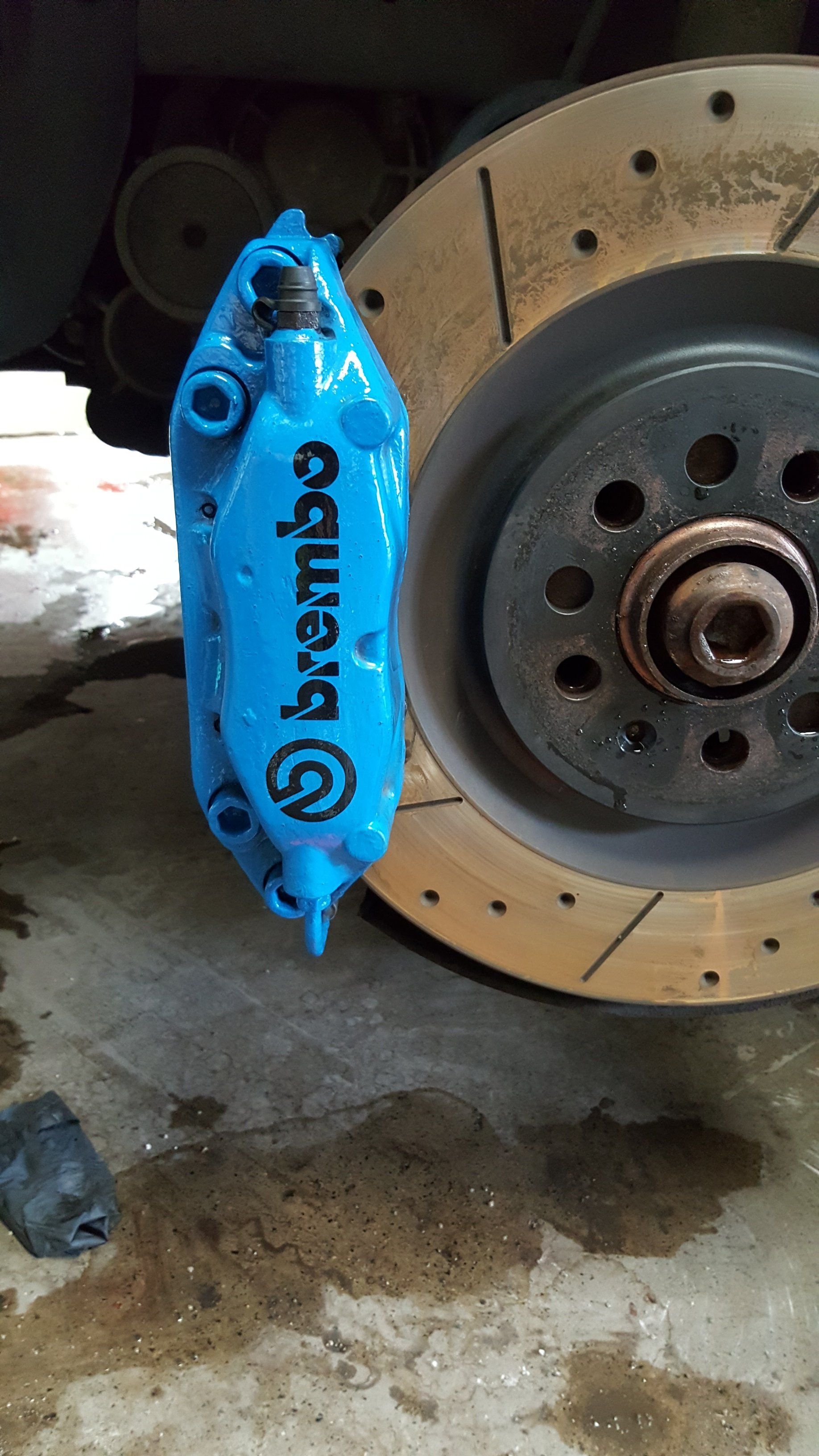

I could be in this all day at the moment. Car was parked up for a year and caused no end of issues ended up changing n75 valve, 4 brand new coil packs, full pcv delete and oil catch can fitted. But today is exciting as I'm in boxing the 256mm vented rear disc setup I bought from a mk1 TT.. And even better got a front set if brembo 4 on the way.
