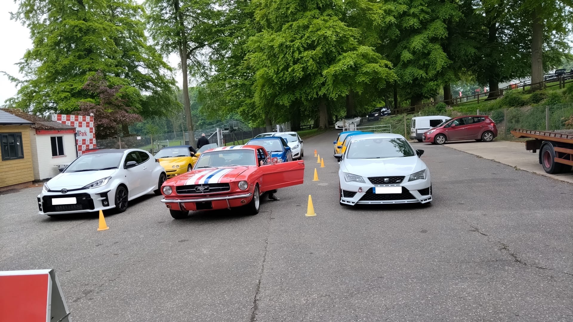

Took her to Cadwell park for a track day and had a great run out. Lots of very professional drivers so was a very fast moving and very few red flags compared to usual.
Some interesting facts from my day out (well to me anyway)
Set tyre pressure to normal (for me) level from cold and after a couple of very fast 20 minute sessions the pressures had increased on the front tyres by 4psi on the rear 2psi
DSG Control module temps for Control Module and Transmission Fluid were constant at 95/7 and 88/89 regardless of how hard or long I was out on the track, I have fitted an extras large aux radiator and this is defo paying off with regards to temps.
Brake Disk temps constant at 82 C on the rears untill I stayed out longer than 20 when they increased.
Fronts were volatile between 129 and 194 C dependent on how hard I was hitting them.
Engine oil temps (I have fitted an oil cooler to help) were constant regardless of what i did between 98 and 102 so very happy with that.
Fuel economy was 12.5mpg

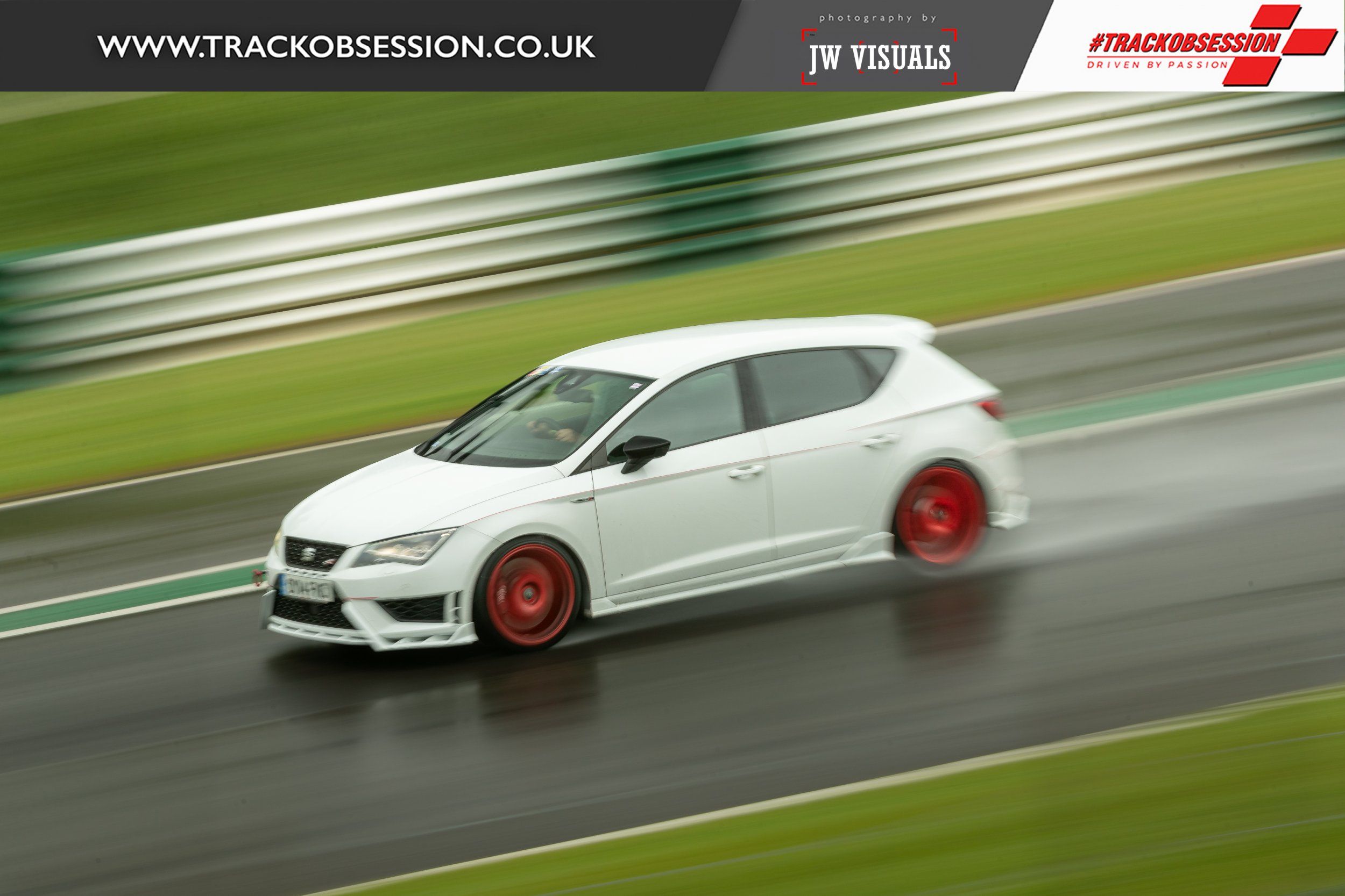

Took the old girl out on another track day at Cadwell this time the conditions were a bit spicy due to the lovely rain but I have to say the Continental Sport Contact 7 rubber lived up to its reviews. Handled the power very well in both light and very heavy rain.
Bit off putting when you get traction control light showing when doing a fair pace but was very happy when braking hard the tyres worked well.

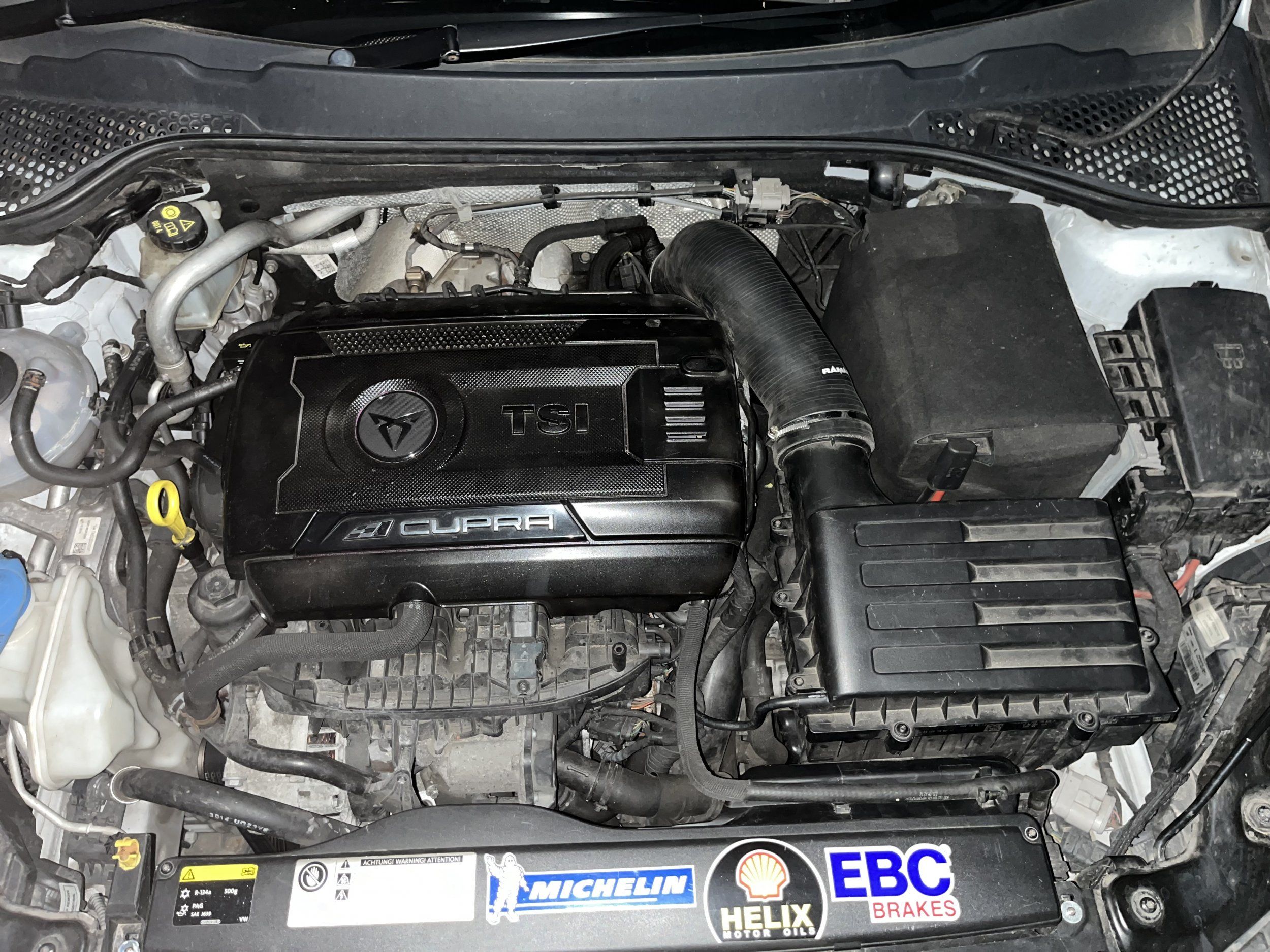

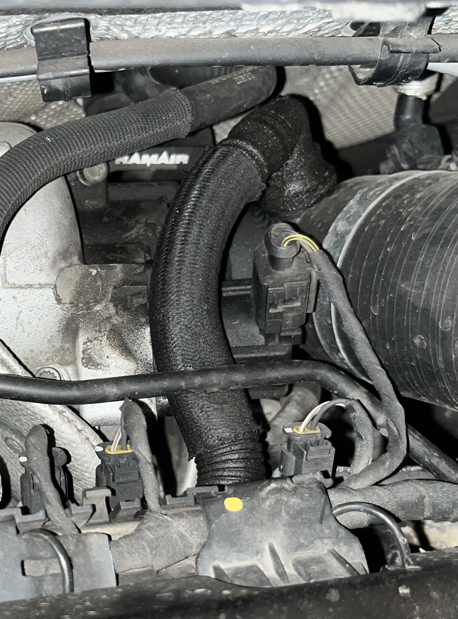

Swapped out the APR cone intake for the stock air box n filter, but without the snow grate underneath. And kept the Ramair hose and turbo elbow. Whilst doing this I also luckily noticed a fair bit of oil on the PCV breather hose, unfortunately, so will check that more closely tomorrow. May need to replace.

Some oil in the PCV breather hose engine EA888 engine.
This is normal inside the hose but not on the outside :). Perhaps check the fit of it or if you have a leak.

Update. PCV hose is covered in oil, seals look gone. Could be original hose from 2015. That will need replacing. There’s also a slight leak from the top of the timing chain cover. Will get mechanic to take it off n inspect gaskets, as I don’t know how to do that myself, and don’t have jack stands. Could be faulty PCV valve? Anyone got experience of this?

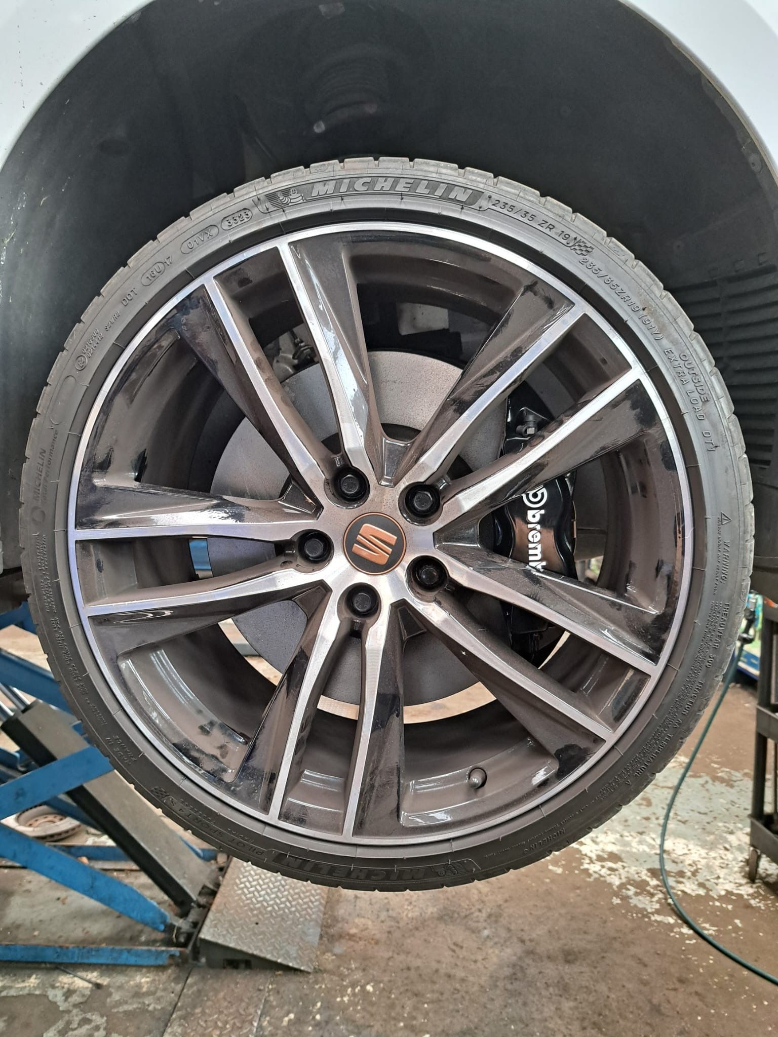

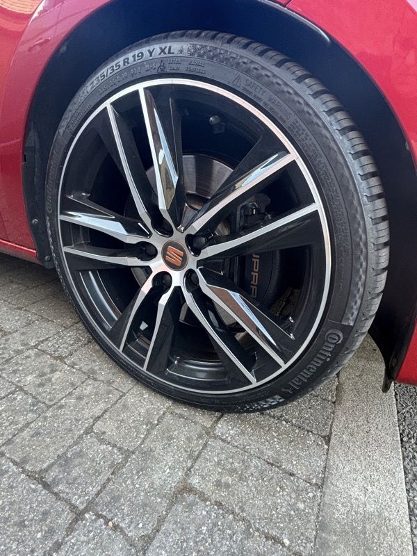

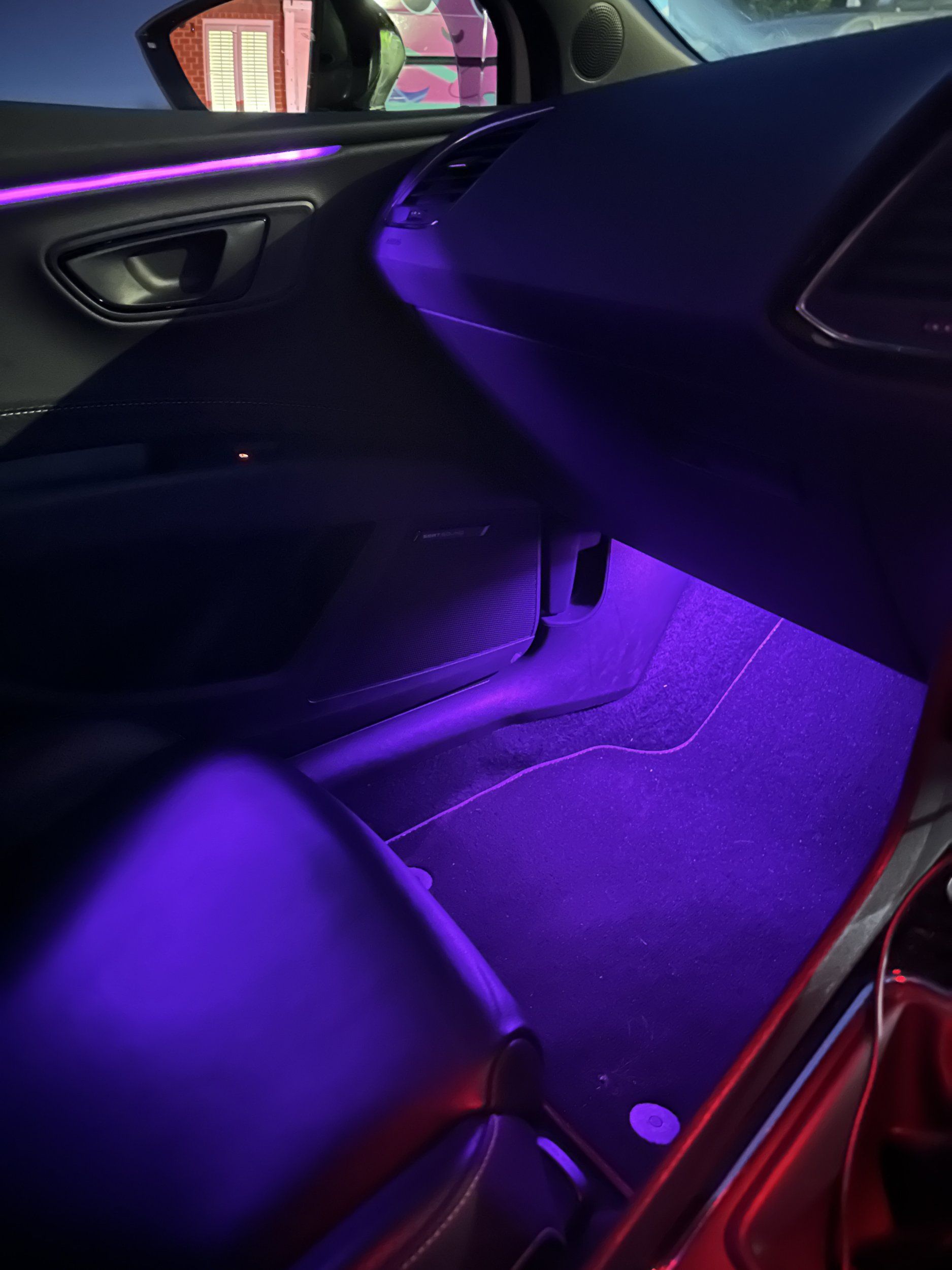

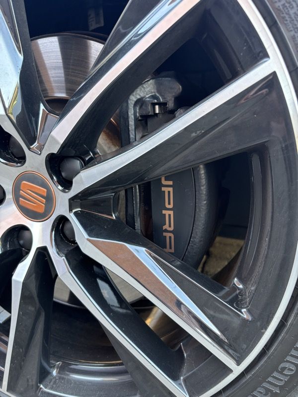

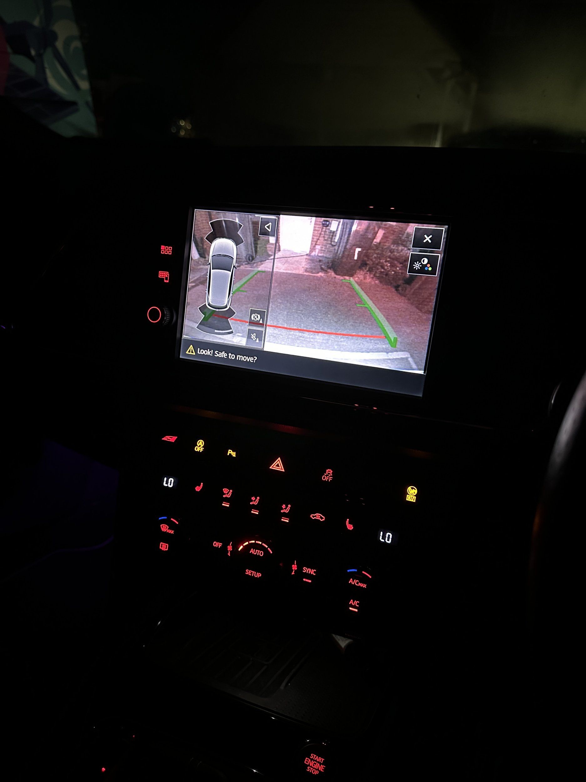

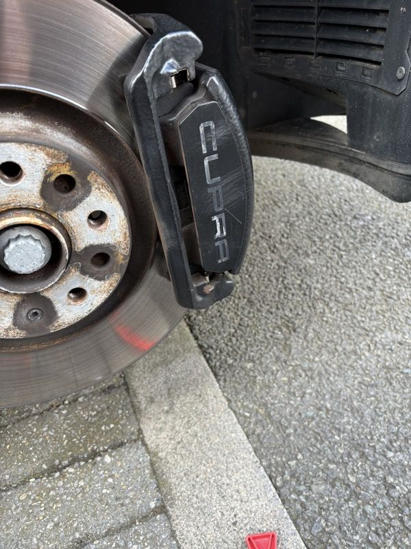

In the last month and a bit had my VBT Aston Martin Brembos fitted with 345mm Golf MK6 R discs. Also had TPMS, reverse camera and multicolour front and rear footwell lighting by @East Yorkshire Retrofits
