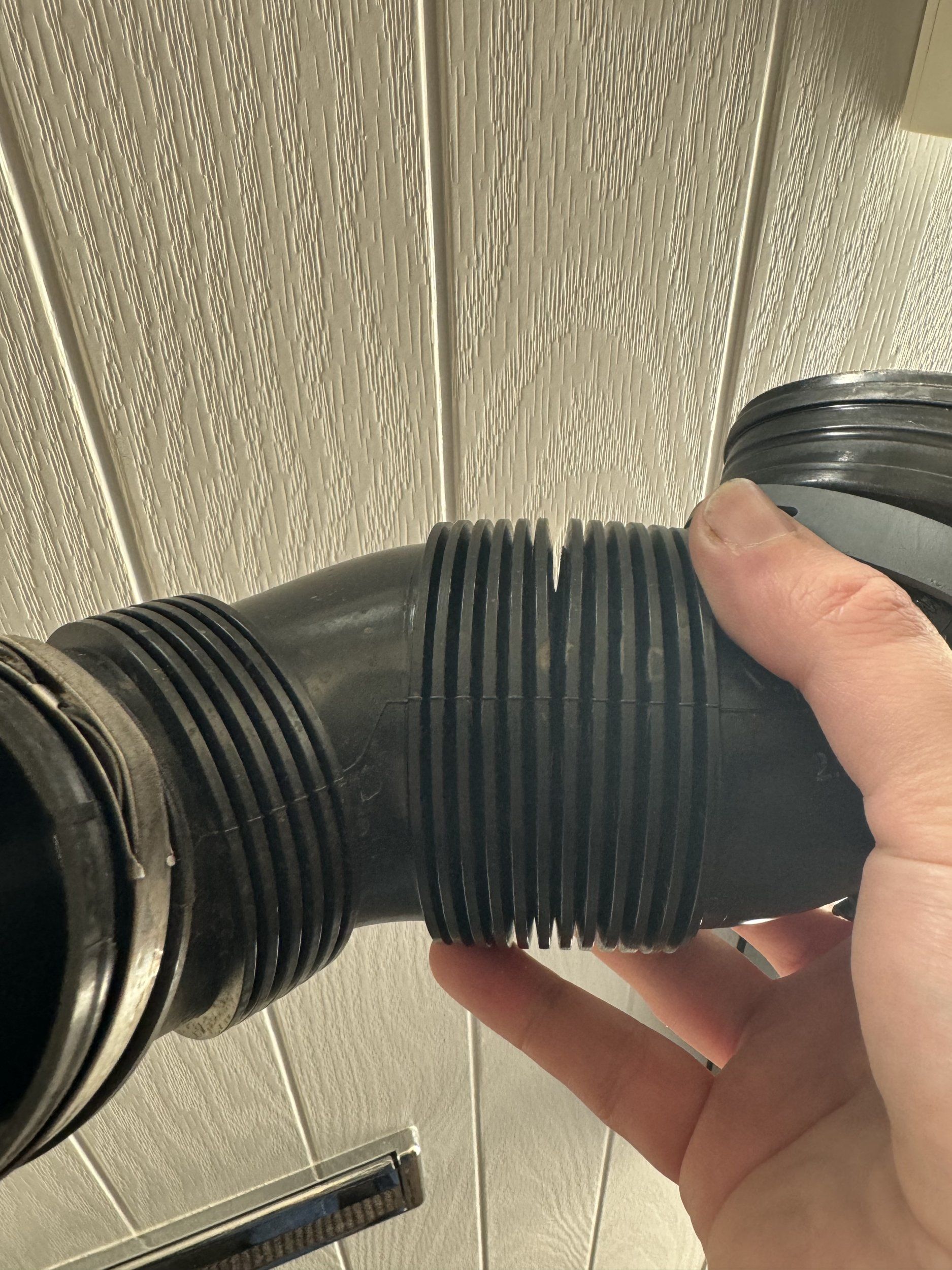

Couple of updates today!
My replacement turbo inlet pipe arrived from Darkside Developments, to replace the OEM pipe which had split on one of the joints (causing the MAF sensor to chuck the car into limp mode).
Installation was ridiculously easy - undo the clamp holding the OEM elbow to the MAF housing, undo the MAF sensor and remove vacuum pipe from the stock airbox, and simply pull the airbox out. Then with space now free to work in, undo the jubilee clip holding the OEM elbow to the turbo inlet (7mm socket if anyone ever reads this) - it then comes straight off
Knackered old OEM elbow:
Then in with the new silicone elbow! Quality is absolutely spot on, thicker than standard plastic yet flexible enough to make installing the airbox back into place an absolute doddle. Also significantly larger internal diameter, and smooth all the way through - I feel like this should automatically add a gazillion extra horsepower, but it certainly can’t hurt 😂
Added bonus is it looks awesome in situ as well. All tightened up and no more boost issues!

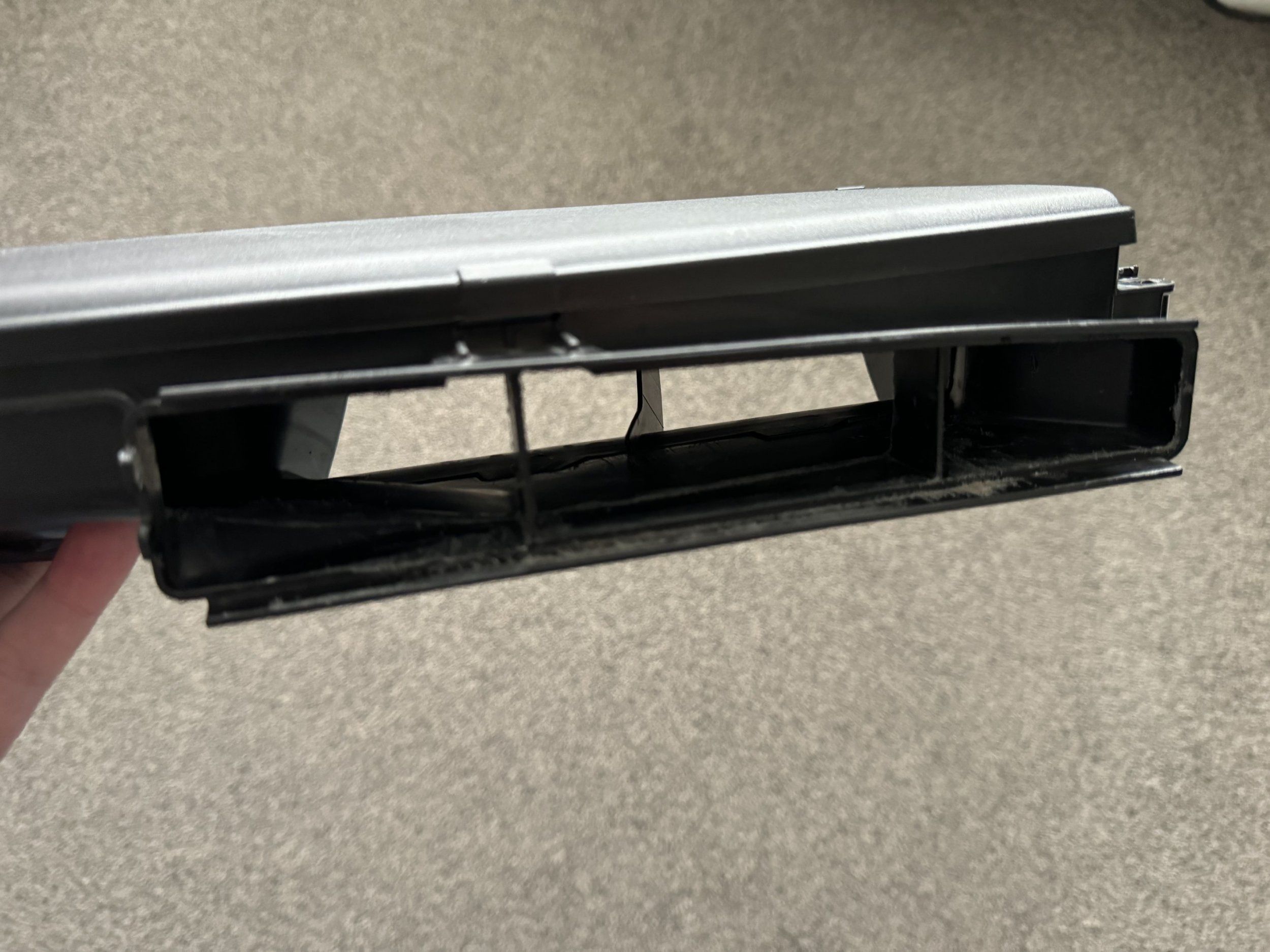

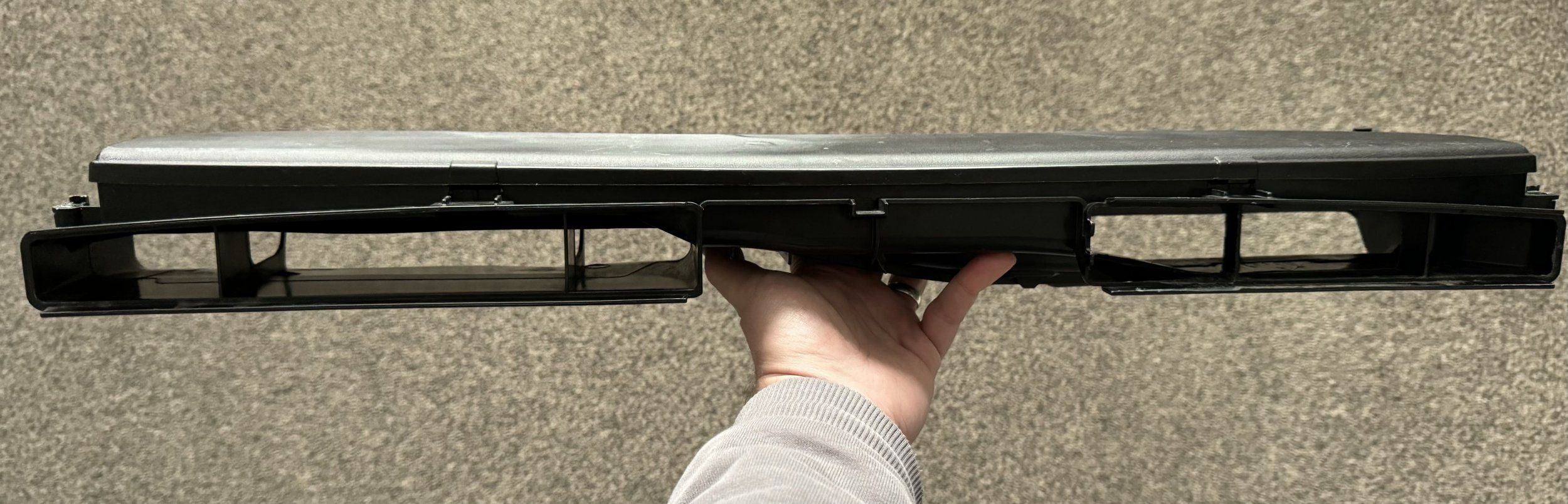

Part two - whilst I’d got the airbox out I took the opportunity to finally get around to removing the stock air duct, and doing the ‘pikey r600’ mod.
Is this necessary for diesels? No probably not. Did I want to do it anyway? Yes. Yes I did.
So out came the duct, and I took a dremel to it. End result turned out pretty nicely - sanded the cut edges back with a rasp, deburred with a sharp chisel. No feels completely smooth with absolutely no loose plastic or rough edges. I might paint it at some point just to hide the sanding marks, but that’s just OCD given it’s completely hidden when installed
Opened up
Airbox and engine bay no longer have to fight over cold air:
Between this and the silicone elbow, I’m now enjoying a small amount of extra turbo noise and a faintly audible (and satisfyingly childish) induction whoosh 😎🤣
