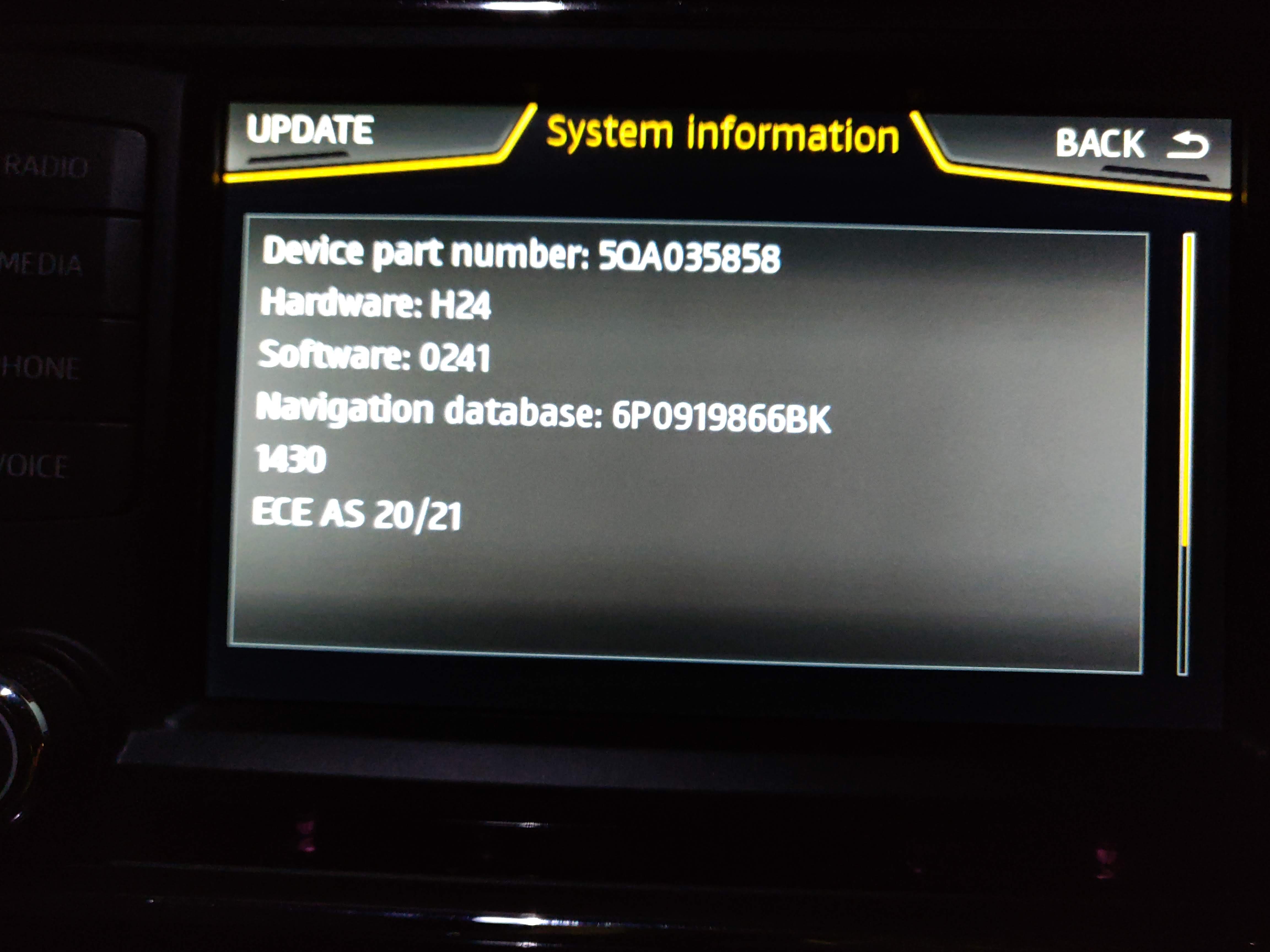

Thanks all.
Updated to 1430 for my Mib2, seems to work well.
Reactions: Tell
Suj999
Jul 28, 2019
20
Btw, what's this some of your cars seam to have SHIELD written on the software after version number??
