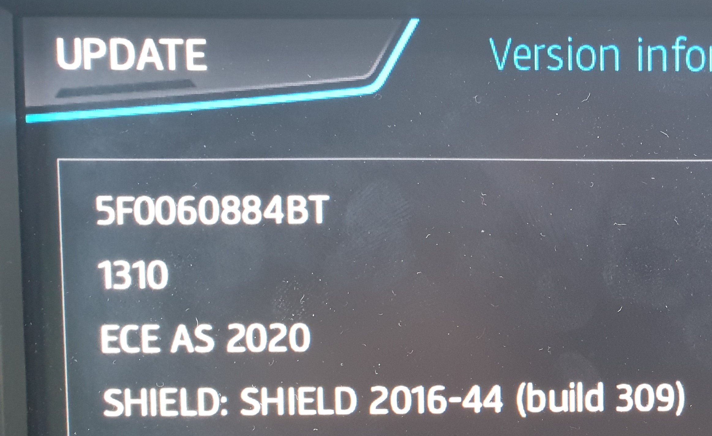

Thanks Tell and everyone for your help.
Reactions: Tell

Tell, I've finally got it to work
1/. Used the download 0915 file you recommended, put that onto my Seat sd card as instructed, worked fine, remembering to reset system first.
2/. Then formated same sd card and installed "Bundle 1" , changed OVERALL.NDS file for the one off the 0915 download and again reset system, which loaded up perfectly ! It still had my POI speed cameras remembered.
I think what had thrown me was moving the OVERALL.NDS file about, as it gets a new date stamp on the file which is the date its moved.
Can't thank you enough mate (and all the other helpful replies)
