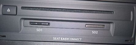

Thanks Tell
From a helpful reply to a previous post by me answered by you [page 82 no 1622] I had a MIB2 high.
This is my version. I hope.

That is indeed a Mib2 High. User @Titchy has also been asking me about retrofits on the messaging side. I see you both have the same hardware H54 and firmware 1219. Perhaps you should combine forces and ask that South London company. I did say to him check they enable TMC before they finish. Walone got his done before me and he sorted that out himself, needs toggling on via VCDS after the change, forewarned I got them to sort it.
Then get them to give you a tutorial in the map update process, basically back end menu easy enough, long menu press till you see the SWDL menu option (this menu is disabled by default), Start, keep the engine running for 60 mins, or off with door open, or open and close the door ever 15 minutes (way I do it). Takes about 40 mins but the unit has to be powered up continuously during this process, unlike the front end method you can't stop and start the process else you have to start again.
I should warn that anybody reading this that enables the developers menu without retrofit firmware installed will succeed in getting the maps in but it will lock you out till you restore the release the unit came with or before. Been there, done that, others have as well.
Lastly obviously all risks are on you which is why I thought about the conversion for a couple of months after Walone had his done. They may upgrade your firmware release version in the process, you are on 1219 or may say at this time it can't be done.
