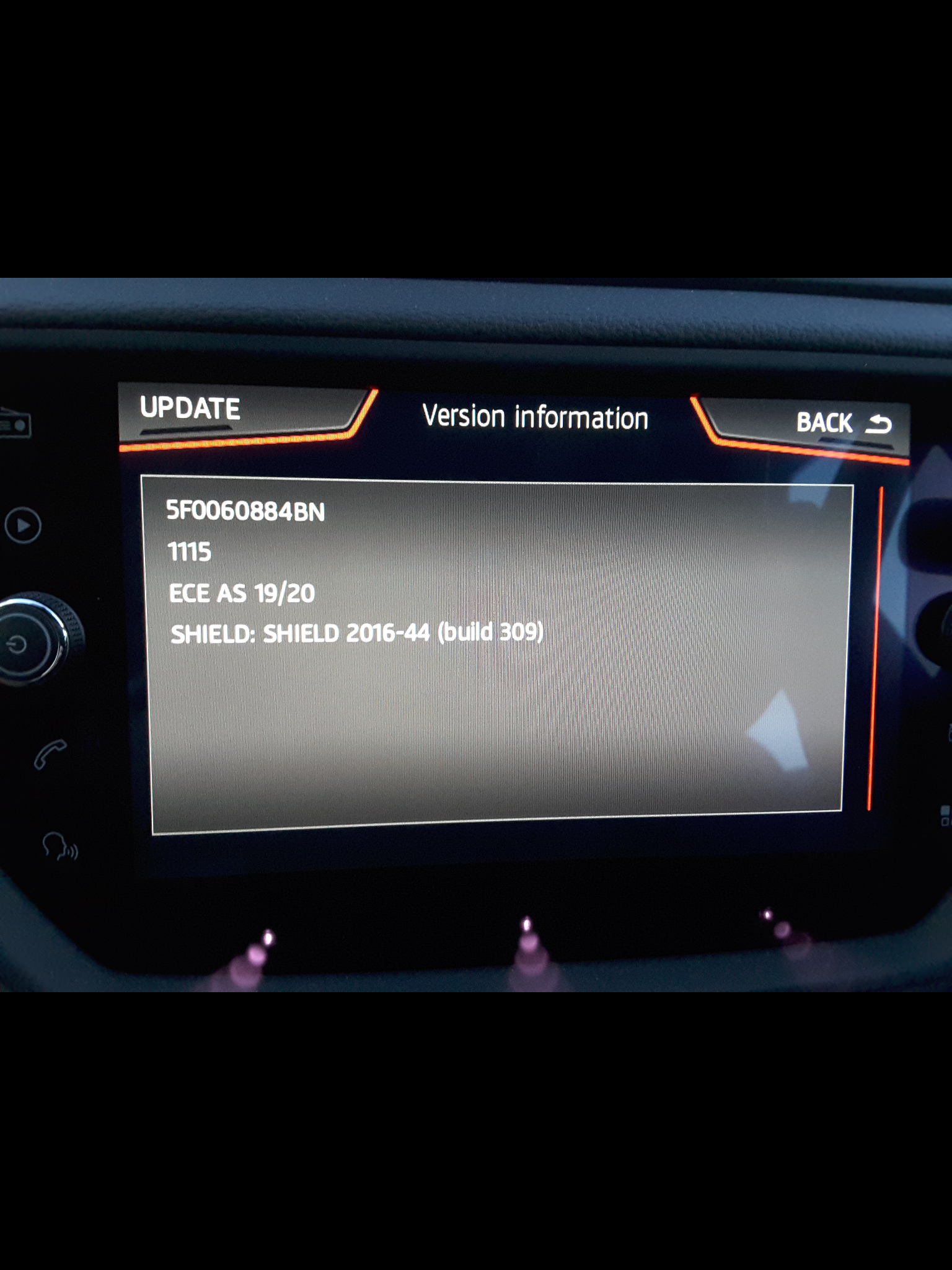

I'd use that, it won't say 6P on it but it didn't through up errorsView attachment 4781
I'll give it a download tonight and try again tomorrow

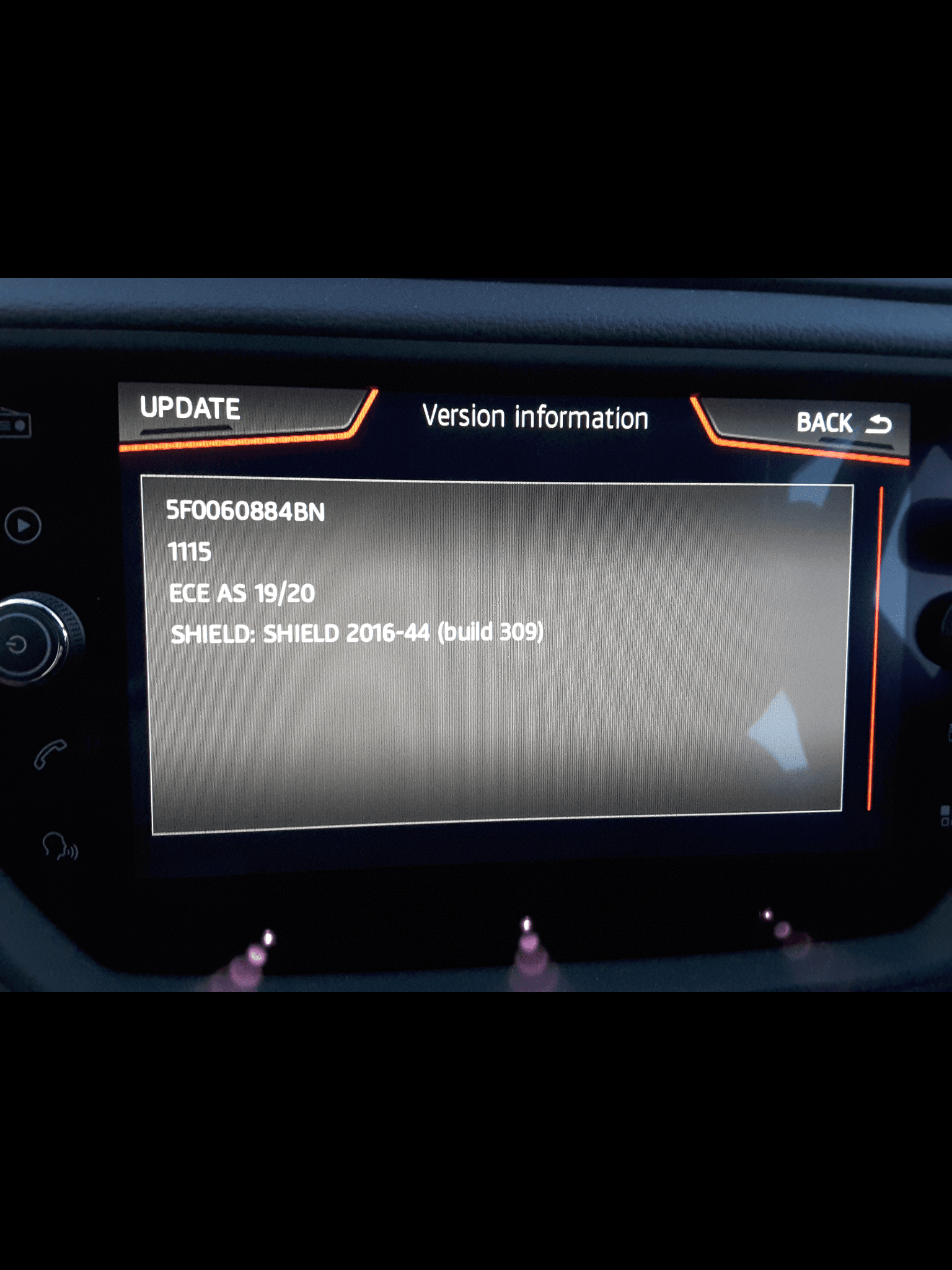

Uploaded these today and all working fine!
What is the actual difference between the 6P and 5F versions?
Normally the VW and Skoda releases are identical to the Seat release. Byte by byte they are the same, it just shows a different code when put it into a specific VAG subsidiary car. European boards identified that a number of years back. It was on here that I said don't wait for a Seat release use a Skoda or VW one having read they were all the same release.
I think what happened this time was that the whole of European release was rushed out after VW users had complained about the release being in five parts. It came a month or so after the other with a German board noting the year code wasn't completed correctly. Should read 2019/20 rather than 19/20. Manufacture date is put at the others releases although that could be doctored in the production of the release. The release is on the official VW site although I did give the server link but either way it's an official release put out after the others.
Since it was rushed out I suspect they didn't check that when it was put in Seats it would show the 6P code or a decision was made they were only releasing this for VW and didn't put the Seat part code in. I known one poster changed this themselves although it's only presentational.
Basically that is why I reckon it appears as it does but least gives you the whole of Europe like the previous release.
