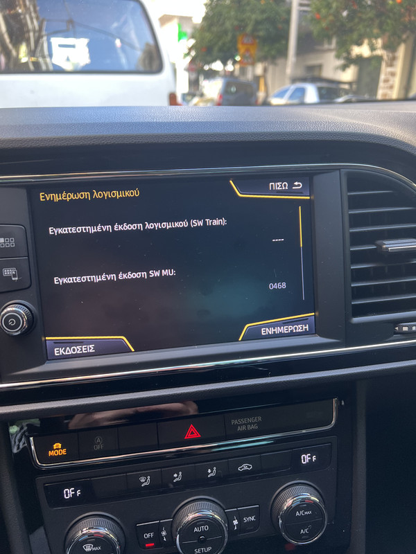

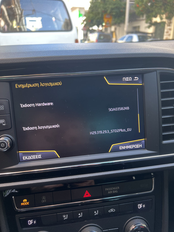

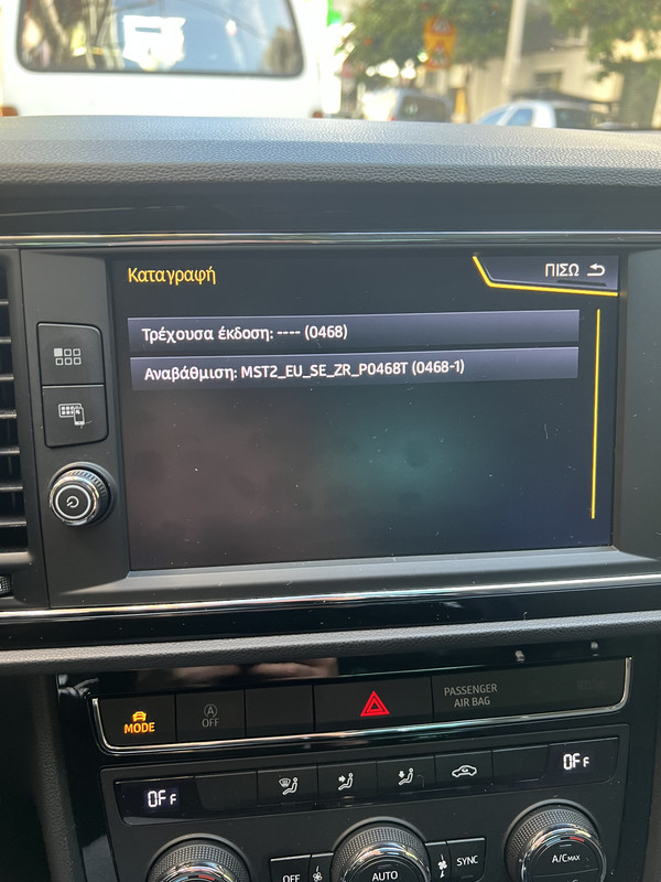

image for uploads
This is my version. Which is the latest software for my infotainment? Also what about coding, adaptations and full link (CarPlay, AA) after updating?
Possibly 479T... see what other people say. You keep within the stream, you are on the 4 series. That's the last one shown on the link above. You keep whatever you had before as far as CarPlay, AA, map navigation.
Have a read around the thread. Will reboot a few times during a firmware update. You are suppose to keep a battery charger plugged in during the process but you can get away with the engine running. Loss of power during the update can / will compromise the unit.
