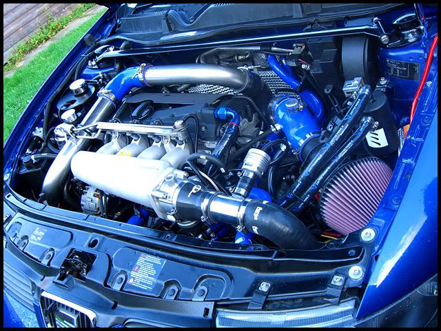

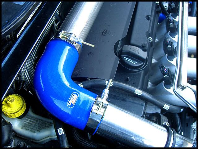

Finally got the intercooler pipework just how I want it, I had to cut one pipe and create a new bead and all the silicone hoses on the hotside are all now high temperature nomex and aramid reinforced. I managed to remove one more join too so it all neat and tidy now, I used t-bolt clamps too.
http://i312.photobucket.com/albums/ll330/SonicBlueLeon/nov001.jpg
http://i312.photobucket.com/albums/ll330/SonicBlueLeon/nov002.jpg
http://i312.photobucket.com/albums/ll330/SonicBlueLeon/nov003.jpg
Samco Xtreme hoses and stainless t-bolt clamps:
http://i312.photobucket.com/albums/ll330/SonicBlueLeon/nov004.jpg
Yes I am running a Collins twin-piston BOV, after running some A/F and fuelling logs it makes zero difference, all I had to do was back off CH03 in Unisettings slightly and that's it, sounds awesome and no problems! :D

Looks even more awesome, Rob. How did you do the beads on the charge pipe?
Master cylinder looks scruffy and I would swivel the clamps so the bolt is under the pipe, myself... (sorry, I can't help it)
RobDon
Pro Detailer
I used some instant/quick steel putty stuff, made a bead on the pipe, cures in 10 mins and is as hard as steel. Seems to have worked as they're not moving, the big clamps help too.
I *might* move the clamps round! ;)
Oh and this winter I am considering removing my headliner and covering it with black alcantara/suede ... something I've wanted to do for a long time ... watch this space. :D

Mmm agreed the bolts need turning around, possibly make the bolts shorter too.
