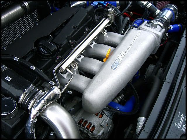

Looks spot on Rob, just keeps getting better.
Your tap in points in the charge pipe for your Apexi are they the revotec ones? I'm needing something similar for my DIY intake pipe.

Looks almost perfect, Rob.
I say almost - have you thought about running the vac lines and injector wiring under the inlet manifold?
Edit: Sorry, Reading it back, it seems a bit rude. Wasn't meant that way.
Not sure what DV that is, but if you could reverse it, you could bring the vac line around under the inlet manifold, under the TIP and in up the back? Just a thought.

I think lengthening them would be best, but I saw something on "Beetle Crisis" that might work, some of that woven-fabric-ish sleeving and a length of wire (stainless/alloy) rod so you can make the wiring run precisely where you want it, bending it to suit.
A nice straight run of wiring with radiused bends would look loads better.
Mind you, probably have to chop the plugs off to do it, so might as well just lengthen the wires :D

I was going to comment about the braided vac lines before, I definitely think it looks better in normal hosing.
gellideg
thats a really tidy engine you have there ! Did you buy that coilpack heatsheild or is that somthing you made ! and does that sem Manifold still have all the vacum stuff still bolted to the underside of it
Have a look in the INA Engineering section on here, he sels them and they are quite cheep.

Silver powder coat on the charge pipe would match the inlet, I think, but would it look too much like the LCR/TT charge pipe? Black wrinkle finish, maybe? Might be too much black then...
Yes all the connections are on the underside, Don designed it that way for a clean look.
Nothing new to report, I have upped the boost to 1.5 BAR, the turbo can take it since the rebuild, wastegate duty cycle is only 45% which means the turbo isn't trying very hard to make boost - good stuff! :D Car pulls hard and feels great on the road.
