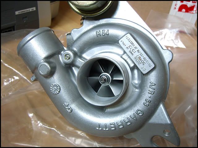

Looks new:
http://i312.photobucket.com/albums/ll330/SonicBlueLeon/cr2.jpg

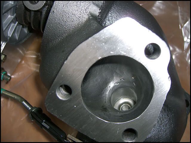

Smoothed out inside:
http://i312.photobucket.com/albums/ll330/SonicBlueLeon/cr3.jpg

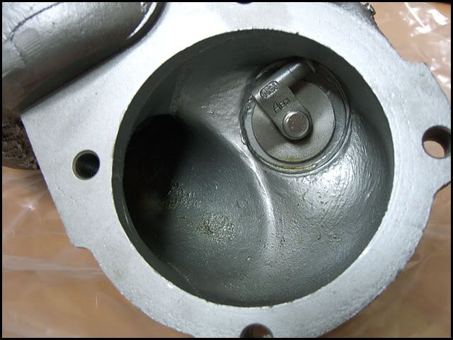

And here:
http://i312.photobucket.com/albums/ll330/SonicBlueLeon/cr4.jpg
Actuator arm link welded for hard link, better control?
http://i312.photobucket.com/albums/ll330/SonicBlueLeon/cr5.jpg

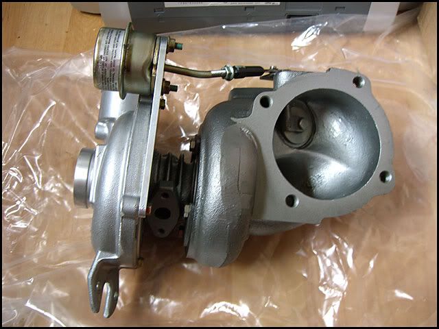

Garrett turbo:
http://i312.photobucket.com/albums/ll330/SonicBlueLeon/cr6.jpg

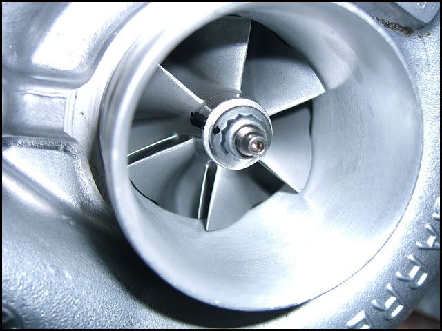

New, larger compressor wheel and machined out inlet:
http://i312.photobucket.com/albums/ll330/SonicBlueLeon/cr7.jpg

Overall CR Turbos have done a great job, they're easy to deal with yet very knowledgeable and professional, keen to help and a fast tunraround. Top-notch company!!!
