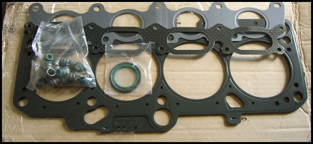

Some more stuff arrived today, mainly head gasket etc. (new stem seals were in the kit too - my god they are tiny!), all genuine VAG:
http://i312.photobucket.com/albums/ll330/SonicBlueLeon/headparts1.jpg

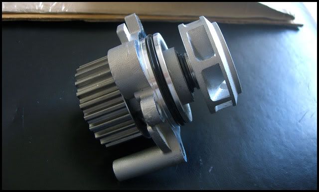

New water pump with metal impeller:
http://i312.photobucket.com/albums/ll330/SonicBlueLeon/headparts2.jpg
